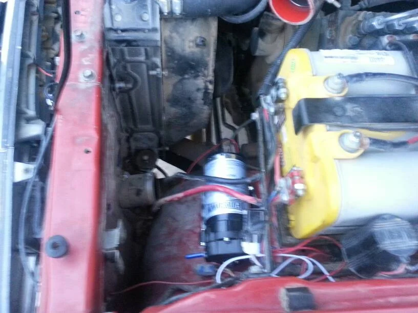

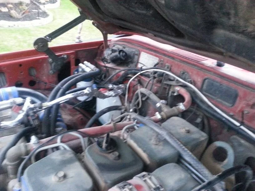

I didn't have much sunlight left in the day, but i managed to relocate the windshield washer fluid tank and find a place for the methanol pump. I also found a spot for the methanol tank.
In my rush to beat darkness i didn't take good pictures. Tomorrow i hope to wire and hook up the hoses.
New washer fluid location
Pump location
Meth bottle location
The weather has me down. It's been raining all day and now that it stopped it's too dark to work on it. I managed to find the fitting I broke for the pressure switch. not much else to update. I just need to finish up the wiring. There's 3 nozzles a 5 GPH, a 10 GPH and a 14 GPH. I've installed the 5 for now and will work my way up to find what's the sweet spot.

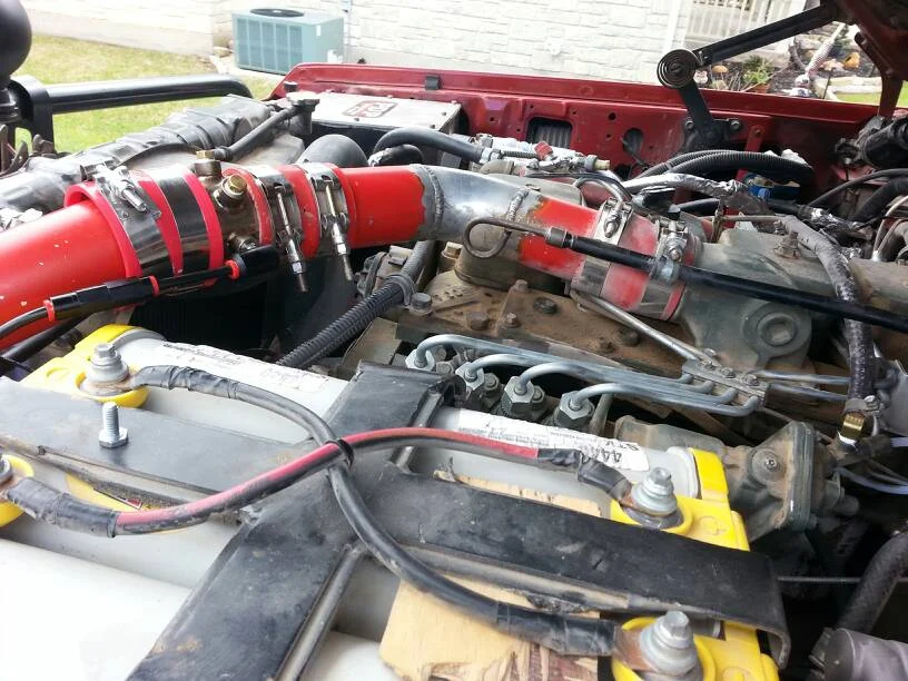

Got all the hardware installed. Had to move a few things around. I needed another 2.5 in silicone coupler but only had a 3in. I added two reducers for now. It looks a bit ghetto but it will work. I'm debating whether to eliminate the valve that goes to the waste gate, but will defer to the opinions of more experienced guys. I just need to finish wiring it and it's ready. Time for lunch.
Thinking of plugging this.
What it will look like. Just needs wiring.
I'll tuck the wires better so it's not so ghetto and exposed.
Dude that battery mount is ridiculous.
I found running more pressure versus bigger nozzles worked better. The higher pressure helps "vaporize" the fluid which yielded cooler temps. I also had a solenoid close to the nozzle to make sure that fluid (drops) wasn't pulled at idle.
Yeah I'm gonna start with the smaller nozzle and work my way up. I don't think i can adjust the pressure. The pump goes up to 300 psi.
I hope you mean ridiculous in a good way:) It was the only way we could fit two batteries in there.
Mike, you mention that you are thinking of blocking off the blow-off valve sense tube. At what pressure is it now opening at?
I blocked it off for now. Can't really tell a difference yet,, but then again I haven't driven it. It opens up at around 18psi.
Yeah, looks like you can stand to keep it closed. Can you install a boost elbow instead? That way you can keep the wastegate feature, but tune it to open at a higher psi.
Thats the piece I broke off. Couldn't find a replacement so I just plugged it. Some guys here are running 30 to 40 psi, so I figured it couldn't hurt to not use a wastegate.
