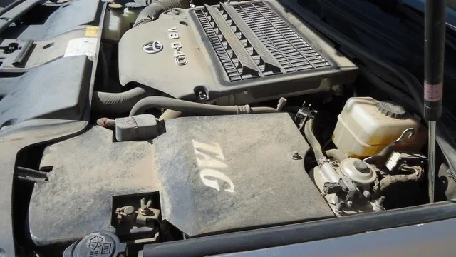

This last one is of the 200 series LC with the V8 turbo diesel D-4D engine. This engine is a power house and we have not yet broken down on us yet. All our suburbans have broken down or overheated or had some kind of issue. This is one comfortable ride. It's B6 ballistic armor and can still haul it when we need it to. I'm waiting for more pics of Big Red from the US, once I get them I will be sure to post them. In the meanwhile I hope you guys enjoy these pics.
sorry can't see much of the engine the inner cooler covers most of it.

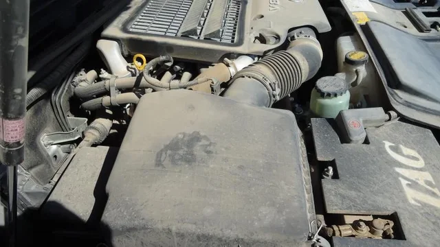

here are 3 more pics I found of the 200 series diesel. You can't see much because of the inter cooler, but it's better than nothing. I love this engine, wish Toyota would bring it to the US.

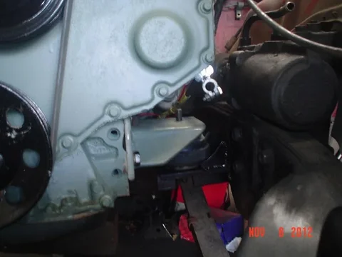

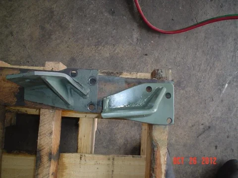

First off, happy veteran's day to everyone who served. Sorry for the slow postings and updates, I was in Kuwait last week and got back to Baghdad to a full work schedule. Here's the update for the 3 guys who are following. Motor mounts were made out of 3/8" steel with gussets for reinforcement. The engine sits on it nicely. Let me know your opinions.

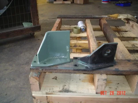

Two more pictures. The hoist can be seen, but it's not holding it up. There's a jack under the engine keeping it from falling back. I'm hoping that next week the tranny and the rest of the drive train gets put back in. It's slowly but surely coming alive.

Looks good the whole way around. I like how he bent the steel to make the mounts. It looks like the engine is sitting level and will have plenty of clearance with the hood. It also looks a little off center toward the drivers side, which is good to get a littel more clearance with your third member. I'm glad to see that you went with the liquid filled engine mounts. I'm going to have to re-fabricate so I can get the ones I have in. The vibration is not really terrible, but everything in the rear view mirror is going in circles at 2000 RPMs.

I'm pretty positive that those are just the factory front mount 4BT motor mounts, used in chevy transmission applications. I had a set that came with my motor.
