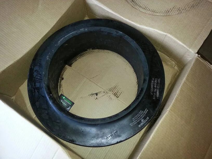

5 of these just arrived. Now I need to figure out who will mount them.

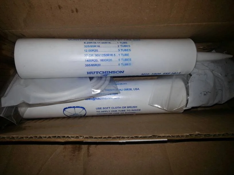

This just came in, slowly all the parts are coming in. There's two tubes in a pack and I got 5 packs, so I'll have enough for the next set of tires as well. Hoping to pick up an extra tire this Friday And get started on putting the run flats in :eek:.

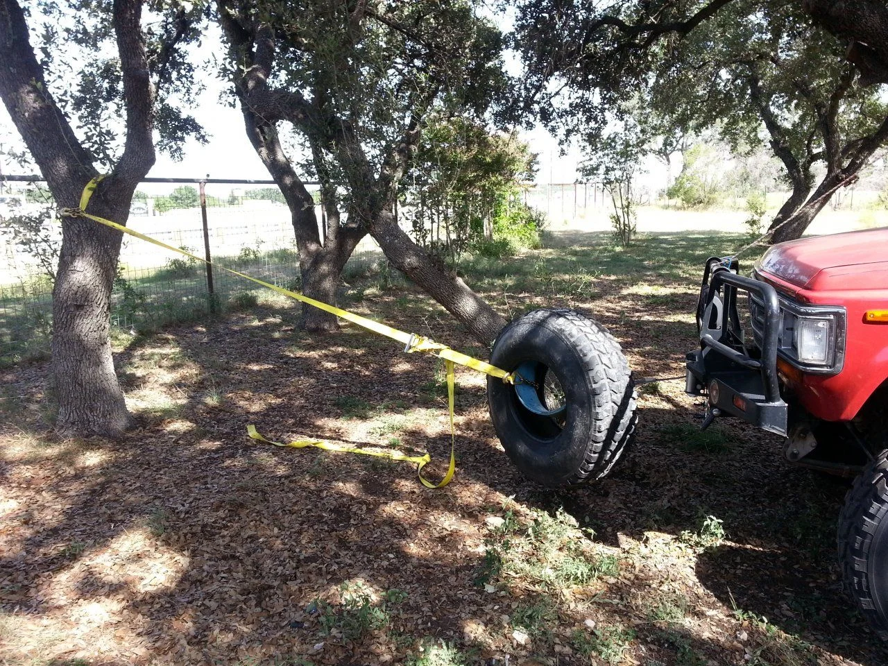

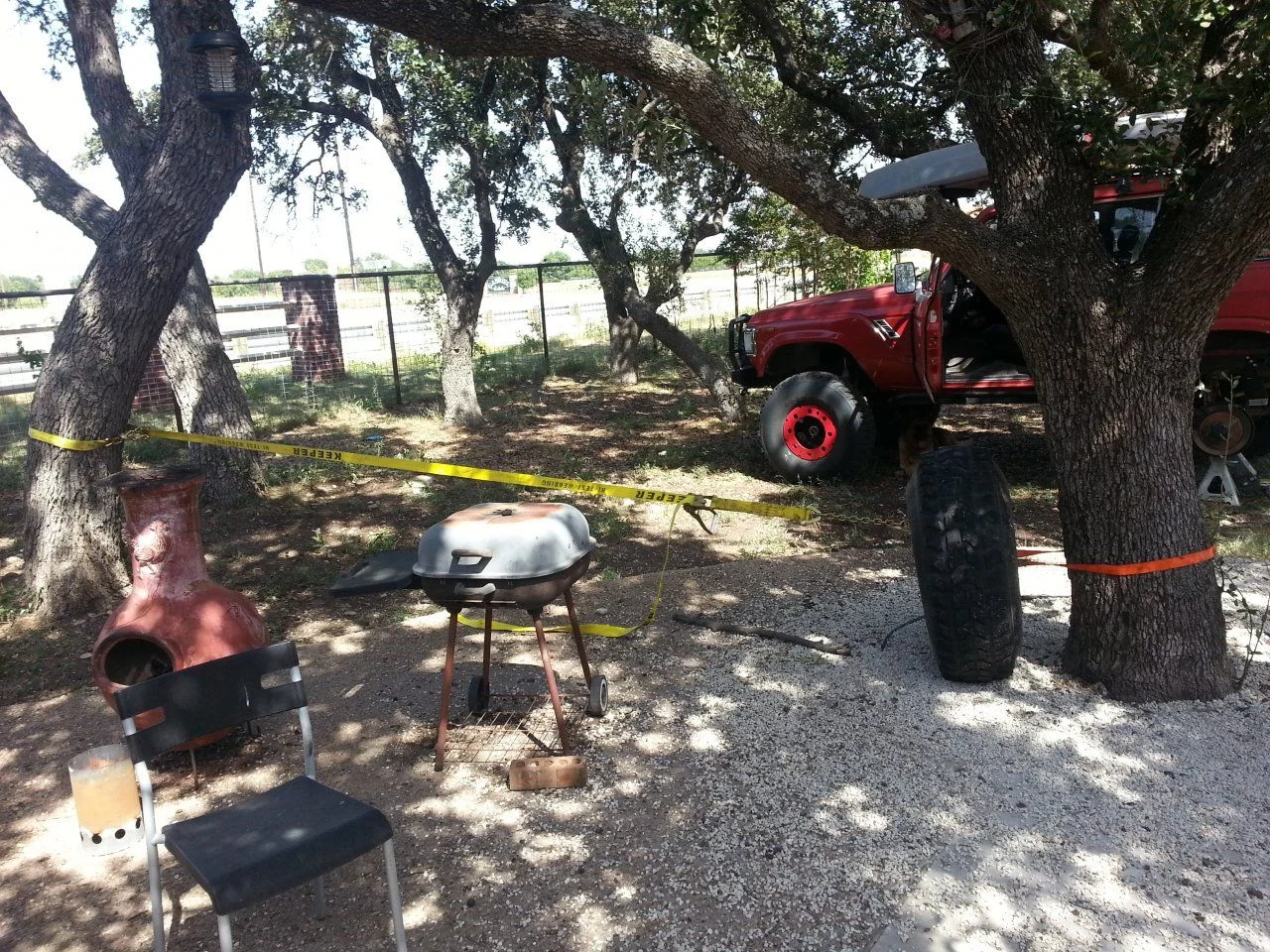

Had a little exercise in futility this weekend. I decided to take off the tires, split the rims open and insert the runflats. Before doing this I went to pick up a spare Wrangler MT tire from a military surplus store. I ended up wasting my time driving there as their definition of 90% was not the same as mine. When I got home I figured it was time get started. I took off the first tire, deflated it and unbolted the rim. The rim was not separating from the tire so I used two ratchet straps, two oak trees and some beer to help me.

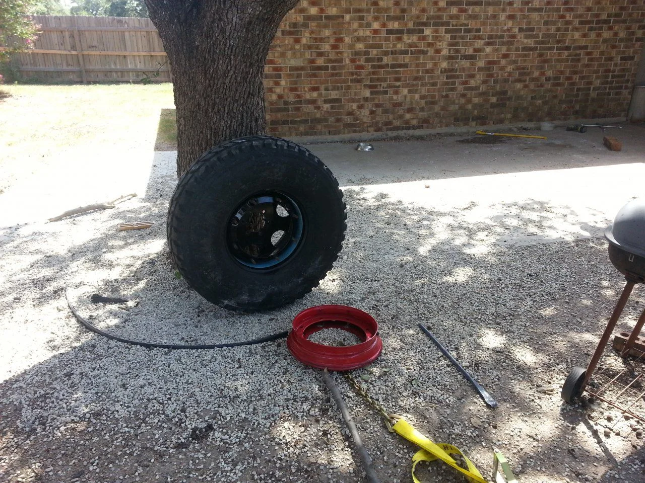

After splitting and separating the wheel from the tire, I had to get the PVC insert out. I used the truck winch to do this since one of the ratchet straps wasn't long enough to loop.

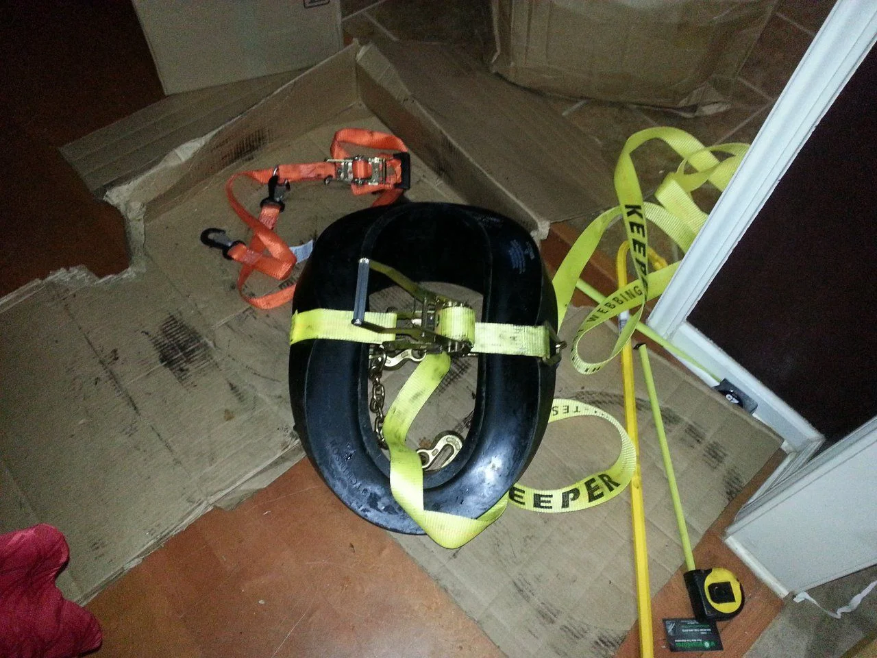

Once I had everything separated, it was time to get the run flat in. So I used a 10000lbs ratchet to cinch it down as much as I could, then lubing the bead and outer edge of the runflats.
Getting the runflat in the tire was an ordeal I wasn't ready for and you shouldn't attempt unless you have help. I managed to get about 80% of it in before I took a break. I had to stop for a bit because of severe pain in my arms and knees from previous injuries.
