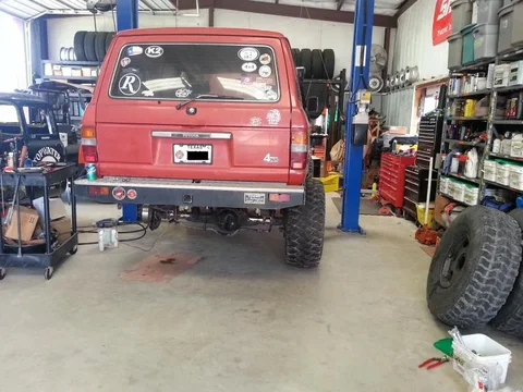

James sent me this mock up of what the wheel base would look like. I think it will look even better with the creepy crawlers on, assuming they clear the calipers with the spacers.
That looks WIDE! I like the look. Are they bolted up or just wedged up against the axle? I don't think you will have to worry about rolling over with that stance..
They are bolted because it's off the lift. Now I need wider fronts.
Didn't even notice that.. Are you going to just run thicker spacers or are you thinking about running a wider axle up front?
The re-entered h1s will clear the calipers without the spacers, no problem. It's the creepies on 15s you'll have to worry about.
I know, it's the creepys I was worried about. James said it won't be a problem,I'm heading back out there tomorrow to finish this up.
Right now I'm broke so the front will stay the way it is. With time we'll see what happens

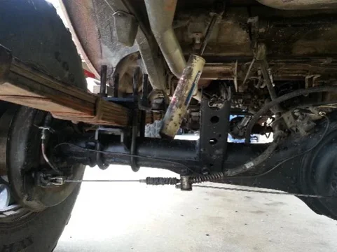

Finished up the axle swap today. Drove it around on dirt roads and on the highway at almost 70mph. This thing stops on a dime now. The disk brakes and the upgraded master cylinder are worth it. I decided that since the LSPV when fully open gives you a 60 front 40 rear split to just zip tie it open. If it locks up then I'll put a bracket on and figure it out. So far so good.
this is what it looks like with my humvee tires and spacers, way too wide for my liking, so I'll take the spacers off when I use these tires.
This is with the creepy crawlers. I like this look better and will be changing out the tires this week.
As you can see, it clears the calipers.
the bigger master cylinder
No the final product, but I bent the brake line by hand.
Overall the rear looks like it came from the factory when it was painted and buttoned up. I'm pleased with how it turned out and how it handles. James welded a bead on the front hanger where it was a bit loose. I need to keep retightening the U bolts until they seat completely. Will be changing out the gear lube after round up because of all the grinding and banging we did.

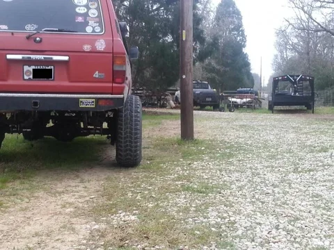

This is the final product. I took these pictures after trying it on a dirt road
I think it looks clean and I'm definitely happy with the upgrade. More people should consider this. Of course none of this would be possible without the help of good friends and experts in this forum. Thanks for the encouragement and support.
