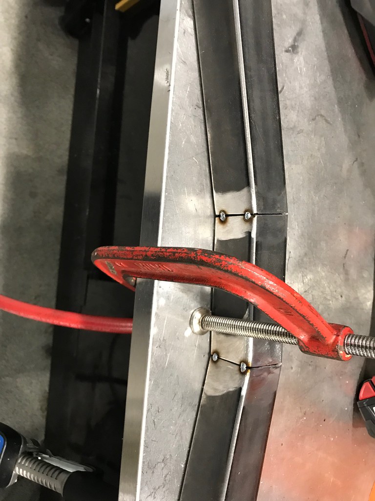

what kind of details are you looking for? ill do my best to explain. i couldnt find find a bumper that i really liked in the aftermarket, 4x4 labs was the closest match, but still not exactly what wanted. so i bought the hinge/spindle, latch, spring loaded pin thing, hitch receiver, and a small pile of steel from a local metal supermarket and started building. i let the truck dictate the angles and the height. i wanted ultra simple and very tight to the body so thats what i built.

oh i have no idea what the measurements are, i didnt really "measure" anything.. the main rear 2x4 i eyeballed the width and added a couple extra inches on each side of the truck, then i tack welded to the mounts i made. i eyeballed the 2x2 forward bars and tacked one on and cut and moved and modified it until i liked it, then made a second one to match for the other side. once i had them where i wanted them i heavily tacked them in place. i cut the 2x4 to match the width of the 2x2. you can measure all you want, but sometimes you just have to start cutting/welding and make stuff. i suggest you look carefully at all the bumper pics, specifically where i cut the frame and the mounts i made. just start fabricating out of heavy poster board(walmart) buy a couple sheets and pretend its metal, cut big and trim down a little at a time, then transfer your new template to steel and boom, your fabricating. dont be afraid to make something that sucks, just learn from that and the next thing you build will be that much better. start by making some thing small and simple.. ill get some actual measurements for you tomorrow to get you in the neighborhood.

My only offering is that the rear bumper, being so tight with the body, you may need to stiffen the vertical spare mount. Deflections while offroading or even on a wavy paved highway may cause interference. Just keep an eye out I guess!
Yeah gusset that tire carrier more to stiffen it up. With a heavy 37 up that high it’s gonna be wobbling at least a little especially off-road.

You beat me to it.... gussets on either side of the main pedestal angled rear bottom to forward facing edge of pedestal at the top of the gusset maybe 8” high.
thanks for all the input guys. i do plan on beefing up the carrier, i havent had much time to work on it the last week or so. i may cut off the top, above the 45* 1x1, and redesign from there up, im not totally happy with it as it is right now.
