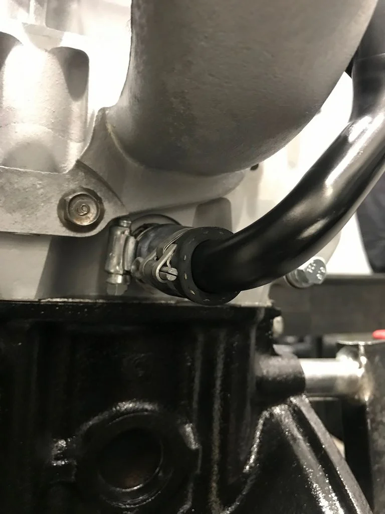

Is there a reason why you went with the factory style clamp vs a constant torque clamp like "BREEZE"? I think the breeze constant torque clamps are a little bulky on small hoses like the PHH.
