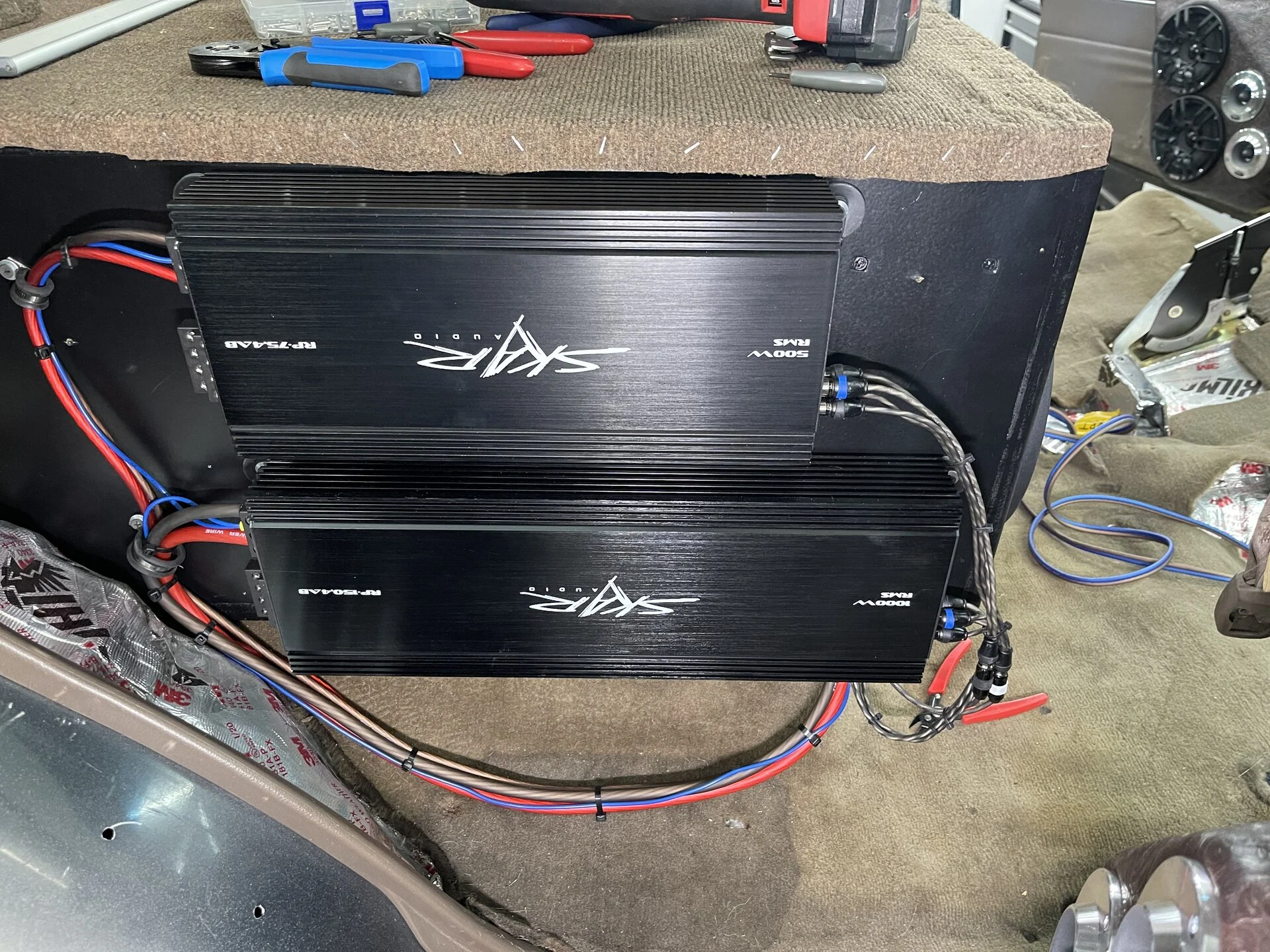

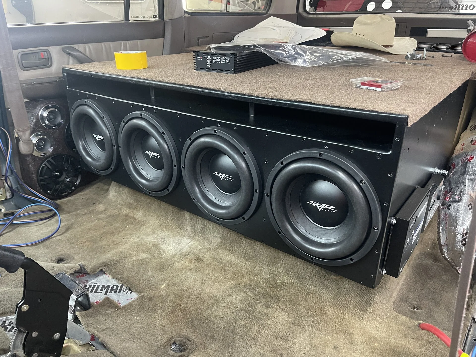

Im ordering 2 XS Power group 34 AGMs, thats about 250 amp hours between them, good for about 2500 watts. I already have a Power Bastard 220a alternator waiting for install. So thats 220amps minus 50 to run the truck, so 170 dedicated to accessories, 1amp/1amp hour=10watts. The math adds up to a charging system that is capable of about 4200watts. Im running 2700watts worth of amps to start with. Ill have space for a third battery if i really need it. I may put a much bigger amp on the subs, thats unlikely, but not impossible ;)

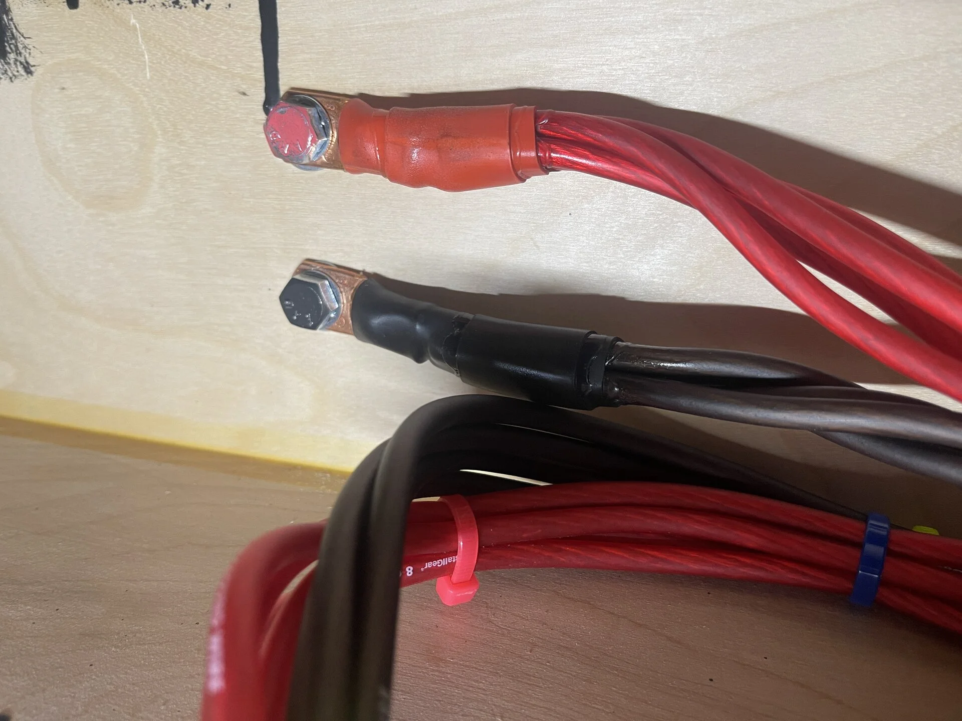

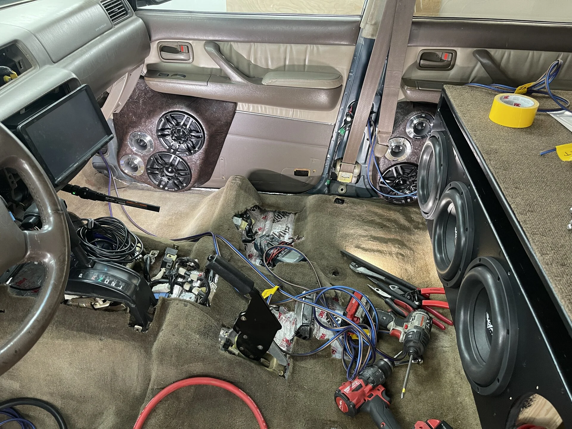

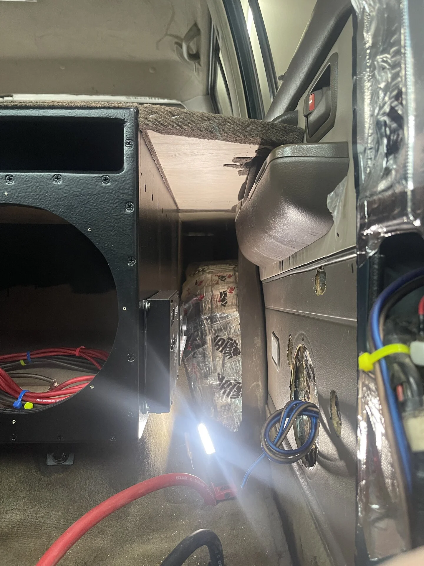

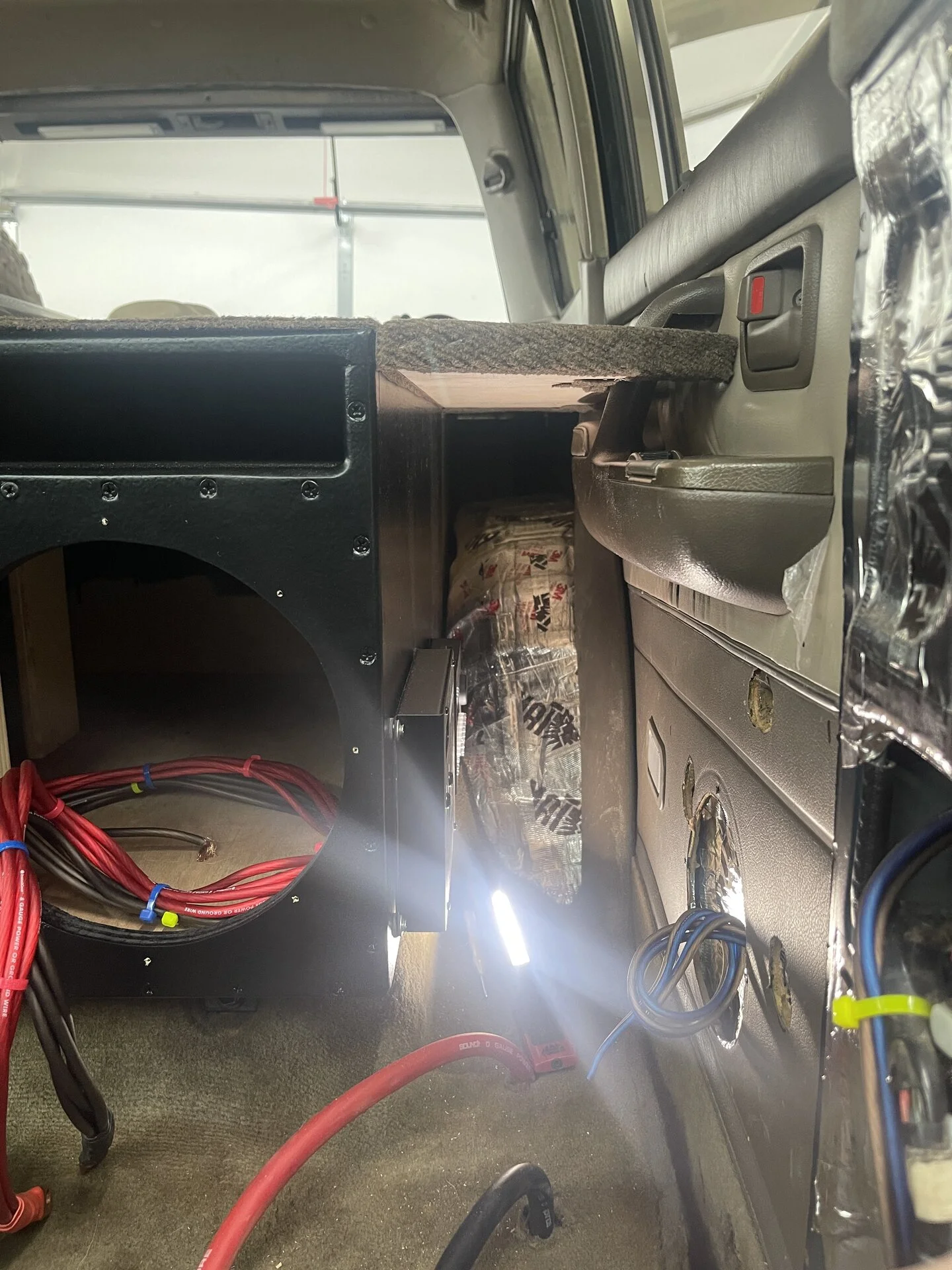

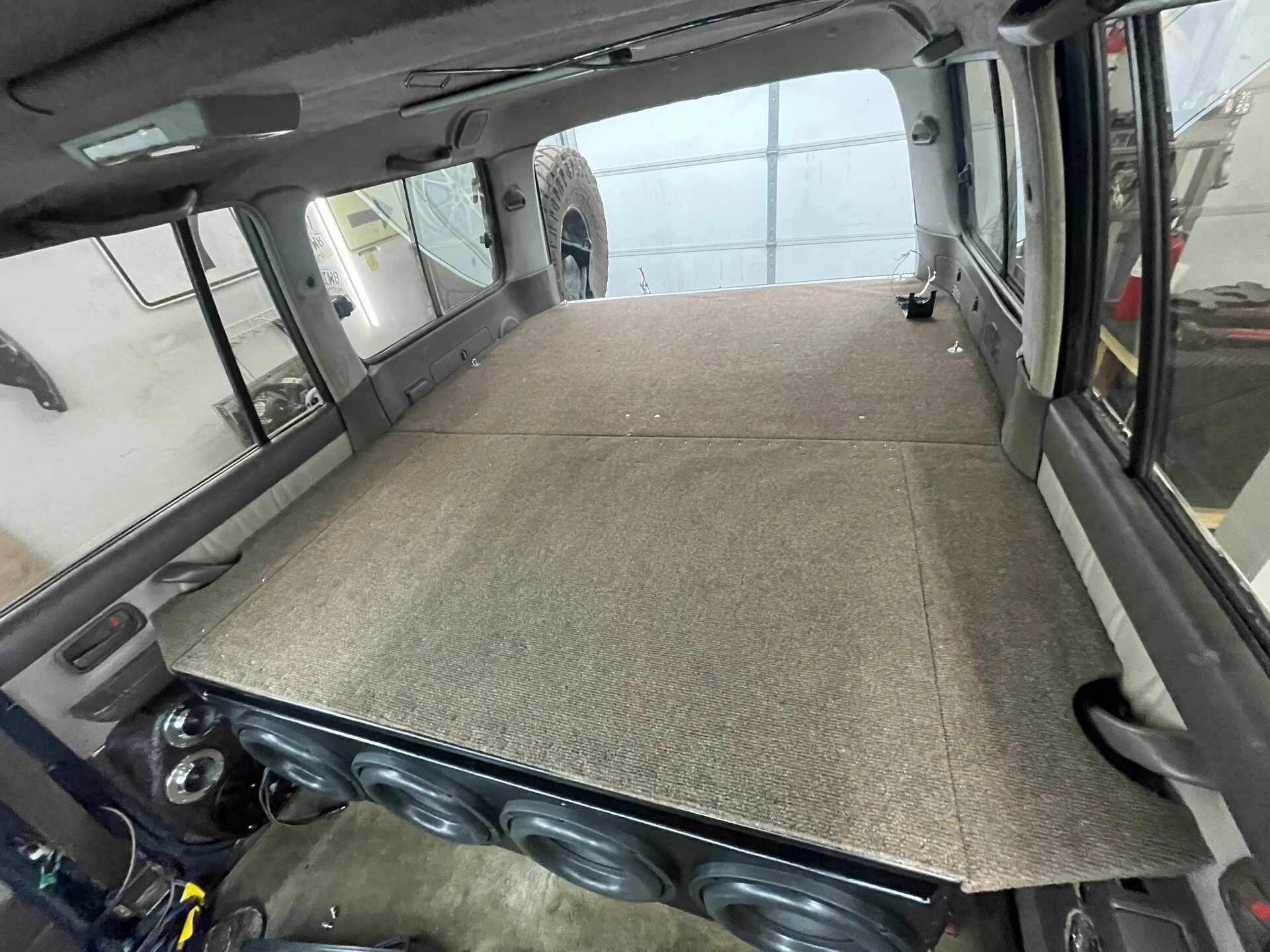

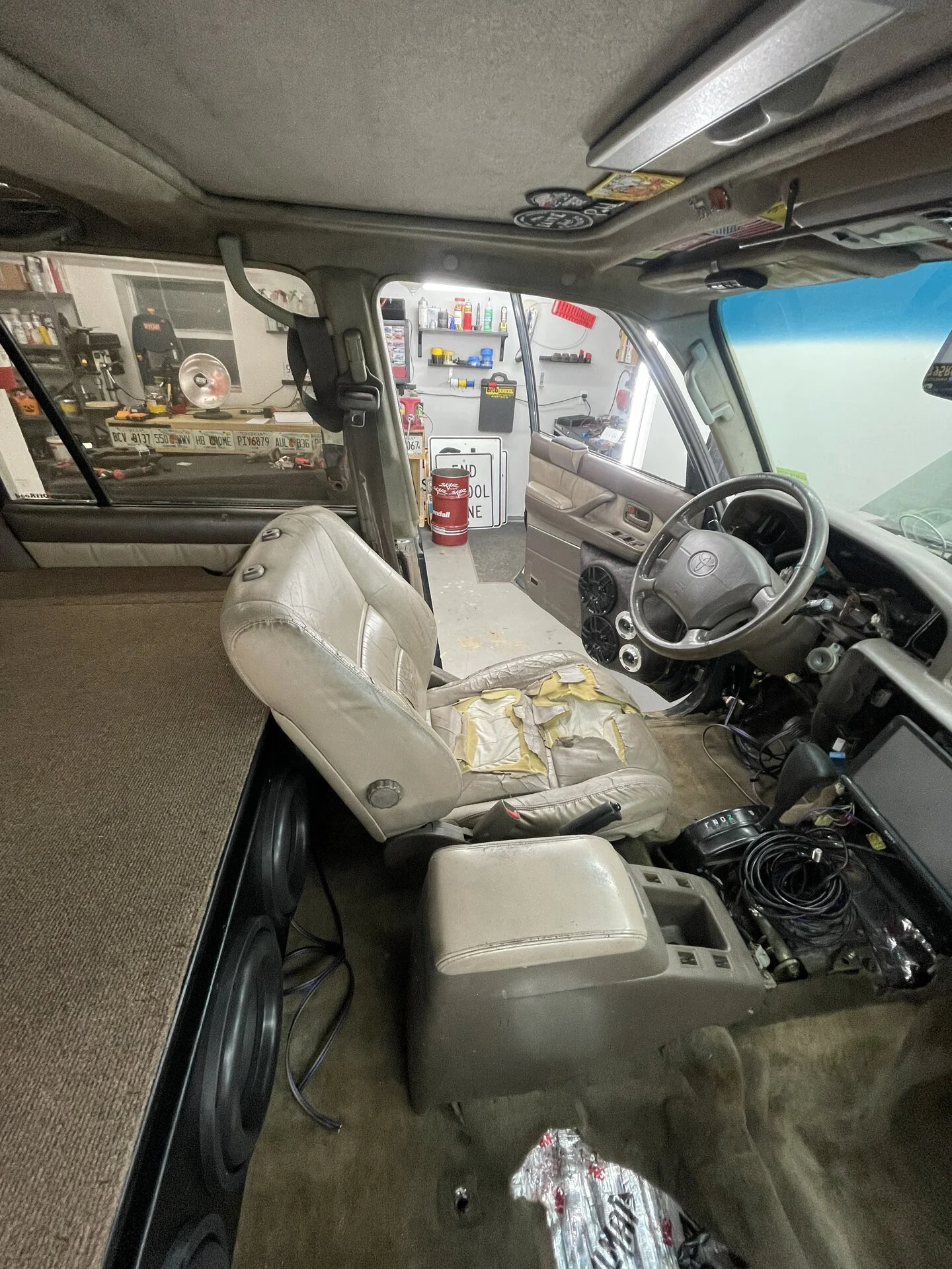

Got a little of the wiring done, a bit more to do still.. this is getting real close. Got total system volume and bass knobs installed in a place im comfortable with, along side the epicenter control knob..
