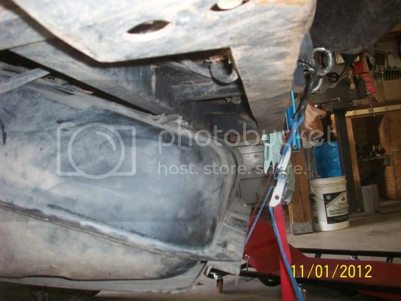

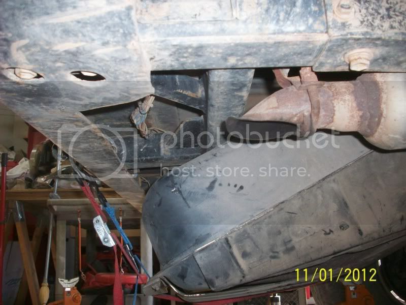

Big Fuel Tank
Montero tank update

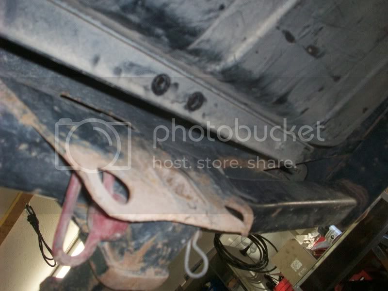

Rear cross member

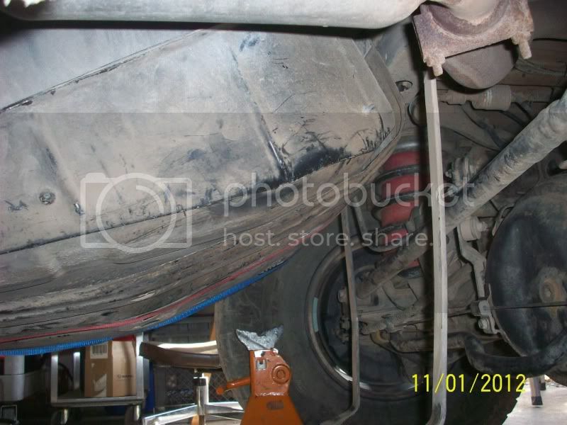

Middle cross member (over axle)

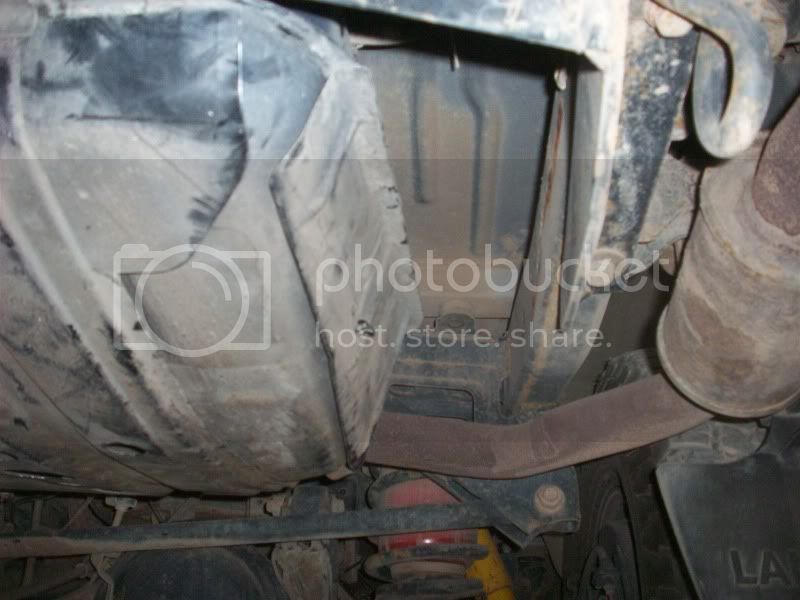

There are four captive nuts that can be used to support the tank lip

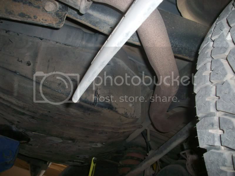

Exhaust area
Gentlemen, I think we have a winner :steer: I'm going to put the spare tire hardware back on the vehicle unless someone wants me to check out something specific with this mock up.
That is fantastic! It looks like it will even work with the tank support I made with my custom bumper hitch support.
Great job all round there.
To clarify this is a 97 Montero LS tank?
