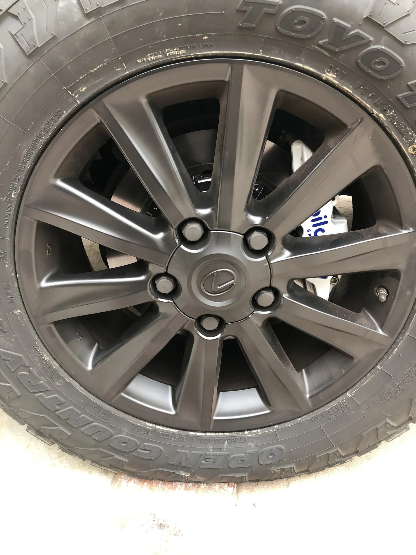

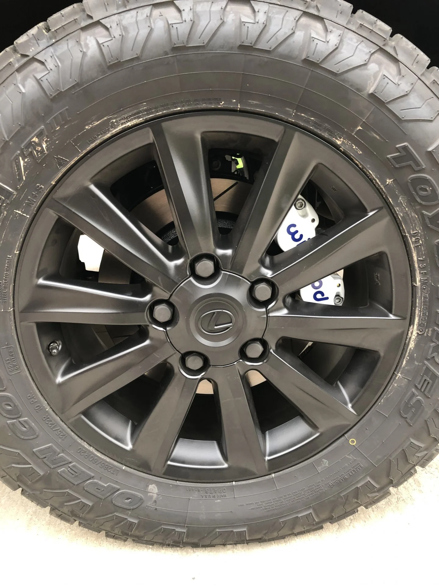

I did this last weekend, as well as the tundra front swap. The brakes were immediately noticeable! I think they are my favorite part of all the upgrades, just chiming in to say I only wish I had done it sooner!

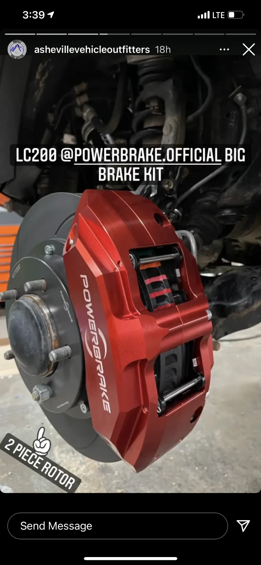

Power brake recently released their six piston calipers and two piece rotors
Landcruiser 200 08-15 08-15 J200 TOY09F X6L 370x34mm 2-Piece discs
Landcruiser 200 15-on 15-on J200 TOY05F X6L 370x34mm 2-Piece discs
A cool $3600 as they only make a Stage 2 kit with the 2 piece rotors for 200 series.
nice, I wonder how much faster it stops the vehicle? I spent $300 on OE grade Tundra parts vs $3600. I am sure powerbrake rotors will be expensive to re-order. I usually love super high performance brakes and cryogenic freeze them in order to give them longer life. But I have had bad luck with cruiser brakes replacing them so regularly and prematurely that I don't trust them. I wish I knew how long Tundra brakes last with Akebono pads. I had good look with Akebono over TRD pads for longevity.
