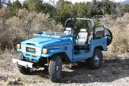

I'll save you some effort.
Obviously the BFG A/Ts. 33x9.50, on the stock steel wheels. With OME 2.5" suspension.
