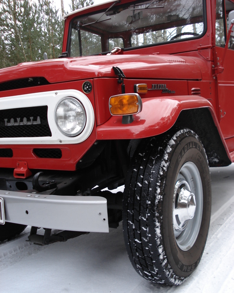

Does that give your truck the stock look? I currently have 265/70-15 and the tires just look odd on a stock truck. Too wide.Im running 235/75/15, no lift 1965 FJ45
That's pretty much the same size tire as stock tires on US-spec Land Cruisers with 15" wheels (H78X15).Does that give your truck the stock look? I currently have 265/70-15 and the tires just look odd on a stock truck. Too wide.
Thanks! That's exactly what I was looking for!That's pretty much the same size tire as stock tires on US-spec Land Cruisers with 15" wheels (H78X15).
Ok. Cooker Tire makes an antique looking H78x15. Thinking of going with those.225/75R15 is even closer to the stock H78X15:
