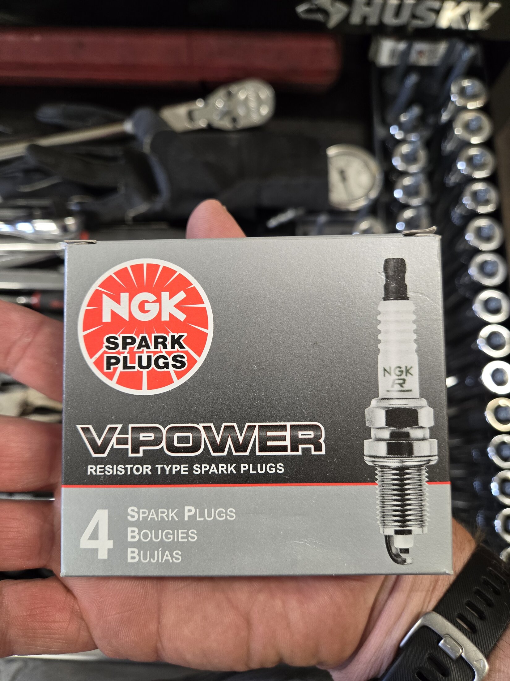

@rkymtnflyfisher
Curious why you recommend these. The book application for 2F engine for the 'V-Power' NGK is part number 1233 (BPR5EY) which is a colder plug. Those pictured above (BPR4EY) are one level 'hotter'.
Do you have any issue with the electrode or insulator burning out?
Also, do you use the FSM gap of 0.32 or do you keep the pre-gap of 0.36" ?
OK, doing the little research I should have done first, the BPR4EY = W14EXRU = 90919-01065 (what the EPC calls for), and the BPR5EY is W16EXRU (90919-01064).
FWIW, all the blue-box aftermarket Denso plugs now available in the USA are made in China. The NGK are made in Thailand from "Japanese Components". if that matters. If you buy the Toyota boxed plugs from Mr. T, they are still made in Japan, Denso, last I checked.
