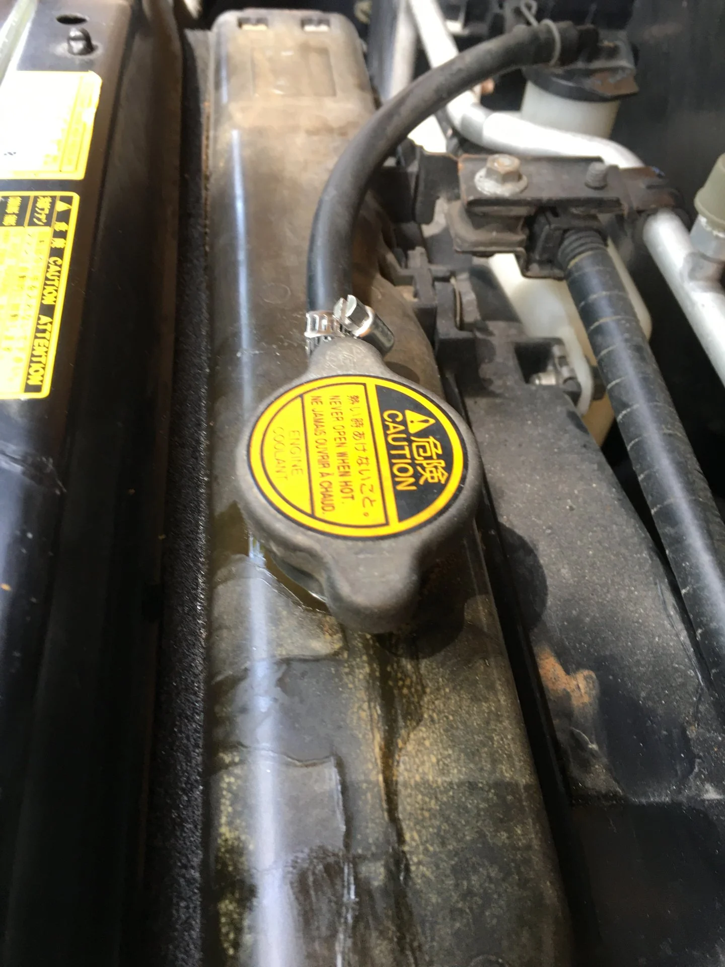

I have a crack in the radiator that leaks in the plastic part next to the fill opening, on the picture on the bottom side. I have tried to glue it on the road yesterday with superglue, did not stick. I ordered a new OEM 50360 and while waiting for it to arrive, I would like to glue the crack or close it any other way (heat it and melt the plastic?). Anybody any experience and/or advice?
My radiator started leaking at the same place. '

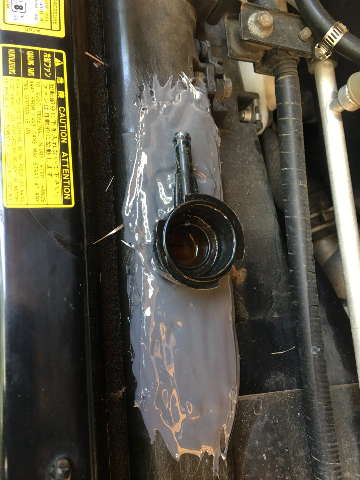

2 days and 100 miles later, this stuff does miracles! I used the 2X more expensive JB Weld Radiator (spend $15 iso $8) from Autozone. It comes with a patch that I cut in half and cut our the filler opening for the radiator. I figured, with the crack on the drivers side of the opening, it would probably go on the other side as well. Anyway, as you can see in the picture, I used all the stuff around the opening and covered the crack at least an inch on all sides. It hardens in about 3min enough to not be reapplied anymore. Cleaned the radiator with alcohol and roughened it up with 80 course sandpaper. It does not look pretty, but it works great for the first 2 days and 100mils.
Ordered my new radiator from Toyota Decator with (still) free shipping (I am on the coast in CA so that would have been ~$150). But at least I can drive the car.
Sofar I would fully recommend the JB Weld Radiotor for these quick fixes!

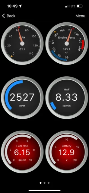

Would be interested with your post-install vs pre-install coolant temps @JJ_SC and @Gnarwgn
Finally getting around to an answer here, sorry for the delay -
Just went on a ~1100 mile roadtrip from Seattle > Jedediah State Park > SunRiver/Bend > Seattle. Was using the OBD Fusion app paired with the Veepeak OBD II scanner. Temps were 70-80 and MPH was about the same. Pretty much stuck at 180-190 degrees all the way through. Highest observed temp was 203, and that was through eastern OR/WA in 90 degree weather at 70-80mph. And only in overdrive above 3k rpm. The temp gauge on the actual dash never touched the 50 yard line.
I haven't touched anything since last summer's radiator/hose/thermostat/fluids swap, and so far so good!
