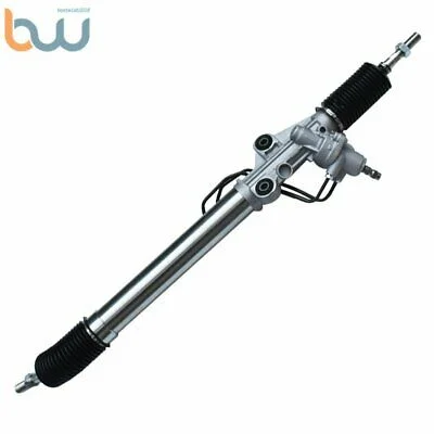

I bit the bullet on this:
...from ebay. The rack has "Made in Japan" stamped on it and appears to be new. Since I don't have a OEM rack to compare to (it's on the truck) we'll have to wait until install in the next few week.
Does anyone have feedback on this brand (FUJI)? It could not find info much info on the company/products online.

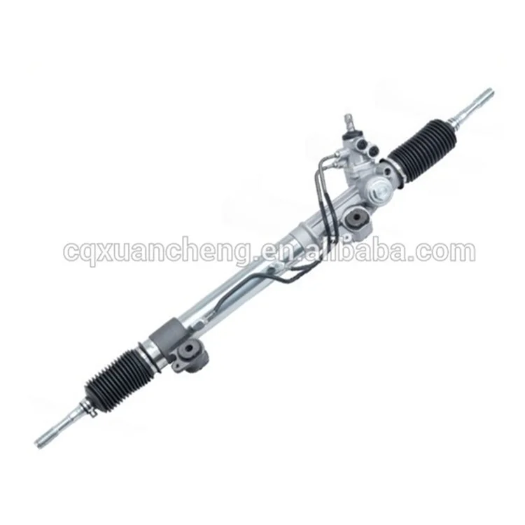

How does this look? I just came across this one and was curious about it.
