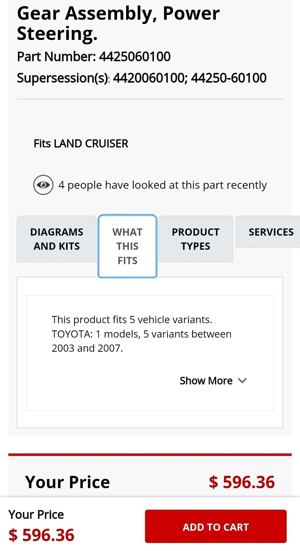

I think you're looking for 44200-60100—should be able to order that from any dealer. Reman Toyota parts....just add -84 to the end.
It comes up occasionally in threads that the racks have been discontinued...I don't think that's the case and don't know where the info is coming from. Easy phone call to the nearest dealer though.

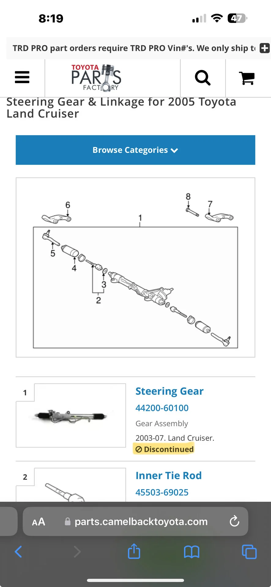

CamelBack Toyota is where I order most of my OEM Toyota parts from. On there sight It says it is Discontinued.
Thanks Ill check with the - number on the end.

Fairly regularly someone posts about “discontinued racks”, but rarely does it actually turn out to be the case.

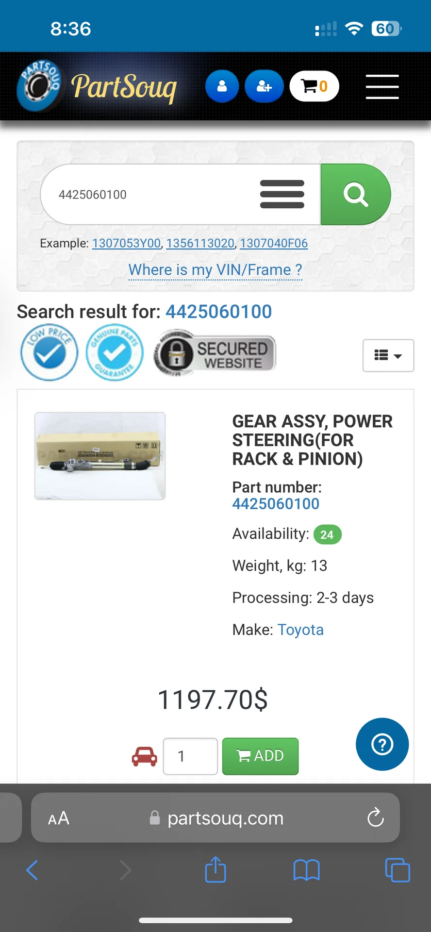

Try plugging the p/n into partsouq, to verify discontinued, or superseded…
Looks like it. I hope so. I need one🤞
Might not be the cheapest source, but partsouq does a pretty good job of pointing you to the superseded parts…

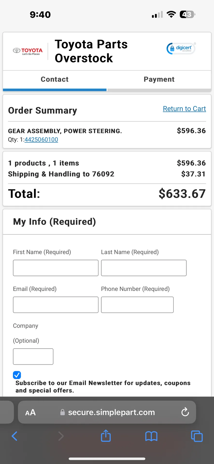

New OEM is the only way to go. I just did this last year at 349k same exact thing was still working fine but boots split and allowed dirt to get to the seals and started leaking.
The dealers have them. Try and find a good dealer with lower prices online and order for pickup. Much cheaper that way.
