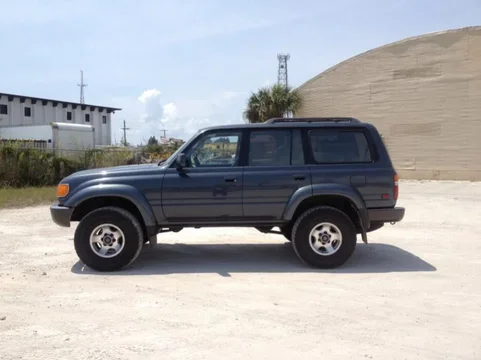

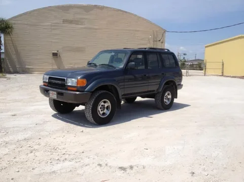

I finally got around to installing my 850J/863 coils and L shocks. I am a little disappointed with the stance. I thought it would be more level than it is. I am running 295/75/16 TOYO AT 2 extremes. I have not installed my caster plates from metaltech yet. I will post pictures when I get a chance.

Looks perfect to me! Looks level...
^^^^this is what i was thinking.
How long has it been installed? give it some time and mileage to settle before jumping to another variable. Truck looks great !
It's only been on a couple months. I have spoke to others about the springs settling. It already has a little bit. It still has a little "stink bug" but nothing like a couple of other 80 riding around in my area. Thanks for the complements.
