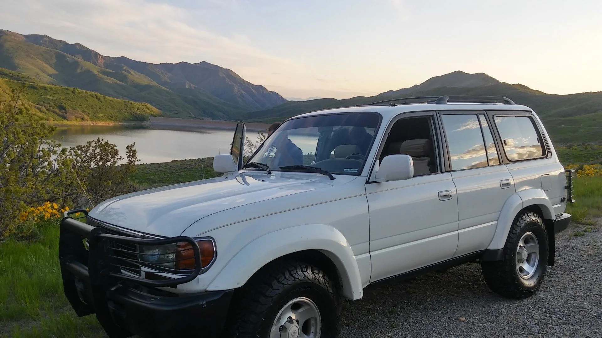

Here are my J's (863 rear) on my wife's rig with 315s

Although my old set-up was not exactly what you have here, I wanted to provide a little input. In this picture of my rig in its former life (before I de-flared, lined, flopped, and chopped) I was running 863J with a 30mm MAF spring spacer in the rear and 850 with Metaltech's 2" spacer in the front. I also installed the 4Crawler 1" body lift and trimmed the rear portion of the rear fender wells. Even with all of this, I still rubbed on extreme flex when wheeling, albeit much less than it did before the body lift.
