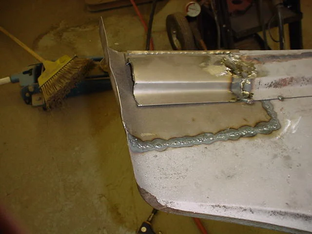

Fenders are pretty easy to fix. Ehsan and Rare Spares out of Australia make patches. I've heard that both fit well and I think both include the bottom curve.

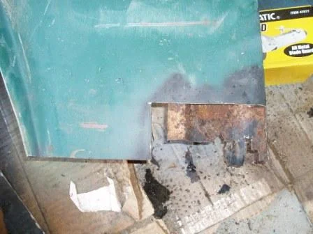

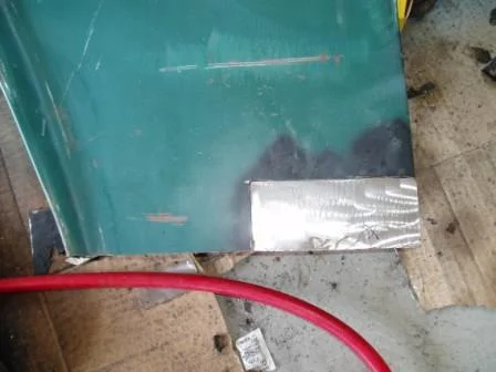

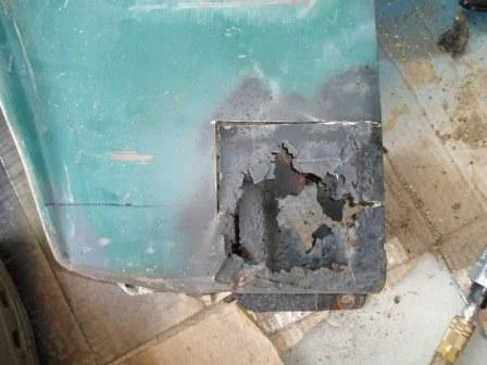

I didn't need the bottom curve b/c of my sliders so I just used 16 ga sheet. I think k9 and I did the same thing on hers. Mine cam out nicely and I didn't even use any bondo.
For the sliders you most often need to cut out what is there and weld in replacements. IPOR makes nice, stock looking, replacements and also nice sliders that you weld in in place of the rusted out ones.
Check out page 9 of my build thread for how I fixed my fenders.

Thanks for pointing me towards your repairs...
Do you mind if I shamelessly link to your repair pics?
From: IH8MUD.com - View Single Post - The Resurection of 'The Beast'

So a follow on to your post - I agree that it does look relatively easy to repair.
What I want to tap into from the Collective Pig Conscious Mind (CPCM?) is the WHY, or what causes the rust problem at the bottoms?
Is there anything I can incorporate in my repairs that will remove rust concerns for the future? Granted, CO is fairly dry state, but I want to pass this Pig on to my boy someday...

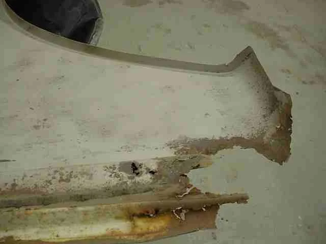

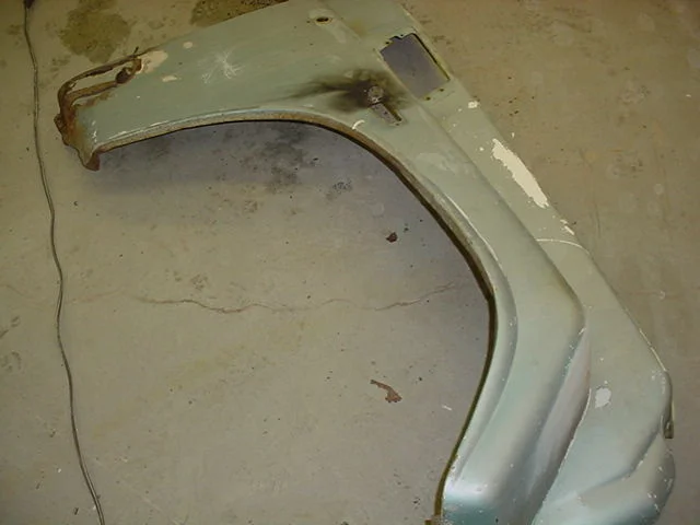

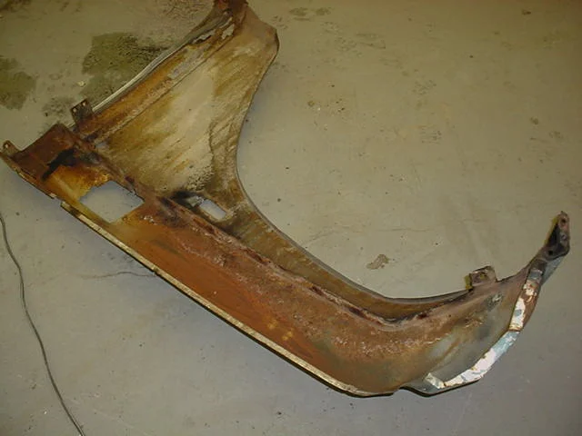

Post #26 describes some of the causes of the rot:
#1 before blasting on the rs fender
#2 before blasting on the inside
#3 inside of the repair on the ls fender. I'm going to do something different with the brace where it comes down on the curve. The stock way leaves a pocket for gunk to fill up and rot out the fender. I think I may just double up the curve and leave the end of the channel open for drainage.
attachment.php
attachment.php
attachment.php
Mud gets trapped between the fender sheet metal (outer) and metal support rib (inner) creating rust. Some of my pics I think in my thread show all the dirt falling out.
And link away!
This really was an easy repair and I'm a :banana: mechanic. If you need the curve buy the replacements from Ehsan or Rare Spares. Trace the replacement on the fender, cut the rust out, then weld the replacement in and I don't think you even have to worry about the inner support b/c the replacements are thick enough.
