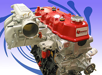

you want high power 22RE's?
check out LCEngineering
and its still the best engine availible
Tim is a one-man-show shop (unless he's grown). He's VERY knowledgable, and if you get him on the phone he will talk your ear off about tuning these engines. I've called him for advice a couple of times and he's freely spent time on the phone, even though I wasn't buying anything.
I also have his metal chain guides in my engine now, good stuff.
I've been pretty happy with my DOA engine thus far....and Tim doesn't mind spending time on the phone. I don't think you would be going wrong with LCEngineering either. It was a very hard decision for me....and my 22RE was still running. :D
...as it was I still spent a few grand with LC on other parts.
