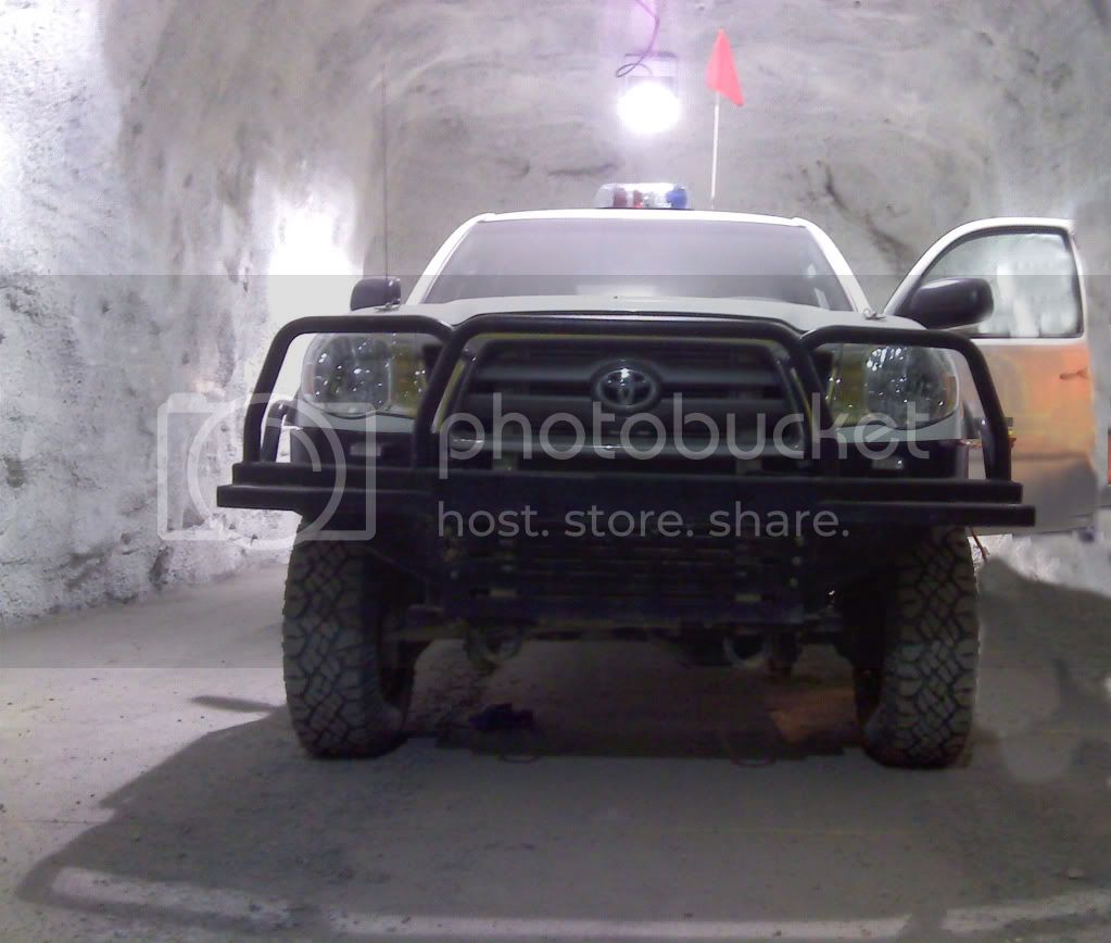

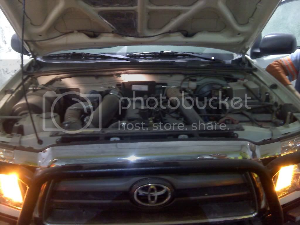

Underground run diesels because of carbon monoxide. They also need smaller vehicles. We have a 2nd gen Tacoma with a 3.3 Cummins sitting on diamond axles and 80 series arms for our underground ambulance. We also have powerstrokes, all surface stuff is gas fords.
So idk if it tells me anything.
I work at a very large gold mine BTW.
