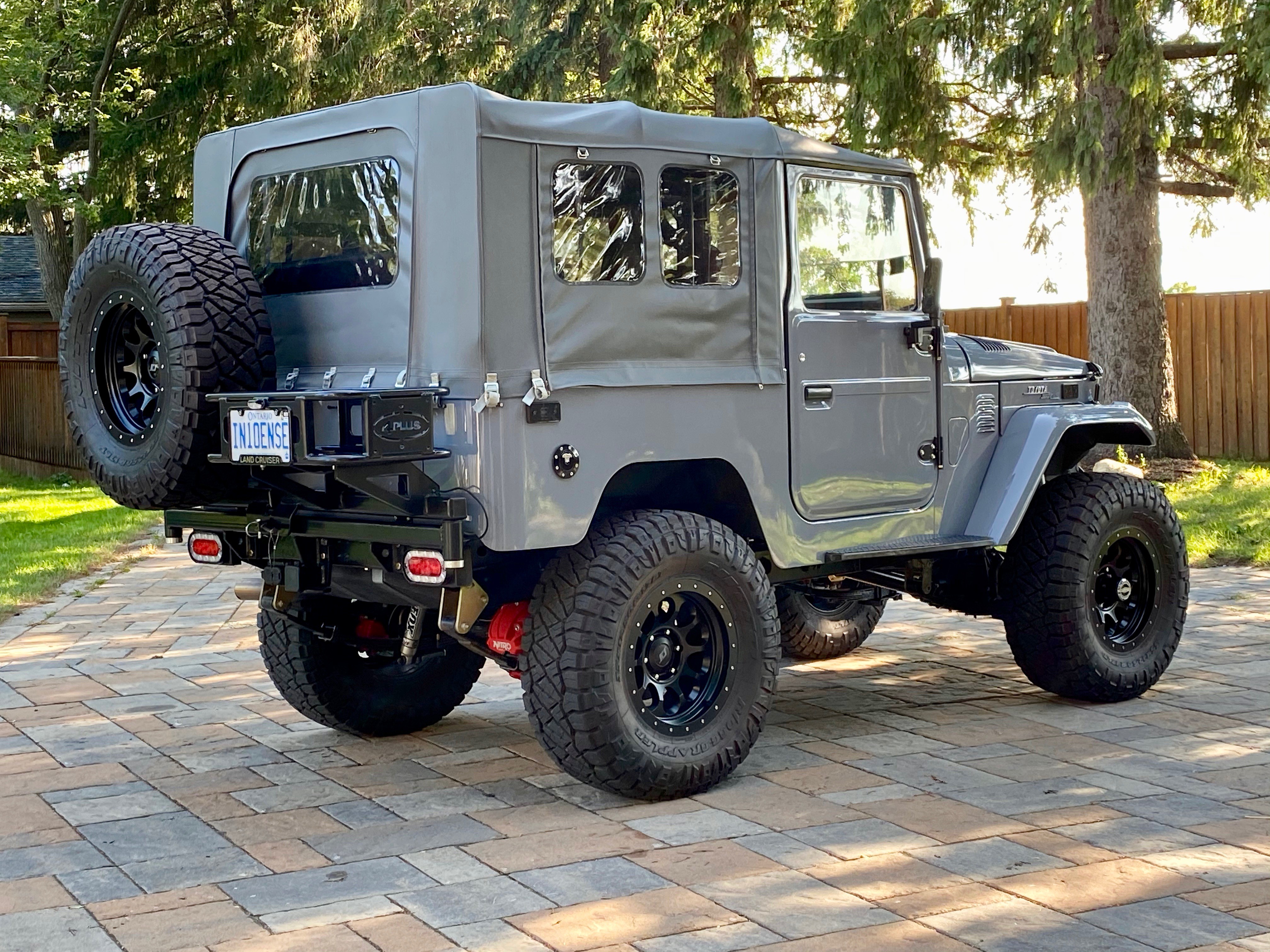

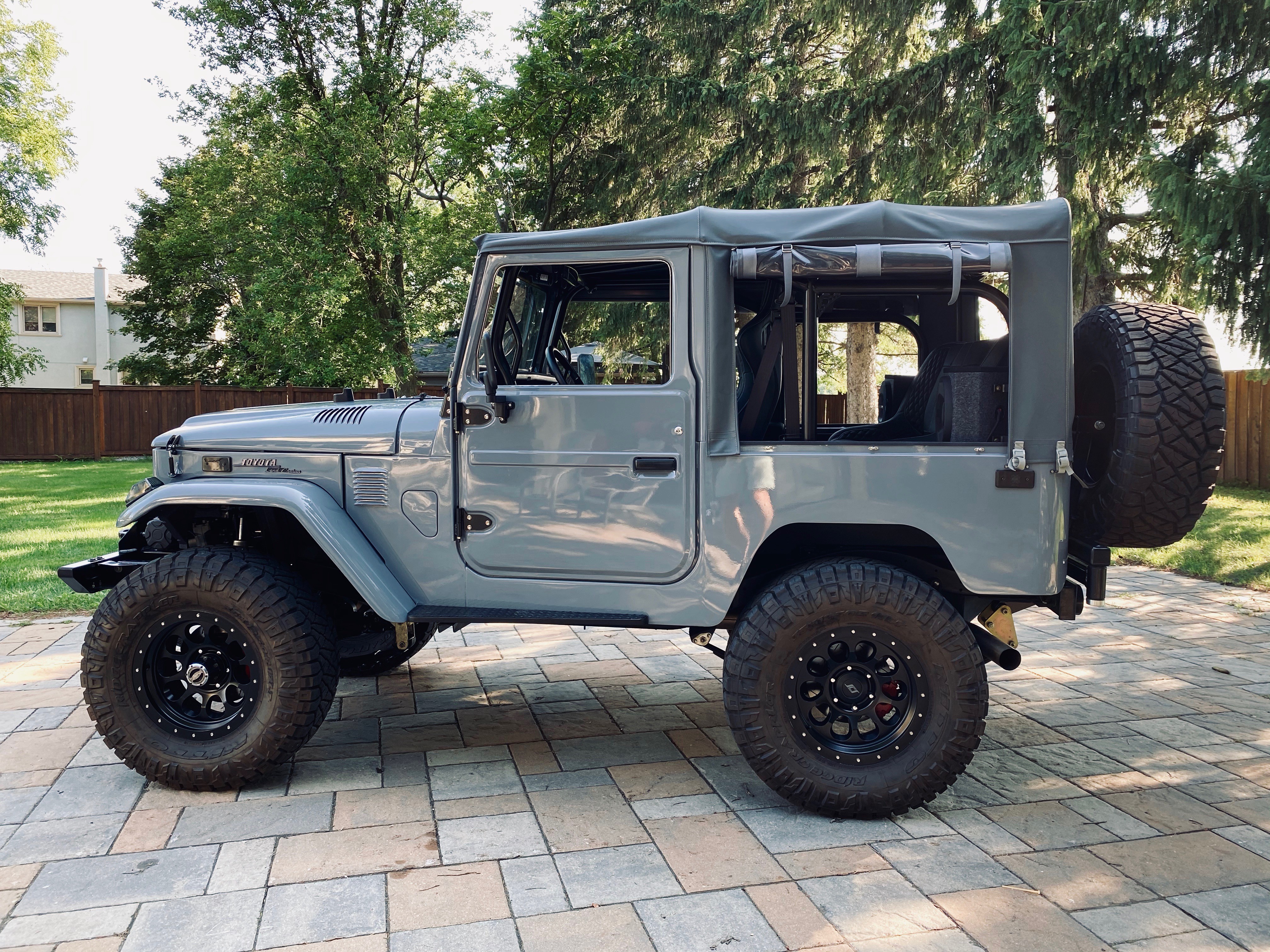

I have a 40 tub and 45 bed and I’ve been extremely happy with the quality. The 40 tub is currently sitting on the ground killing grass.
Is that a full tub or 3/4 with a OEM cowl. The kick vent and stamped louvers look OEM steel. I do not remember a aluminum tub having that close to OEM detail.
Good eye. I spotted it too. Our cowl has 5 louvers and builds using the full cowl/tub usually don't have any seams. Beautiful build regardless!
