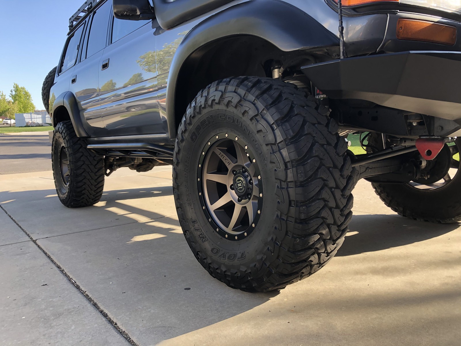

I have the Icon Rebound but mine are bronze. The ones that work on the 80 are 17x8.5, 0 offset, 4.75" Backspacing. If you don't run wheel spacers, the center caps won't fit over the cruiser hubs. But since you're looking at black wheels you probably won't even notice.
I have 1.5" spacers so I'm running the center caps.
Untitled by Adam Tolman, on Flickr

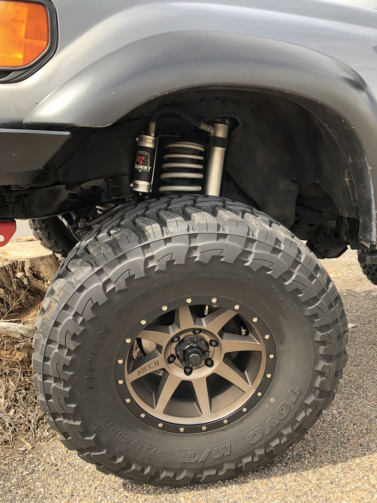

what they look like without the caps
37’s and bumpstops by Adam Tolman, on Flickr

Thx! Yea really like the spokes on these! I have Aisin hubs on the front, so won't use the center caps.

Do the icon rebounds not fit directly? will they need spacers?
They do fit directly. The only reason you need a spacer is if you want to have the center caps on the wheels. The hubs on the 80 stick out a bit farther and the center caps won't fit without a spacer. But the wheel still looks good even without the spacer IMO. Another option that I have seen done is to contact Solve Function and have a set of center cap spacers 3D printed. That way you can still keep the center caps and not have to use a wheel spacer if you're opposed to them like @COYS
FWIW, there are a number of vehicles that from the factory use some type of wheel spacer. So they aren't a "band aid" and they work just fine. I've been running a wheel spacer on my trucks for more than a decade without issue.
Here's what the Icon Rebound looks like without the center cap installed.
