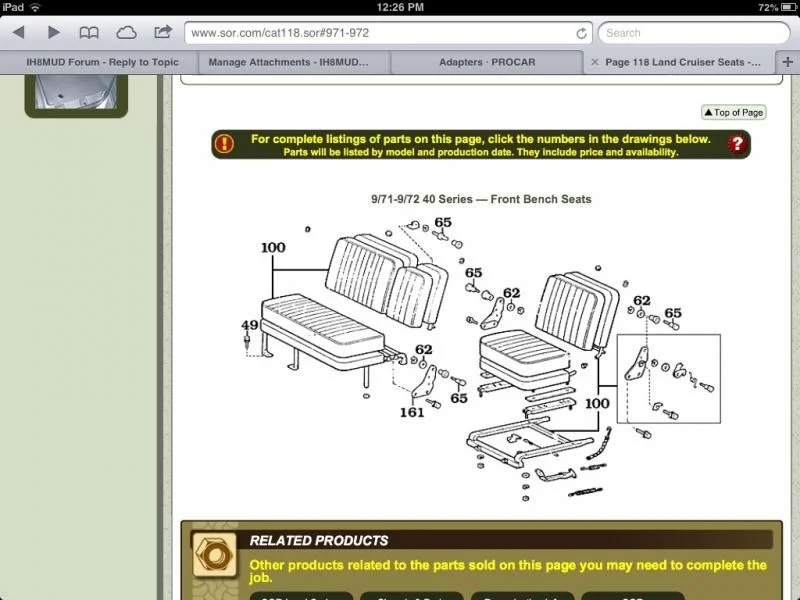

Could show a link to a picture of for the 70 to 73? Your links shows a universal adapter which not any better than starting from scratch. I clicked on Toyota and it brought up a bunch model with parts number but I could find a way to go any further. I do know 73 was bucket seats not a bench seat. Bench has a tool box under the left seat to deal with while the buckets don't. Their chart didn't make sense to be either 96 4Runner would fit 91-96 and 96-02:confused: FJ40 74-7/75:confused:
When I got my 72 it had the "seat cores" in it but no upholstery. Sor lists the same cores from 63-9/72. I spoke with procar customer service and they said that part numbers 81598 and 81599 would bolt to these cores and would adapt their seats to work in my 40. That's one option that I will be using when the time comes for seats. Another option would be the Overlandwerks kit which I am leaning towards for the better seat option.

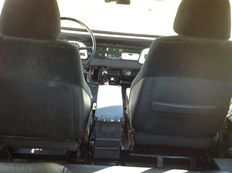

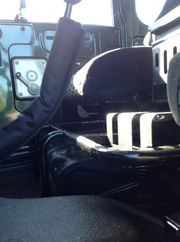

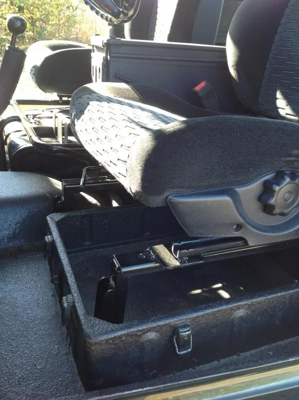

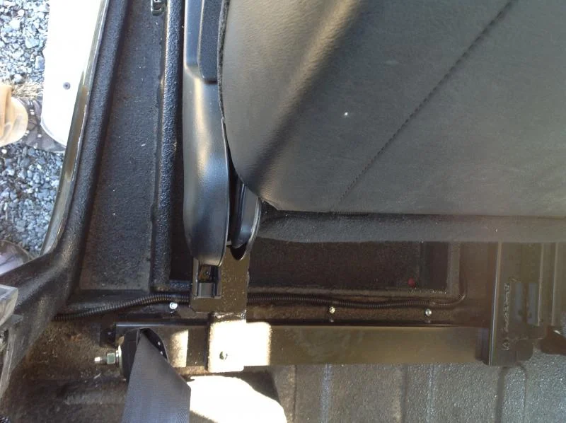

I did the conversion on my '70 40...kind-of. The PO converted it to Datsun 280Z seats long ago but the seats were trashed. I needed new seats. I cut down the passenger side seat frame to fit a bucket and mount an ammo can console. I welded tabs to attach the sliders. On the driver's side the tool box lid was removed and I used Springtail Solutions brackets for the driver's seat. The seats are from a Honda Prelude. Be aware that due to the gas tank under the passenger seat it will likely sit higher than the drivers seat.
