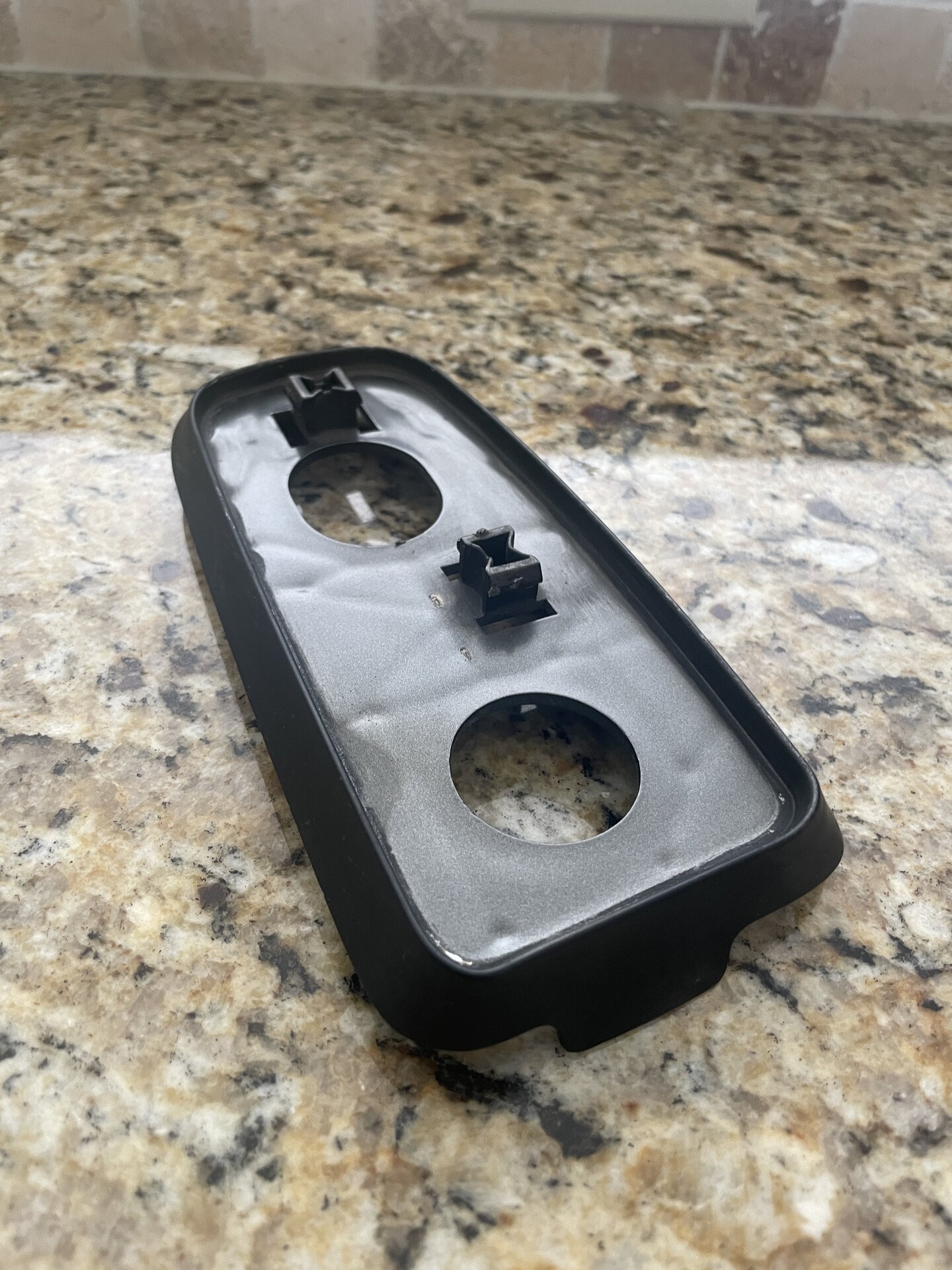

Hey @BenCC, I messaged you about the Make 24 if you have a chance to take a look. Thank you so much for what you do.

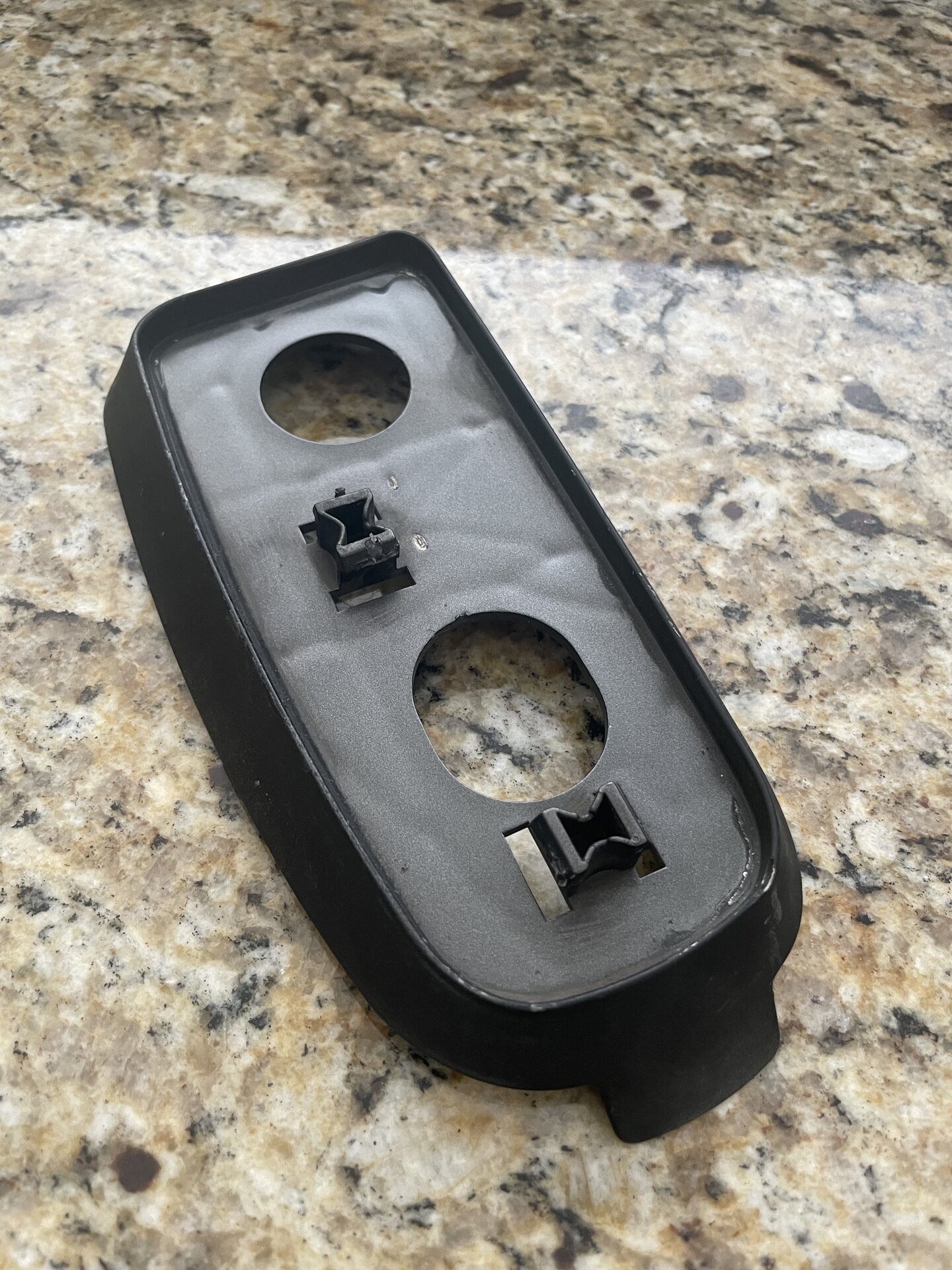

Probably a long shot, but if anyone has installed the M2V2 dash mount in their 98-02 Land Cruiser and wants to sell their original dash blank I would very much like to buy it! I have an LX and I want to drill a hole through this blank but I don't want to drill through the wood one. Would much prefer the black plastic in the Land Cruiser and I don's really have a need for the super strong mount that Ben sells (even though it is awesome). Just trying to keep my iPhone mini from sliding around.
I can check this weekend for you; if I still have it (which I should), it's yours.
That would be awesome! Thanks!

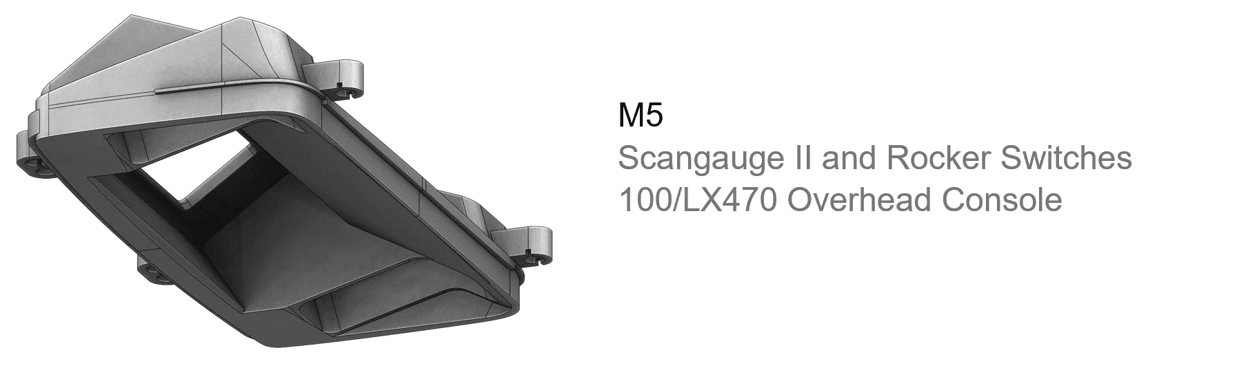

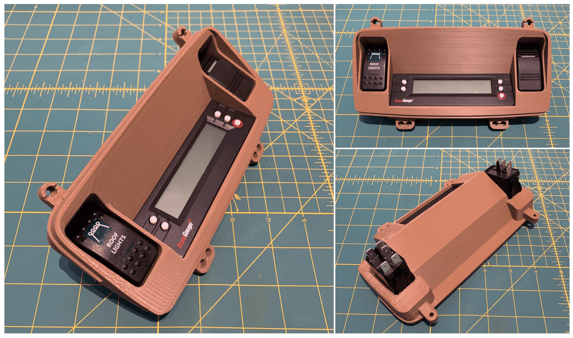

Make 5: Scangauge II and Rock Switches Combo Mount for Toyota Land Cruiser 100 Series
5.1 Overview of the Final Product
5.2 Introduction

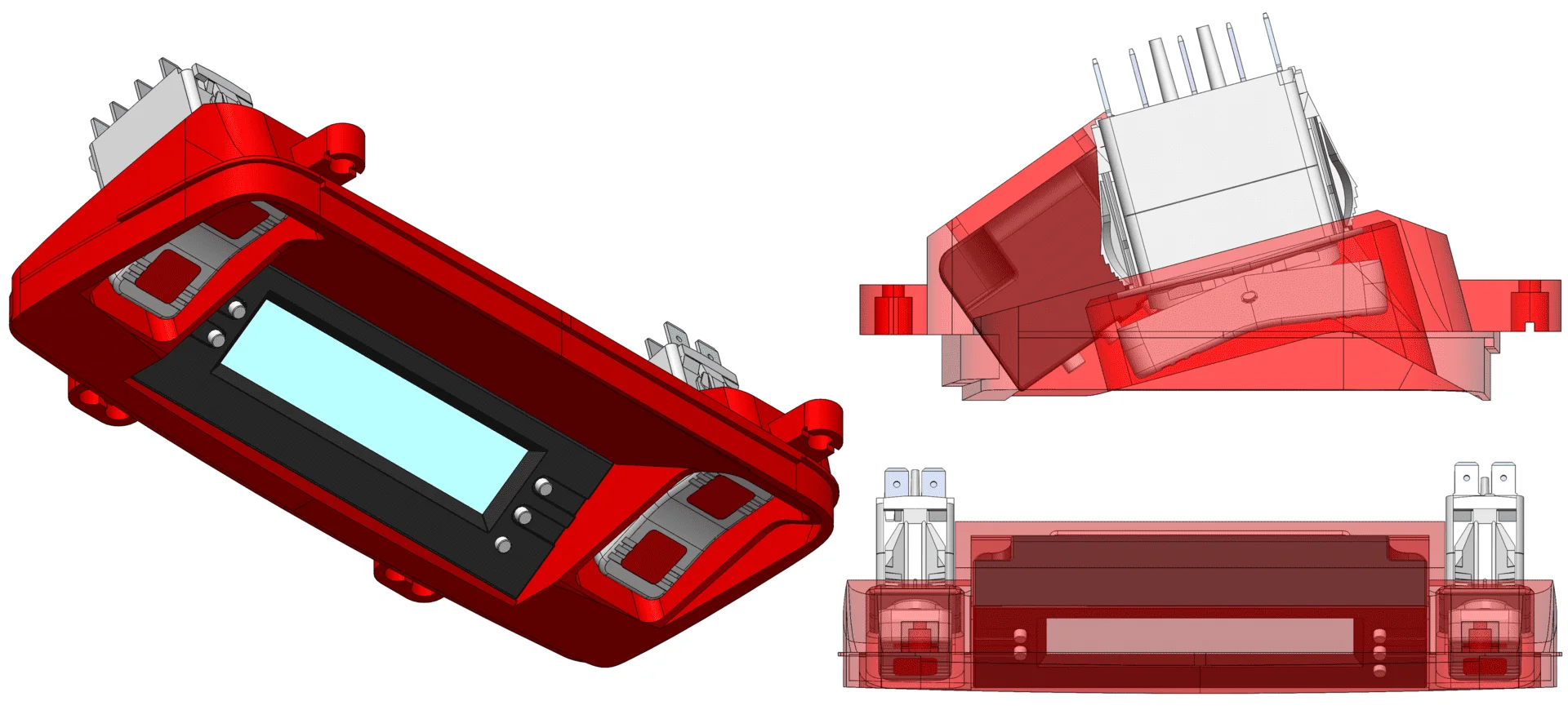

The combo mount is modeled based on members' requests. Two pockets for rocker switches are added. The rocker switches are fully recessed to protect it from accidental activation.

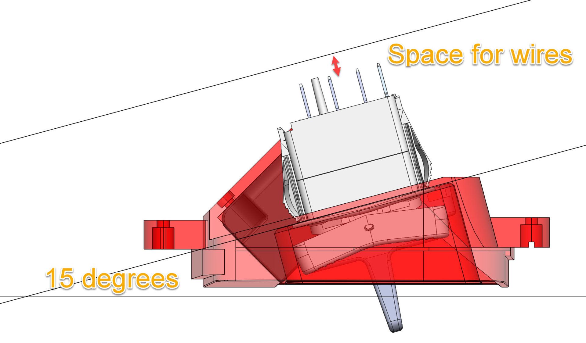

5.3 Design and Fabrication
The rocker switches are tilted by 15 degrees for better visibility of the stickers. Space is added behind the blades for wire connections.
5.4 Purchase List to Complete the Installation
To complete the installation, the following items will be needed.
Ethernet Cable Extender Adapter
Ethernet Extension Cable (Up Angle)
For a smooth finish, you will need:
3M Bondo 801 Professional Glazing and Spot Putty, 3.0 oz.
Note: Dry sand only. The printing material will warp if exposed to excessive water.
Paint
5.5 Purchase Link
$75 + Shipping (USPS Priority). PM for Direct Paypal Payment.
Can print in Grey, Tan, or Black.

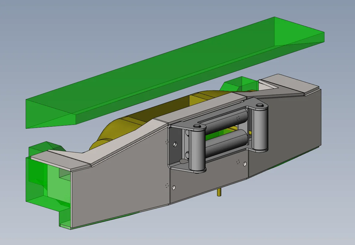

Ben, are you using some kind of 3d scanner to get the surrounding geometry for your prints? I tried searching the thread but I may have missed it if you answered before.
The reason I ask is if you do have a scanner, I'd request some scans of the front end. I want to design a hidden winch mount I don't like what's currently out there as you generally have to remove the crash bar and they mount quite low.
Below is my initial design. Not sure if I want to go aluminum or steel, the weld shop at work can do either. Probably aluminum to save a bit of weight.
