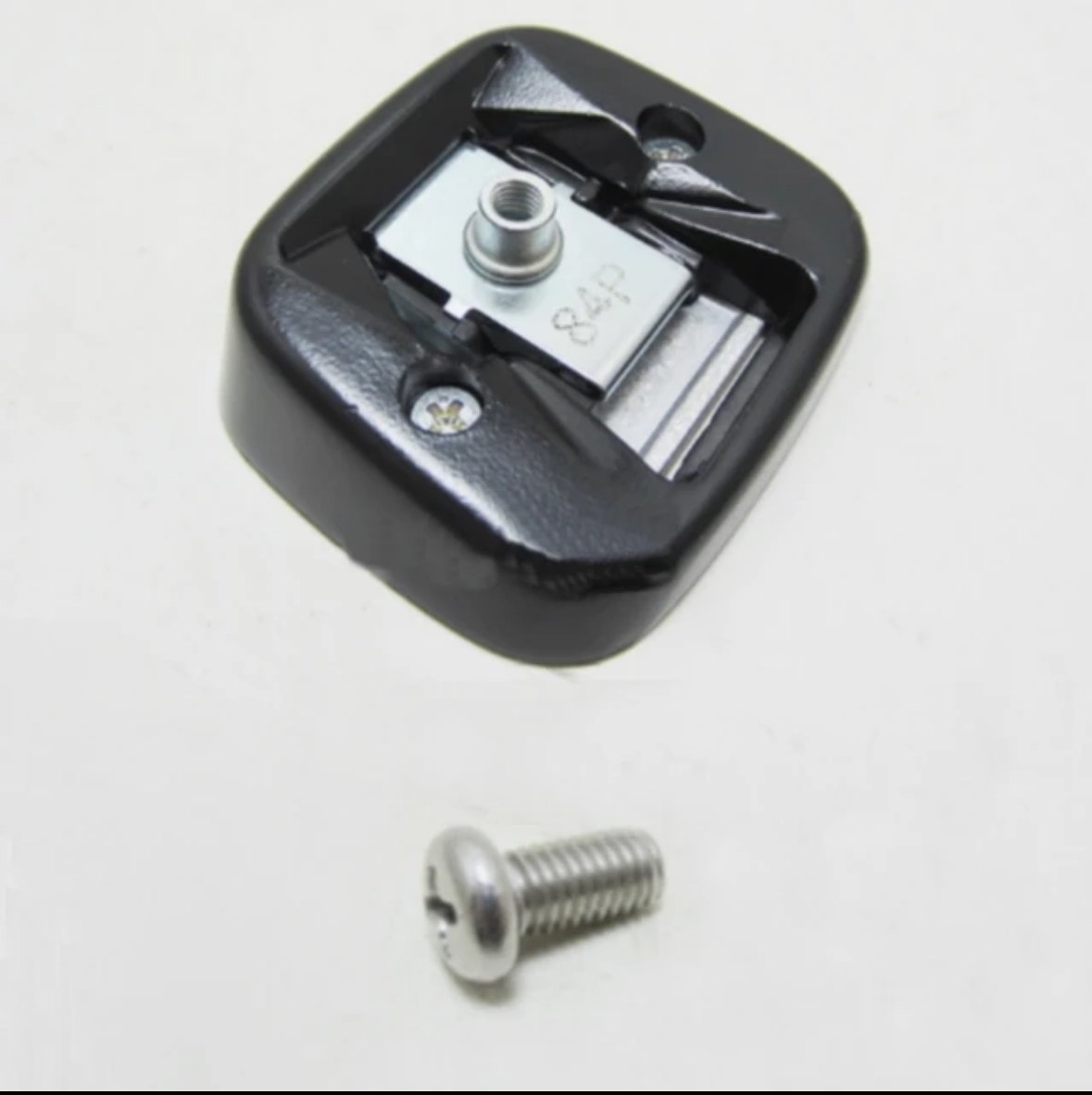

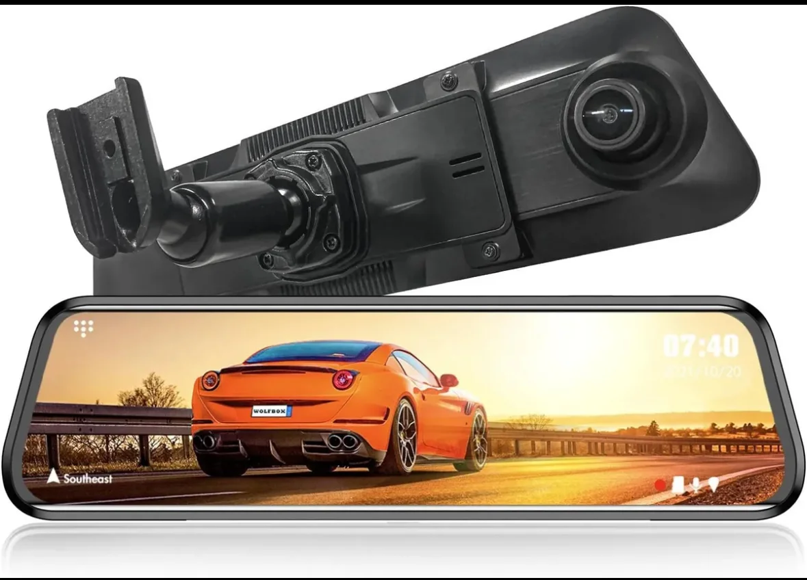

What about a 3D printed rear view mirror conversion adapter?
I’d love to ditch my old OEM mirror for a digital rear view mirror with back up camera, but our 100 series mount doesn’t work with anything.
^ 100 series assembly
I am not sure what is most universal for these things, but the this is the one I’m troubleshooting:
That one has been covered in another thread, and as far as I remember one of the companies making the mirrors threatened to sue the manufacturer of the 3D printed mount.. Since then I have made my own, but would love to have a finished product, preferably with a way to hide the cables. Will probably try to incorporate that in my version, but I'm pretty sure that Ben would make a very very nice version.
Which I would also be interested in.
I am dying for the rear view camera 3d print. Our current car situation requires my nanny and mother in law to need to drive the Land Cruiser some - a reverse camera would really help them with parking and such.

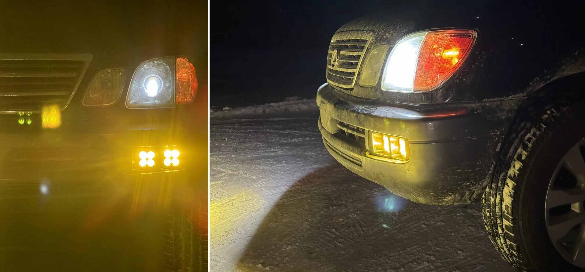

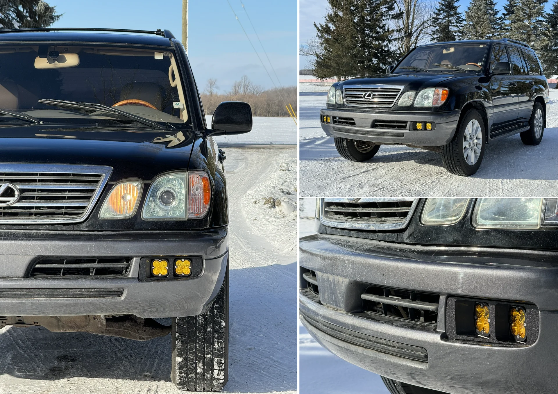

Make 63: LX470 Foglight Mount
63.1 Overview of the Final Product
Video (with Baja Designs Squadron Pro):
More pics:
63.2 Description
The mount is designed to accommodate two Baja Designs Squadron LED pods (Pro, Sport, or SAE variants) on each side. It is suggested to use the Squadron SAE model, as it is specifically engineered to function as a fog light.
63.3 Design and Fabrication

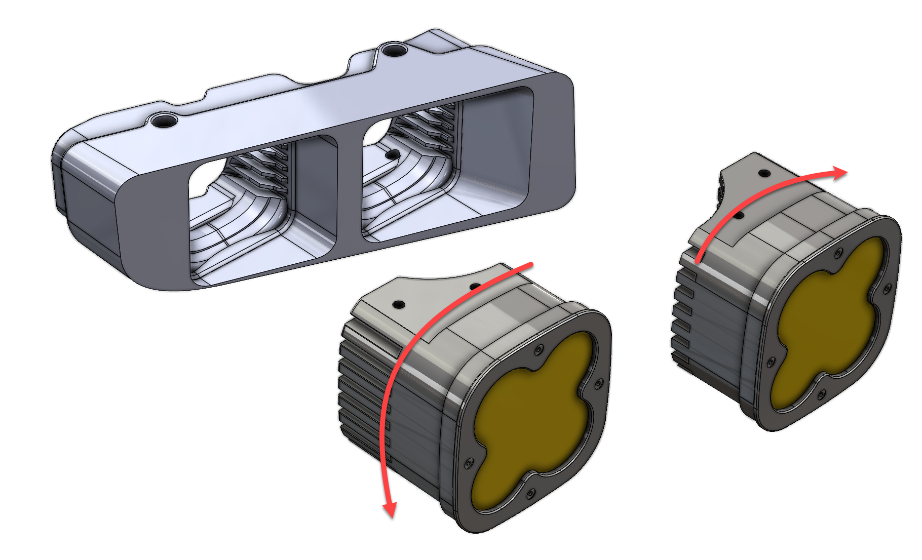

The toughest task is fitting two pods into each side. Attempts to do this in the LC100 fog light pocket were unsuccessful. The LX470 fog light pocket, on the other hand, is broader but not as tall. The initial design positions the two pods horizontally, as illustrated below:
(The pods depicted in the figure are Baja Designs XL80, not Squadron models. They are utilized solely for illustrative purposes. CAD credits for the XL80 go to Peter Scolaro on GRABCAD)
This approach works for the Squadron Pro and Sport models because their lenses can be rotated 90 degrees. However, it is not suitable for the Squadron SAE model:
(https://www.bajadesigns.com/wp-content/uploads/Installation Instructions/FGXX_257801_REVA-INS_001.pdf)
(https://www.bajadesigns.com/wp-content/uploads/Installation Instructions/FGXX_257811_REVA-INS_001.pdf)

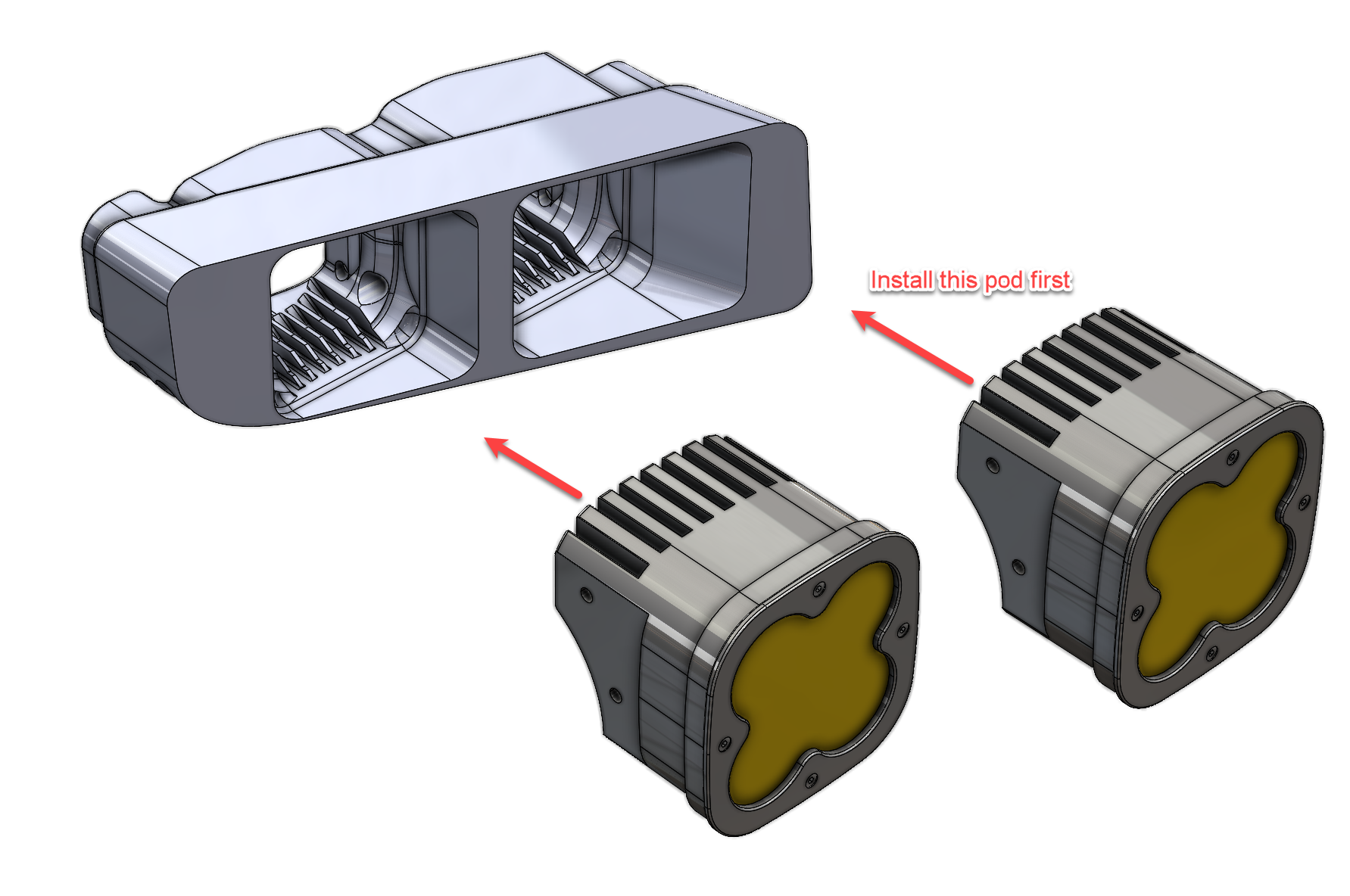

This issue arises because the Squadron SAE was designed using entirely new aspheric projector optics. Thankfully, I managed to redesign the mount to install the pods in the correct orientation:
In the figure referenced above, the mount is designed for the passenger side. The pod that is closer to the center of the vehicle should be installed first, followed by the pod on the outer side.

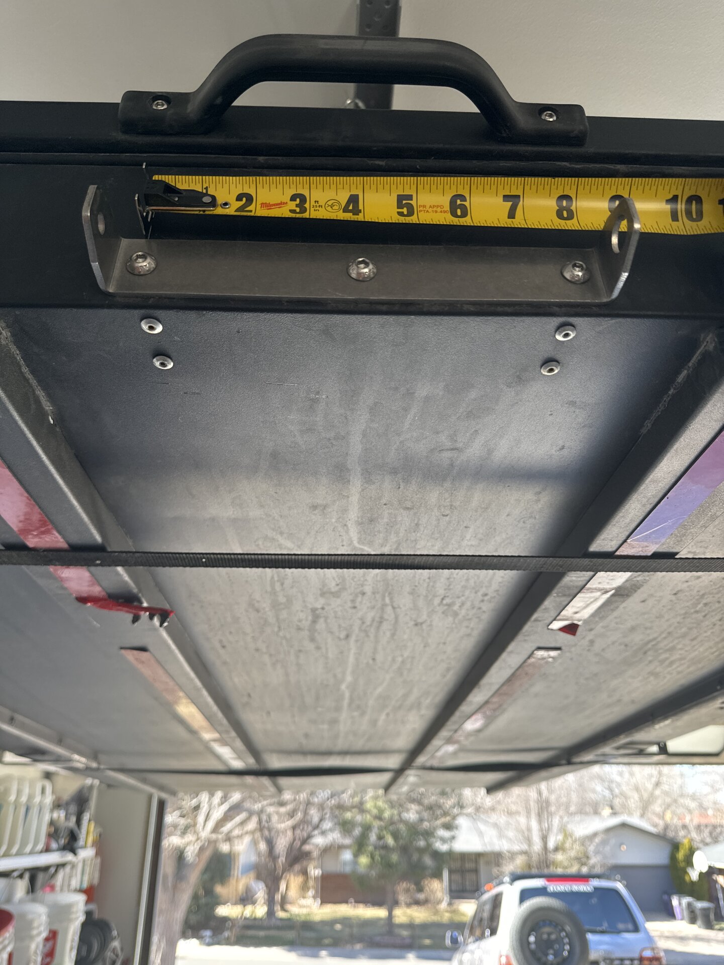

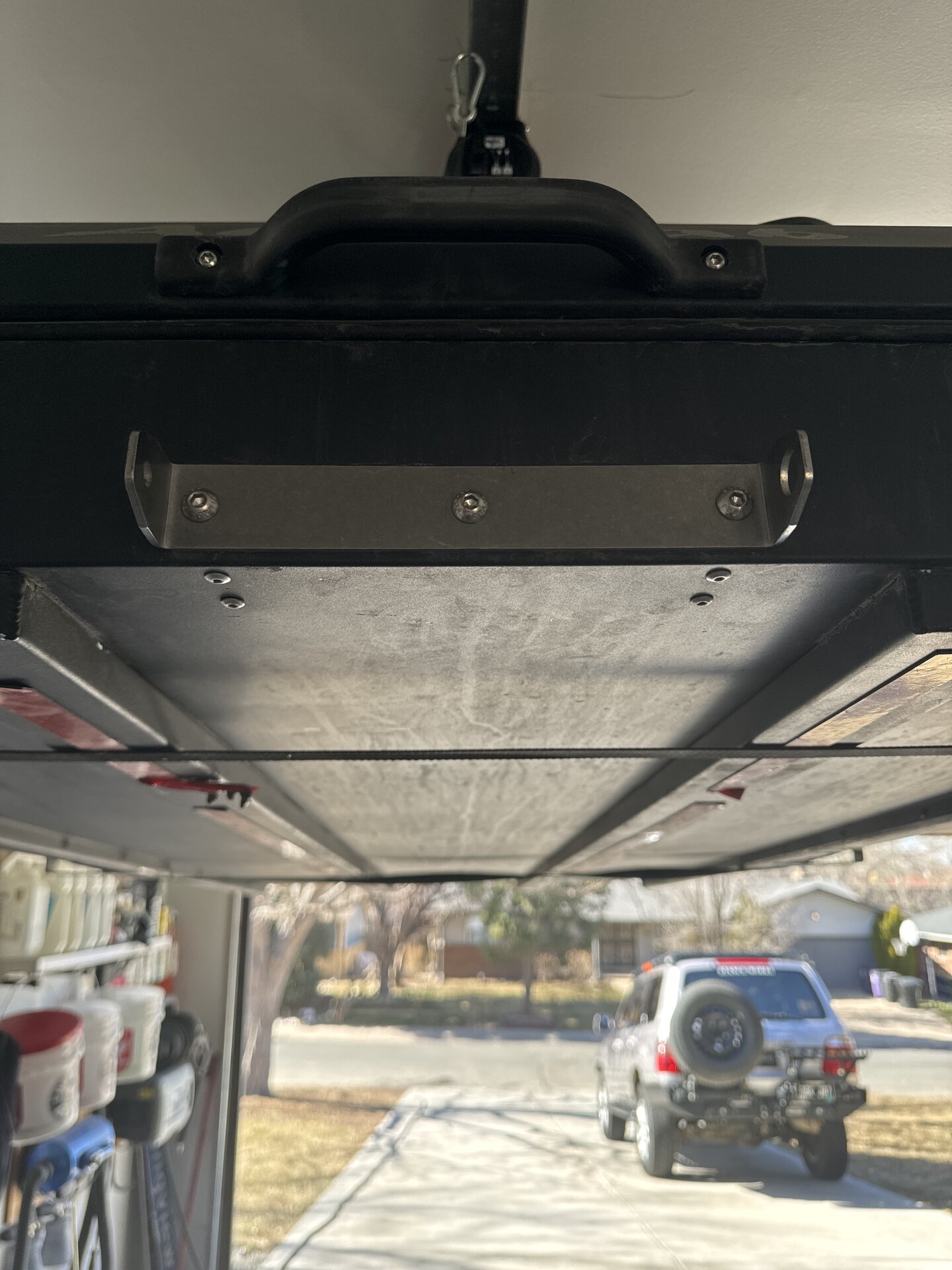

Hey Ben - might be too speciality for you but figured I’d ask.
I’d like to replace this ladder mount on the rear of my Alu-Cab with a bracket that I can clip a rear camera onto.
Bonus would be enough space for a chase light/rear light.
If interested I can pull out the bolts and get a proper measurement ..

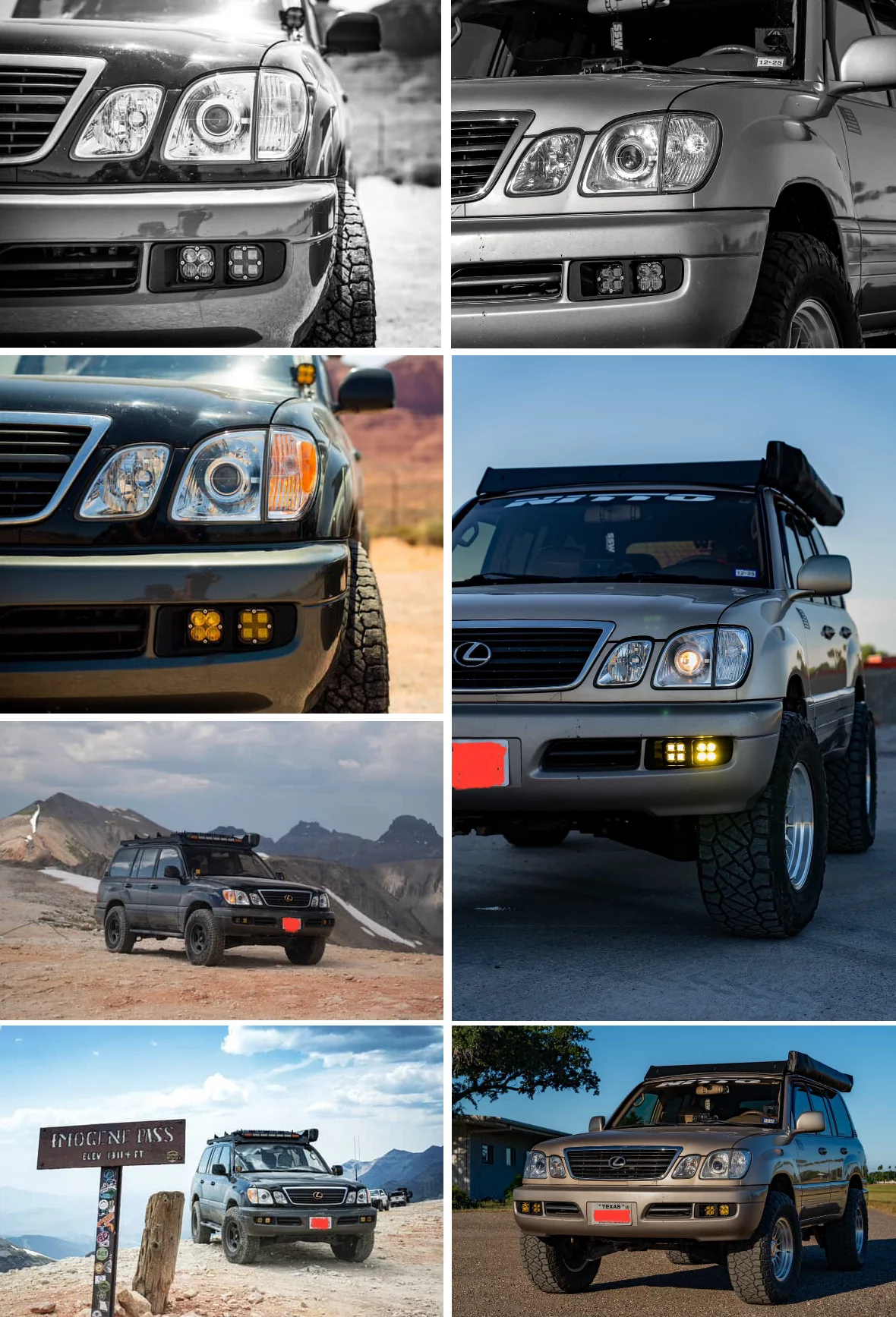

I got my first LC100 (Left) back when I was doing my undergrad at Ohio State. Then, I drove it all the way to Los Angeles for my Master's, but had to let it go because of the crazy long drives and the gas prices killing my wallet ($5-$6/gallon in 2015). When I came back to Ohio State for my PhD, I found myself another LC100 (Middle). But, just as I was about to finish my PhD, I had to sell it because of some hefty medical bills. That was a tough time. Now, I'm on my third (Right) and it's my ride every day. Looks like I'm gonna be sticking with the LC100 platform for a long, long time.
Just sharing.
