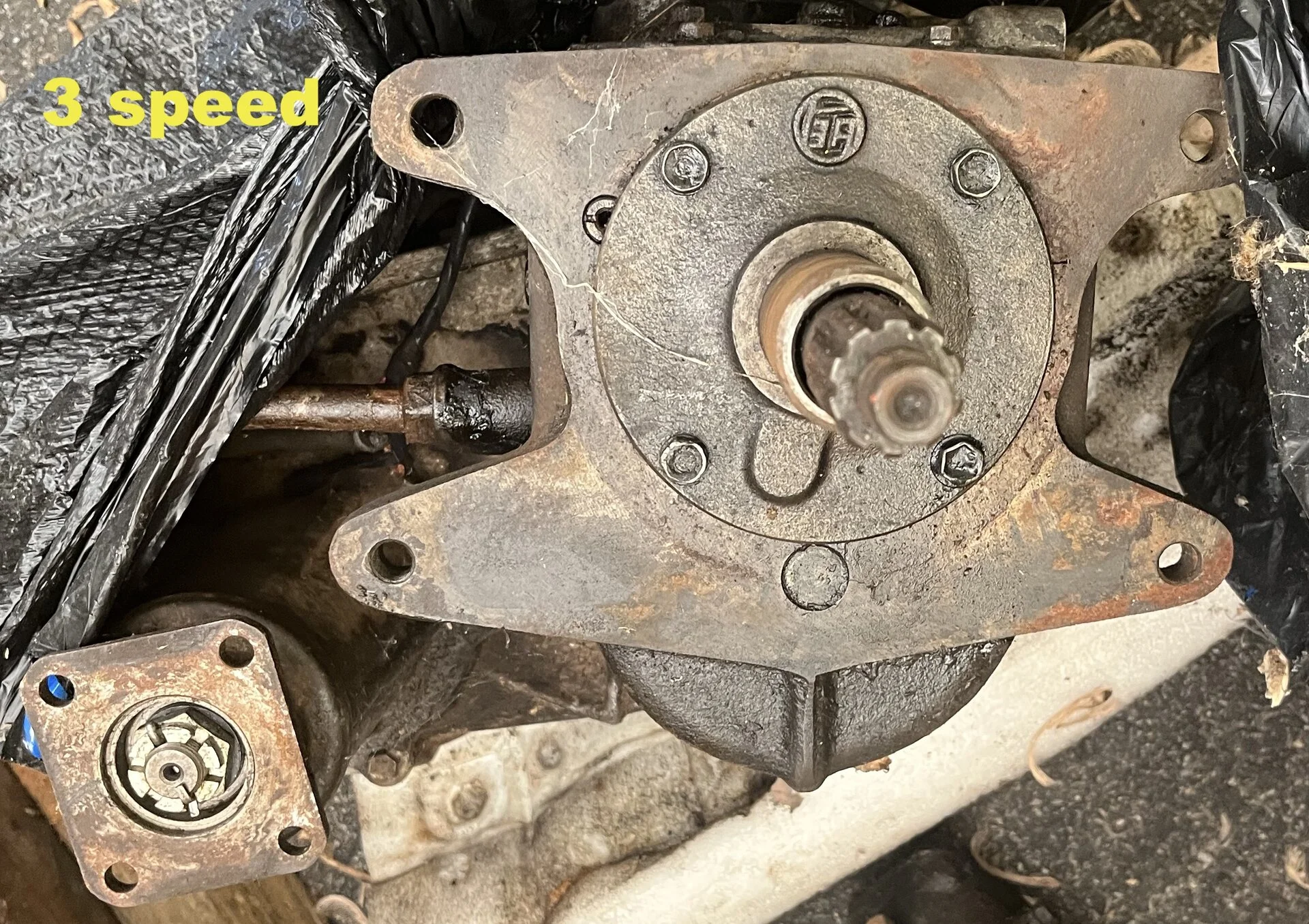

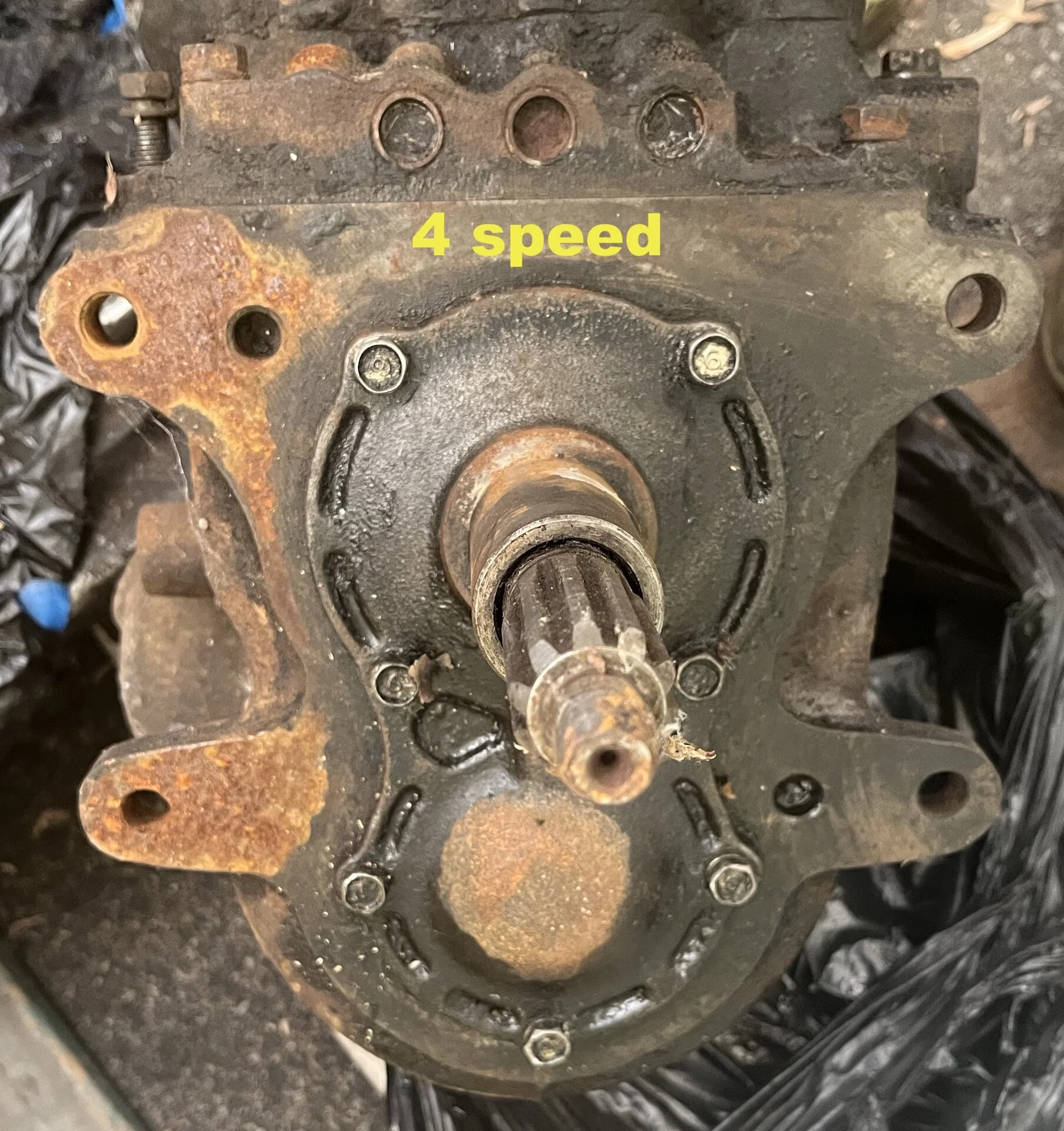

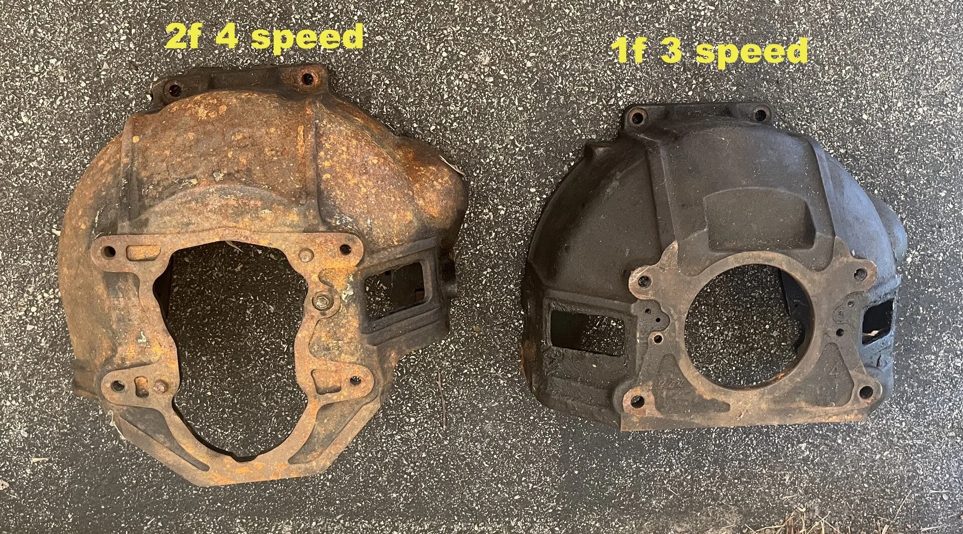

Hey I am sure this is already on the forums somewhere but - I am starting to buy parts for my eventual sbc swap back to a 1f or 2f engine. I want to keep the 3speed transmission so I can swap it back to column shift. I found a 2f bell housing with the clutch fork for a good price.
My question is will the 2f bell housing fit the 3speed transmission? and also would the 2f bell housing fit the 1f engine if I decide to go that way? Any issues with using the 2f clutch, flywheel and pressure plate with the 3 speed transmission?

2f bell will not fit with 3speed transmission. But will fit on 1f engine.
Your current three speed bellhousing will work with a 2F. That including everything thing else as long as you use the F engine flywheel.
Unfortunately it has a bell housing out of a 58 corvette at least what I was told, its 100% some sort of chevy bell housing with a thin adapter plate for the 3 speed. I actually need to check and see if the fly wheel is toyota or not. Anyway to do that through the inspection cover ? I need a bell housing so probably the best bet would be to get a bell housing for the 3 speed transmission. Not a 2f bell housing?
Quick easy way to tell what bellhousing works if the transmission opening is round it's a three speed. If looks like a figure 8 it's for a four speed but will work with a H55F five speed. If have a bellhousing E to mid 1963 it's a different bellhousing.
Thats a nice way to check thanks! I have seen one with the round hole for sale.

Picture shows everything :)
