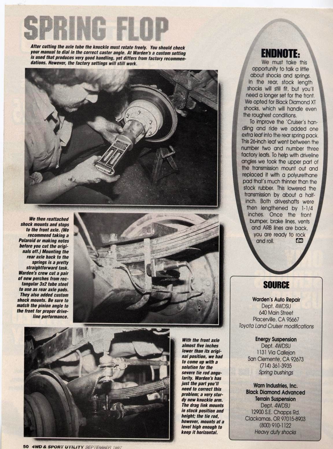

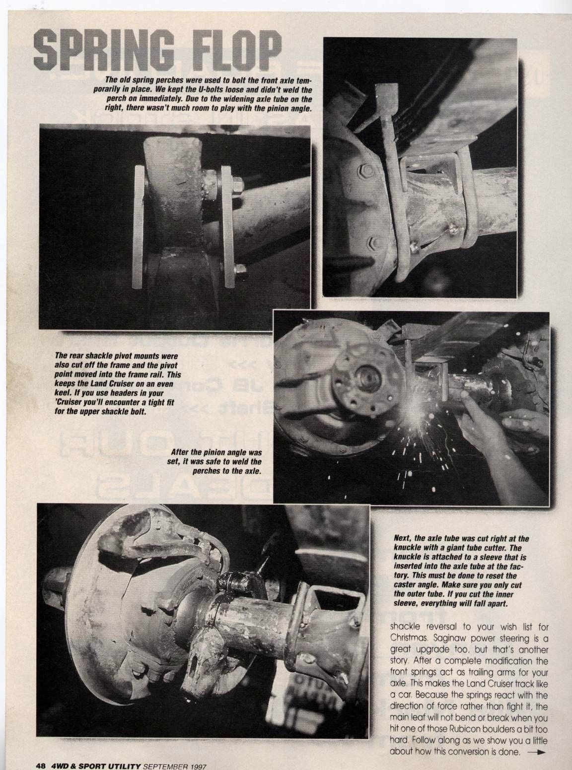

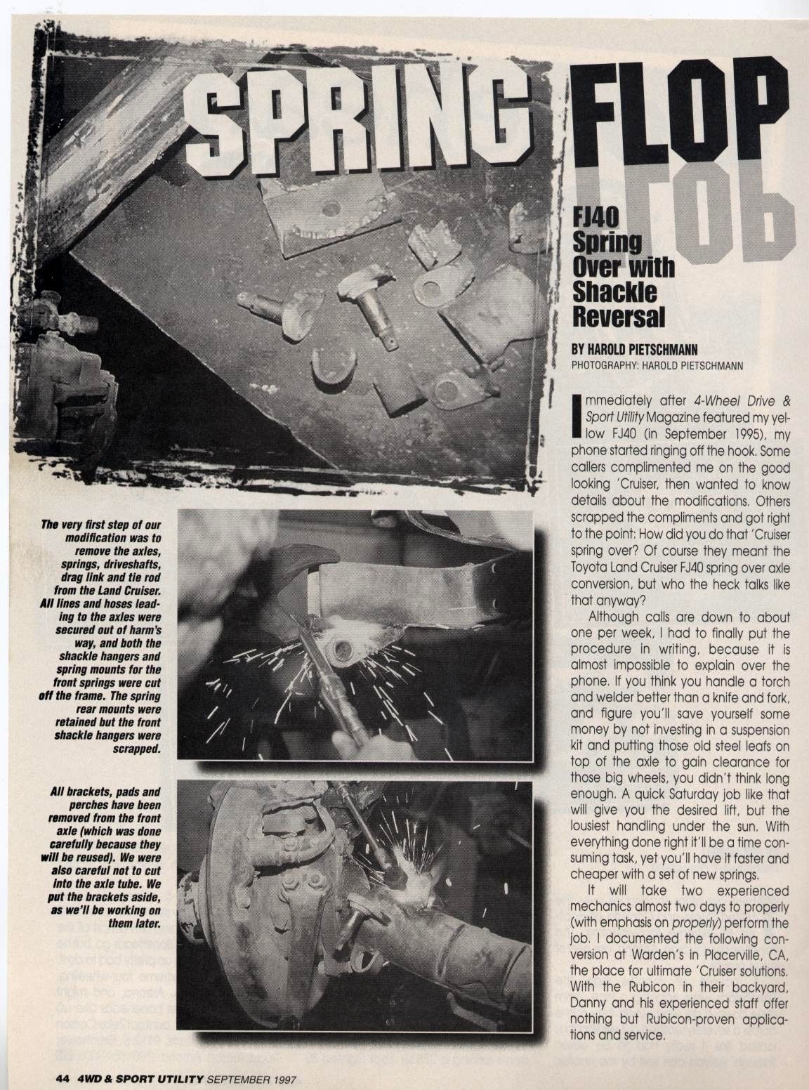

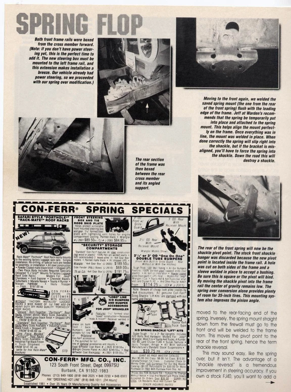

Before there was the internet ,found these old scans I had taken from my old magazines befor I chucked them.
This was what I used to do my First SOA and shackle reversal Back in the day.
Read a magazine and stared at the pictures. Lol.
Wow times have changed. I even had to call Warden to talk to him
About his special castor angle that they never mentioned in the article.
Lots of good stuff here on how to keep it low by sinking the hanger mounts up into the frame Rails Even on the rear of the rig.
I did not recess my rear spring mounts into the frame left them stock. Anyways
I thought some may like to read and learn some info about the SOA wardens way.
