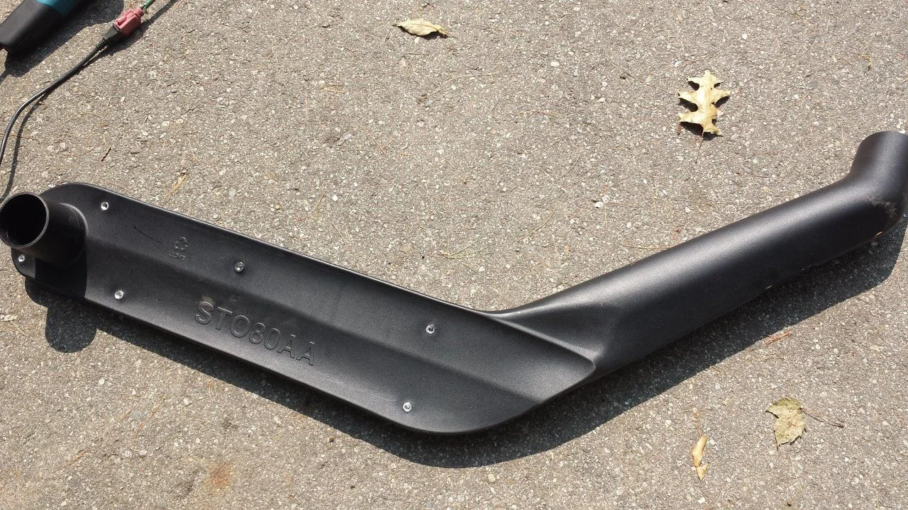

I bought a $100 snorkel on ebay, pretty decent quality. I broke off my right front flare (again) and decided to try to glue it back together and install the snorkel while I was behind the fender anyway. The snorkel went well, I have my doubts about the durability of the flare repair.
Snorkel is solid
Not sure if it was me or the template, but I wound up slotting my holes to get the alignment I wanted. The large hole was spot on. I used a 3 1/4" hole saw and wont up opening the hole a little with my cut off saw
The only other problem is getting to all the studs to get the nuts on the back. One of those deals where you could use one more joint in your arm. I don't have a factory antenna so that hole was accessable

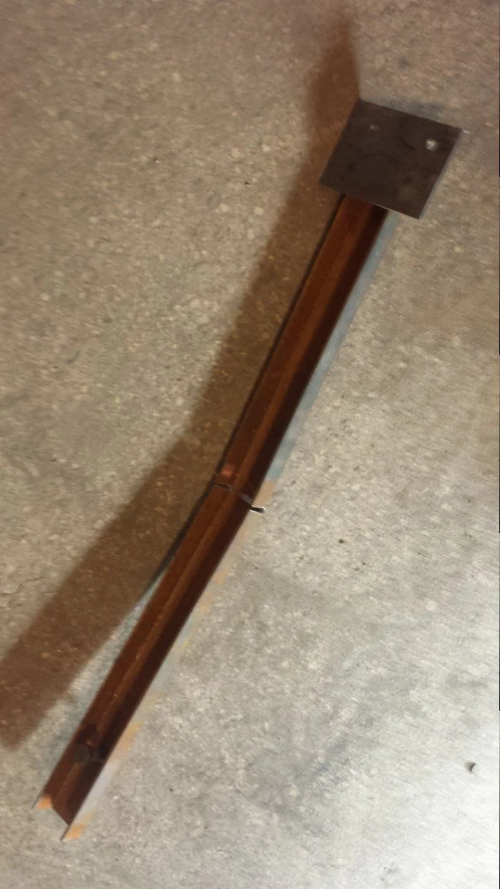

I have a bracket on the left rear swing out that used to have a jerry can holder. The po forgot to bring it to work where we met to seal the deal with the promise he would send it; yeah right, never happened.
Anyway, I decided to make a rack for the back that can haul cans, or a cooler, or what ever. Thinking about this size
Made a rectangle out of 3/16 x 3 inch flat stock and welded it up
I used 3 inch channel to connect to the bracket on the swing out and space the rack out from my hi lift mount. Connected that to 1 1 tube going under the rack to reinforce it.
