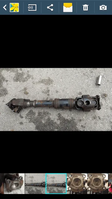

Building a new dc front driveshaft. Got this from a 95 4runner. The transfer case end has the wrong bolt pattern so a buddy at a machine shop welded up the holes, re centered it, and drilled the new pattern . Now it's at a drive train shop getting lengthened.Screenshot_2014-05-04-15-18-54.webpScreenshot_2014-05-04-15-13-54.webp Screenshot_2014-05-04-15-18-40.webp

Also got my 4runner dc driveshaft back and installed. Very tough fit with the skid plate in there. Runs as smooth as it did with just the rear shaft. Still might have to do longer lower arms for what seems like rear vibration. I'll pull the rear shaft and see if it smooths out fitst
Pulled the rear driveshaft to get it balanced before messing with control arm mods. Was out of balance a bit. Vibes are nearly non - existent but some there still
