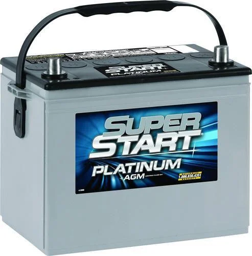

I was going to go with the Orielly's Super Start Platinum AGM because it seemed to be a rebranded Deka Intimidator but now I'm not sure. The Sear's Die Hard and the Sam's Club Duracell look exactly like the Deka while the Orielly's super start is a little off. I found 3 differences in the shell. 1) The 'band' around the sides by the top isn't the same, 2) it doesn't have the ridge on the bottom sides, and 3) it doesn't have that channel on the bottom middle. What do you guys think? Is the Orielly's a rebranded deka with a different shell?

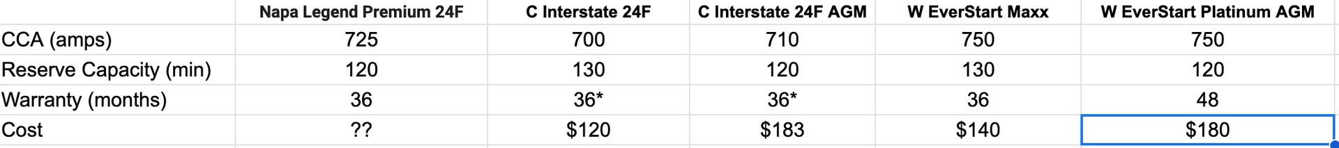

In case this helps anyone, here are some 24F specs/prices since I need to buy a battery this week. C = Costco, W = Walmart
I can't seem to find prices for Napa this time around. For reference, I bought a Napa Premium 24F for $120 in 2019. Since then the warranty has decreased to 36 months and I'm also reading the Costco warranty is weaker. Walmart options are largely out of stock in my area but I can drive a little and find the EverStart AGM.
