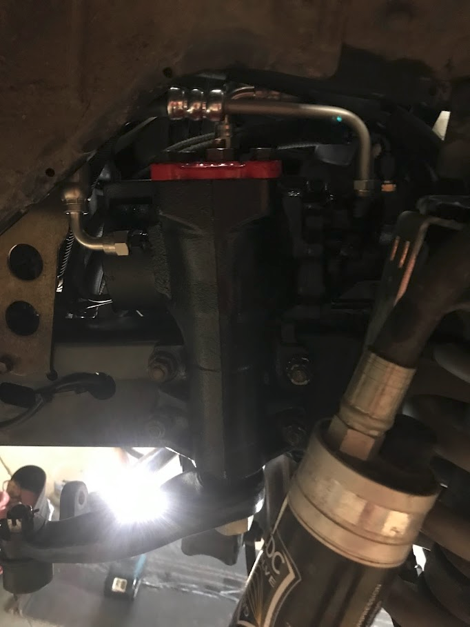

I'm ready to tap my steering box. Drilling the port through the Toyoda is pretty straight forward. I'm flipping a coin on whether to tap the front of the box or through the spine on the top of the box. The front of the box seems easier, but some people mention it is more difficult to package the hydraulic lines. Not sure of possible issues with drilling and tapping the top aside from drilling too deep.
What is your preference for an 80 series with the tie rod and ram behind the axle? Tap the front or top?
I tapped the top and it was a little creepy. I had to go pretty slow to make sure I didn’t drill through the vein. Buuuuuut also had to makes sure that I went deep enough so that the tap worked in a good taper. Overall, not a bad way to do it if you’re careful and the packaging is pretty good for the hydraulic lines
Redhead & Redneck ram both tap top front of the box.
Not a Issue Packaging the Lines for me I like to run the Hydro line line over the top and down next to the frame. That way they drop right on top of the ram.
Did you finish by using a bottoming tap or grind the end of a standard tap to cut the threads deep enough without hitting the bottom of the vein?
@Broski it looks like your second line is tapped through the top of the box as well. I think this is my plan.
