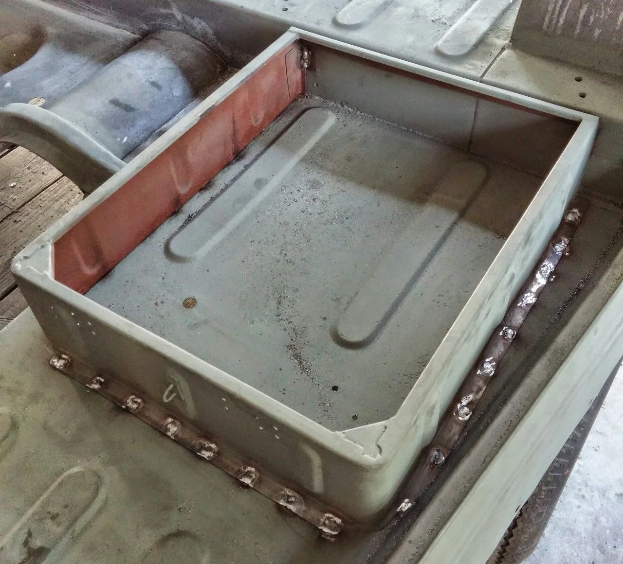

More pics. There was an aftermarket heater in this thing with a plastic box and a random rusted out blower sloppily installed. My Land Cruiser was not a factory heat model. If I re-use the aftermarket heater core, I'll bend a decent looking box in sheet metal, and install it level.

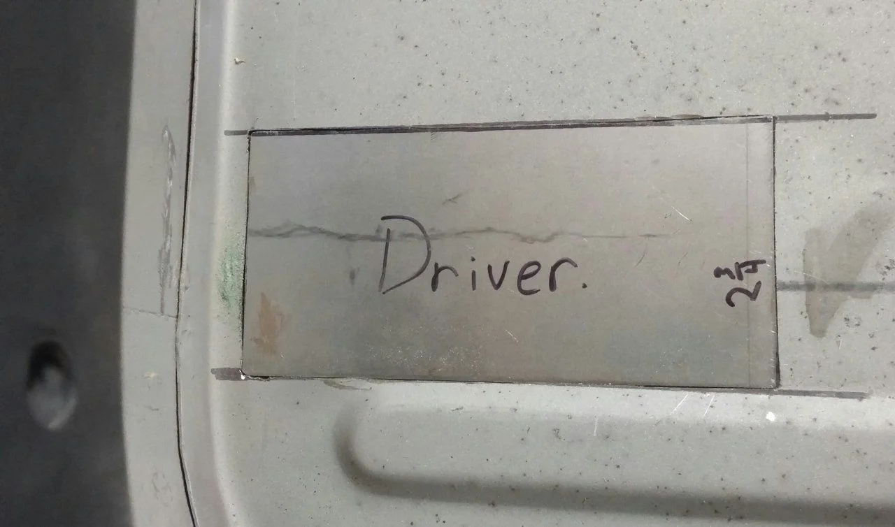

I welded the crooked holes so I could start fresh at a later date.

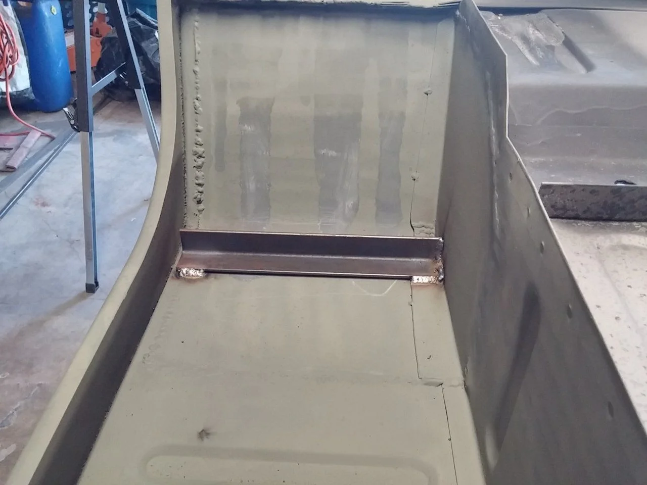

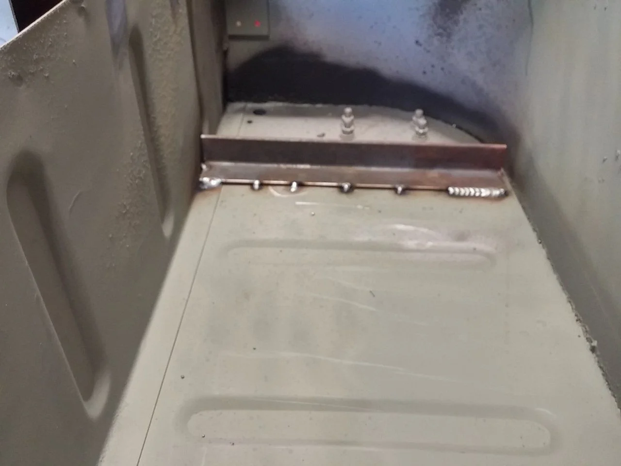

More patches going in the tub. I'm leaving for vacation tomorrow, but there's a chance I'll prime the bottom sometime the week of my return. I replaced the jump seat braces with 1.25 angle. I figure it's strong, simple, and offers a place for mud flap mounts, should I choose to go that route.
I figure I'll seal it all up with body seam sealer to prevent future rusting between braces and panels.

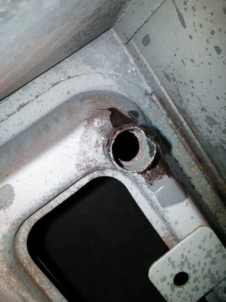

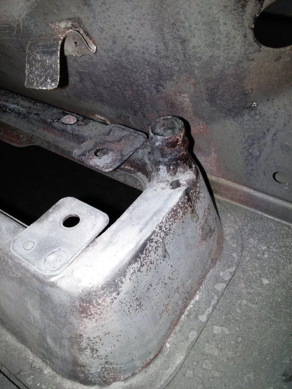

I'm getting close to priming the bottom of the tub. Today, I did some final prep. Since the tub is upside down on saw horses, I took advantage of the opportunity to check out the underside of the dash. The drains for the cowl vent were clean from sandblasting, but perforated from rust. I couldn't get in there easily to repair by welding, nor could I come up with a reasonable idea for replacement nipples. I just sealed the holes with epoxy. Here are some terrible pictures.

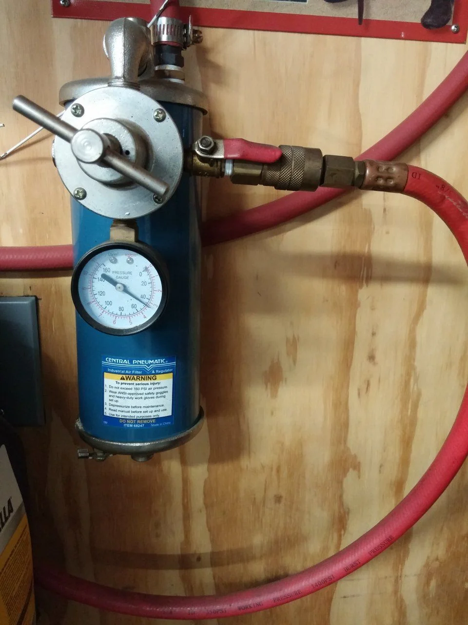

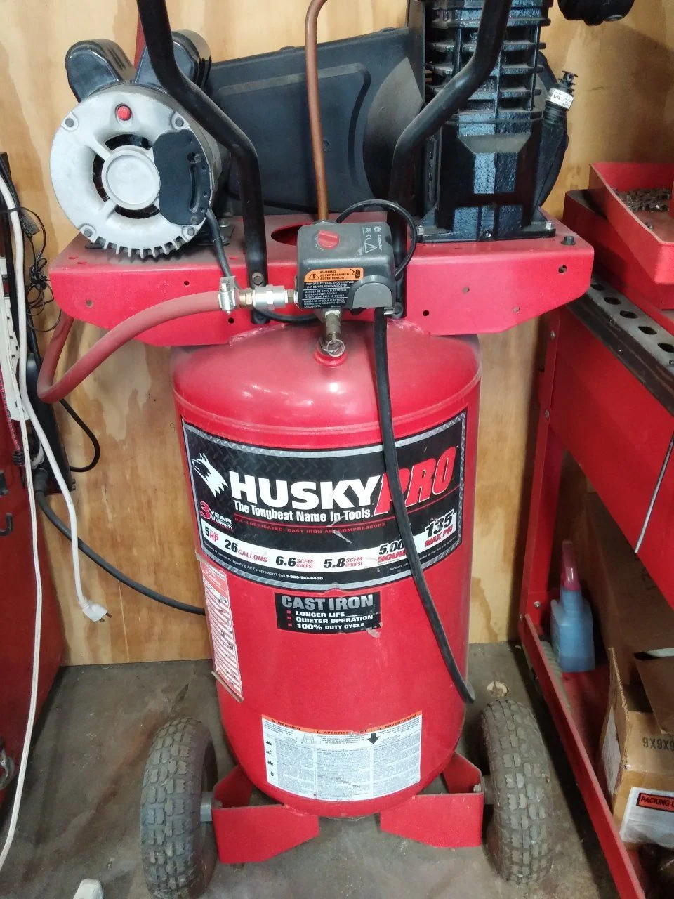

I'm using a 26 gallon compressor with a 120v 5 horse motor that drives a 2 cylinder oiled pump.
From the tank, I ran 50 feet of 5/8 ID hose in the rafters across the garage into a Harbor freight separator and regulator.
Over the course of the project, I've been spraying with a Campbell Hausfeld gravity gun, but I recently purchased a kit that contains three guns that are true HVLP with different tip sizes made by Vaper (from Northern Tool). I use a desiccant dryer at the gun regulator and have been having great results. I painted my wife's hood and a few odds and ends with them. I actually just primed the underside of the tub with the 1.7mm gun. See next post...

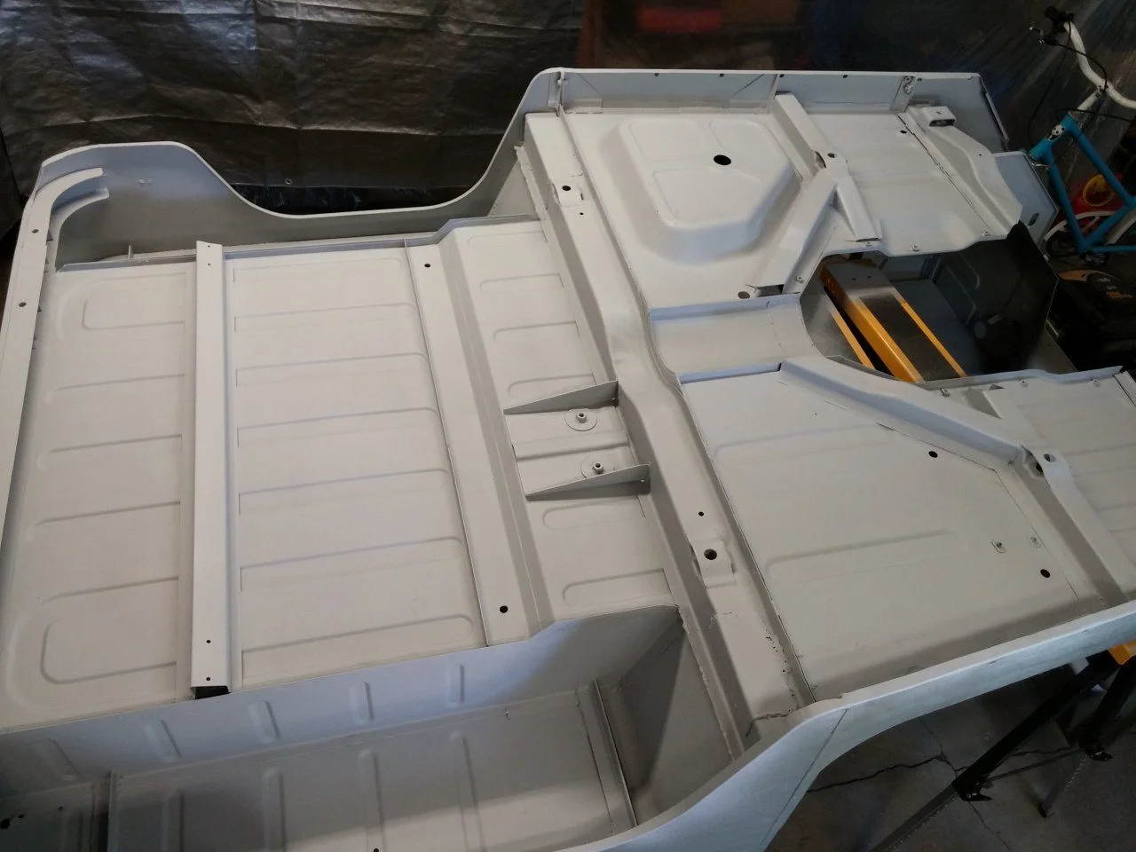

I primed the bottom of the tub with Advantage 325 2K DTM primer. Gray Durabak is on the way for undercoating.
Once undercoated, I'll turn everything over and prime the rest of the tub. I plan on applying Durabak to the top side of the floorboards as well for waterproofing, traction, and sound/heat management.
