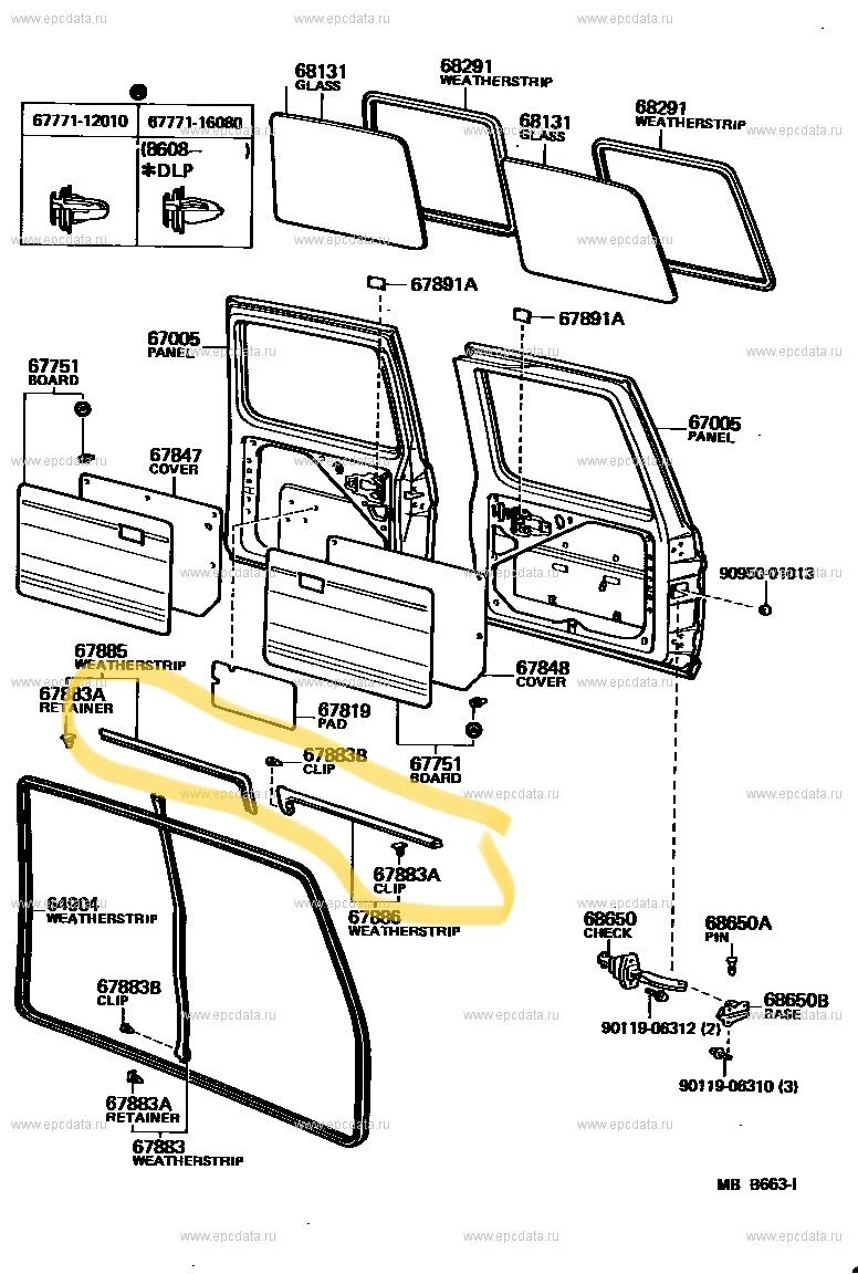

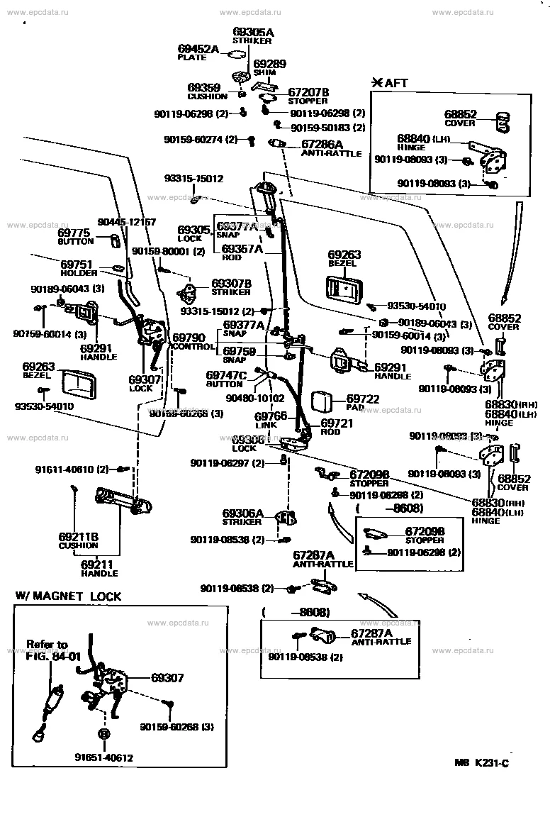

I’ve debated these for awhile. Is there a diagram w part numbers?? I can’t find one, partssouq or anywhere. I can get the doors but I’m concerned about getting new rubber bits etc
This is actually a huge question.
I have diagrams (attached below) that I’ve found from different websites (also listed below).
New rubber is a whole other ballgame though. Here's what I've found:
Toyota Rubber Part Numbers for Barn Doors:
Centre rubber Seal: 67884-90A00
Right Hand top rubber: 67881-90A04
Left Hand top rubber: 67882-90A00
Full Rear Main rubber Seal: 67881-90A08
The main large rubber seal is available in the US here: Back Door Surround Weatherstrip for Non-US Land Cruiser FJ60 FJ62
Centre rubber Seal that goes on the back left door in the US here: Rear Back Left Door Weatherstrip 81-90 [67884-90A00] - $46.33 : CruiserParts.net, Toyota Landcruiser Parts
We got used right and left top seals from the Netherlands (These are the hardest to find, they've been out of production for a long time): Home - CruiserWorld
I found the following diagrams on these websites, if you click on the numbers next to each part you can get full Toyota part numbers and then search for them:
On top of all the above I found an anti rattle fitting and a top striker plate on cruiserparts.net
