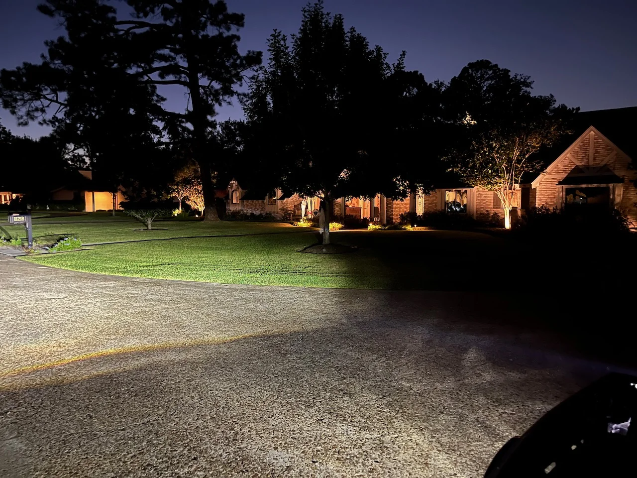

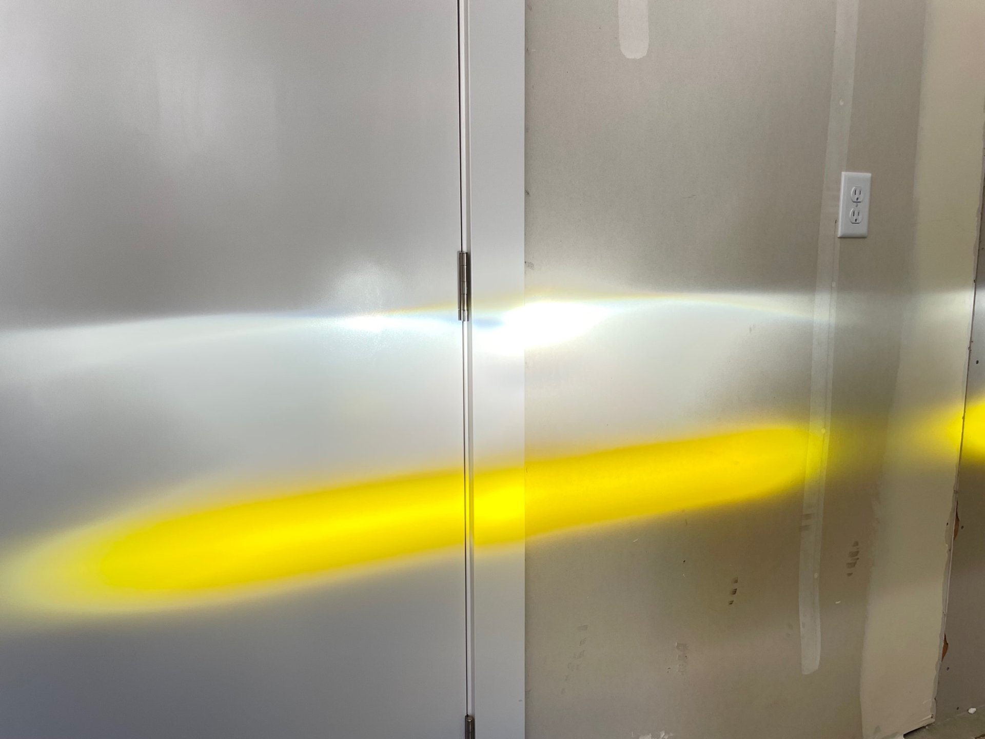

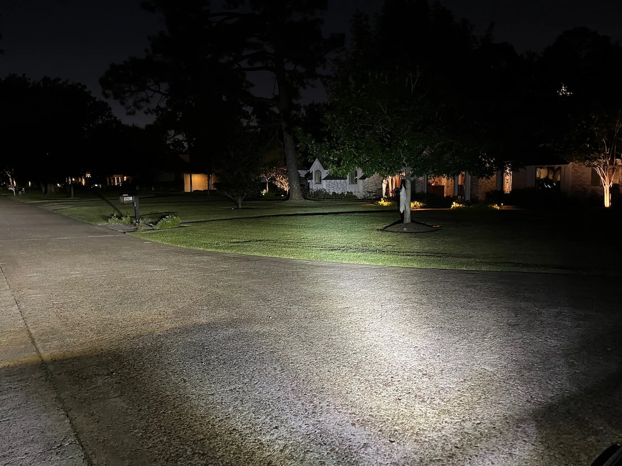

For anyone looking for another alternative the DiodeDynamics kits are almost identical and their DOT/SAE lens has a razor sharp cut off. The pro's are insanely bright but the cut off is low enough that I never get flashed by other drivers. These are truly a fog lens, if you are wanting something to augment your low beams these are not it, they cast a very flat wide beam which is incredibly effective in actual fog rain and snow but if you aim them up so the cut off is level with your headlights the bottom of the beam won't even be illuminating the road where you need it most in adverse weather conditions. I leave them on always.

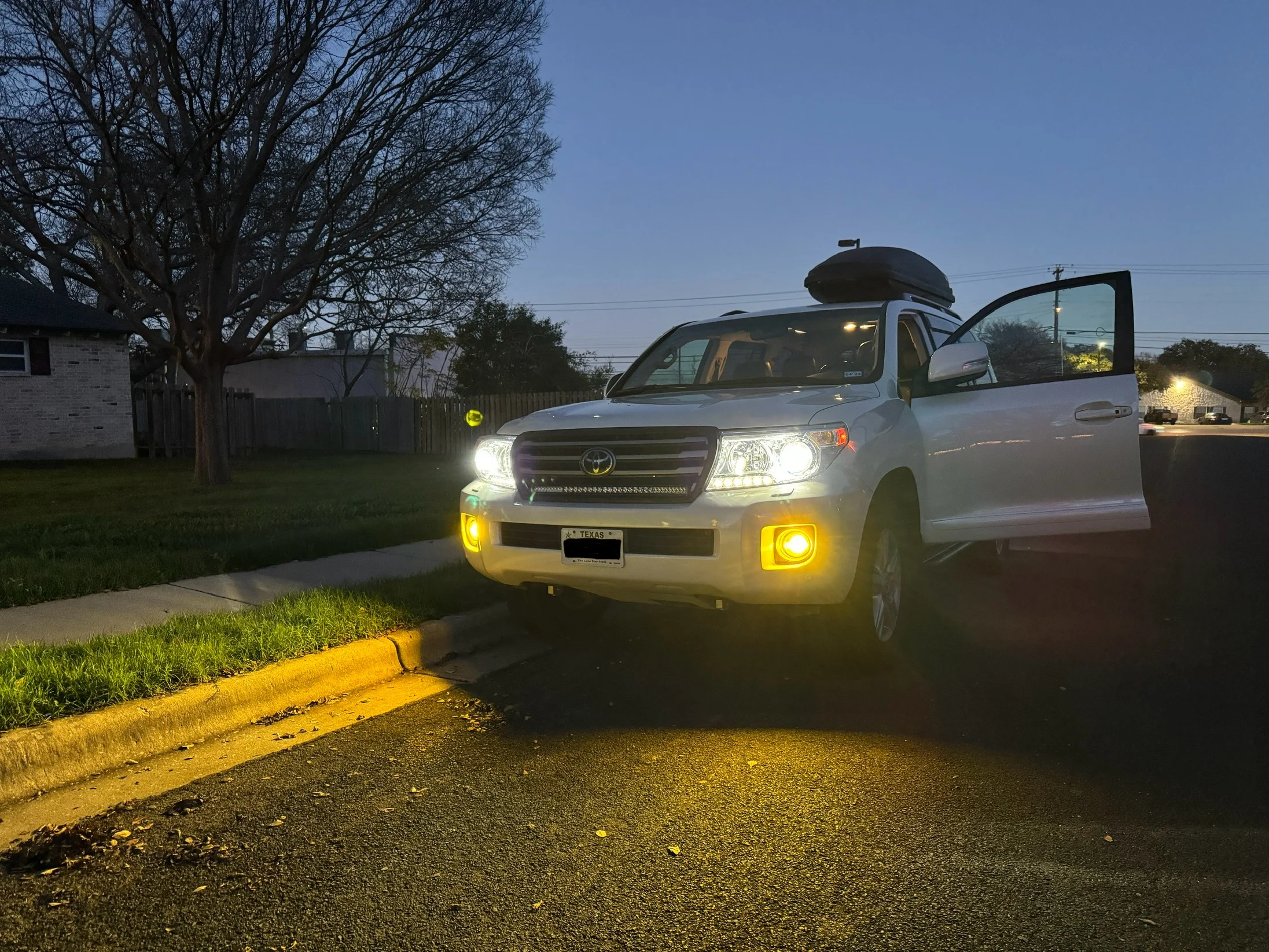

Love the output, is this the Tundra Max kit?!

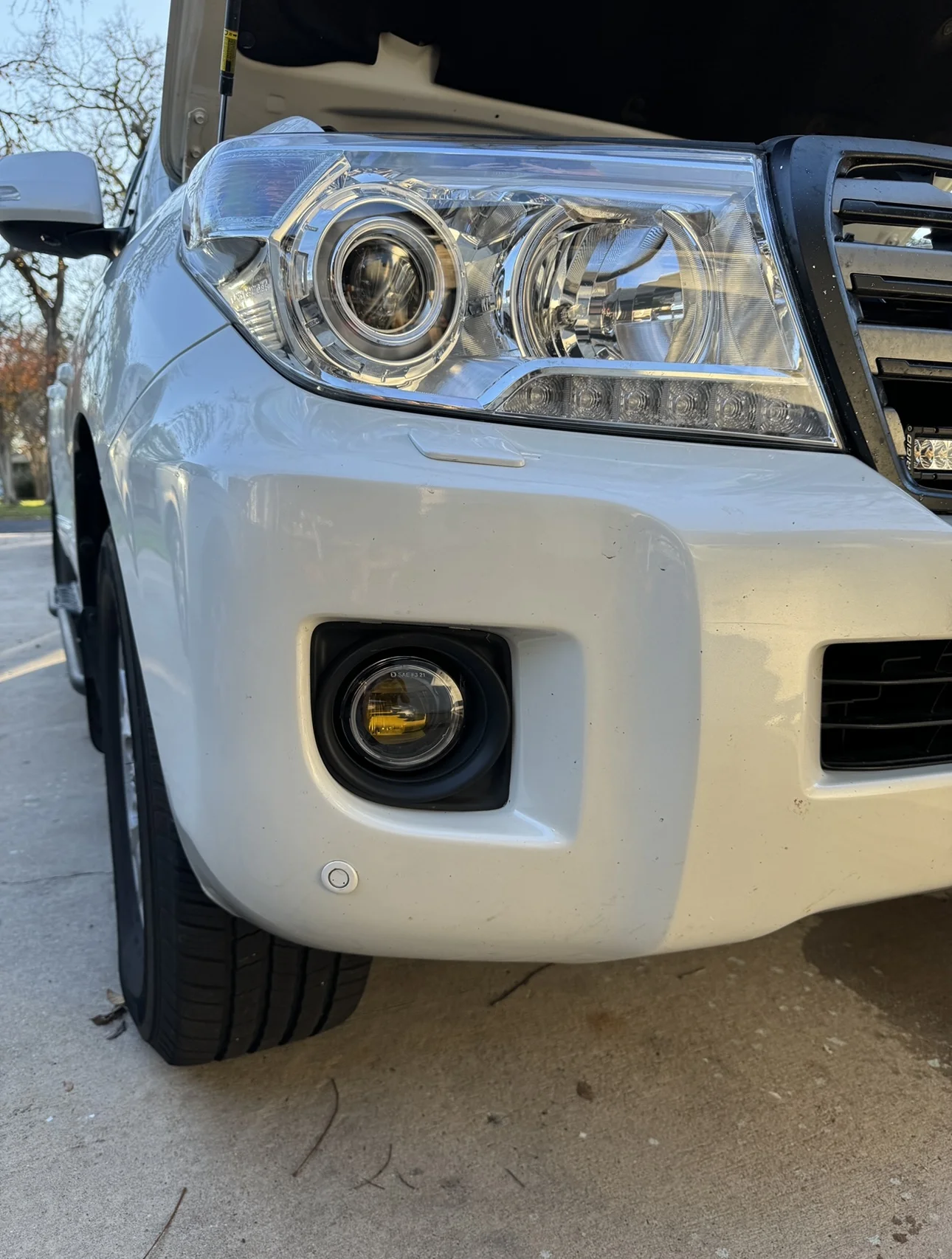

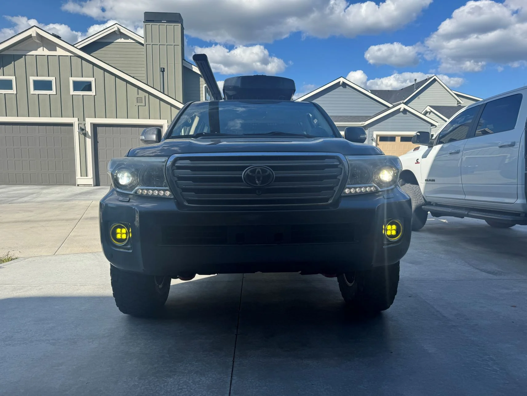

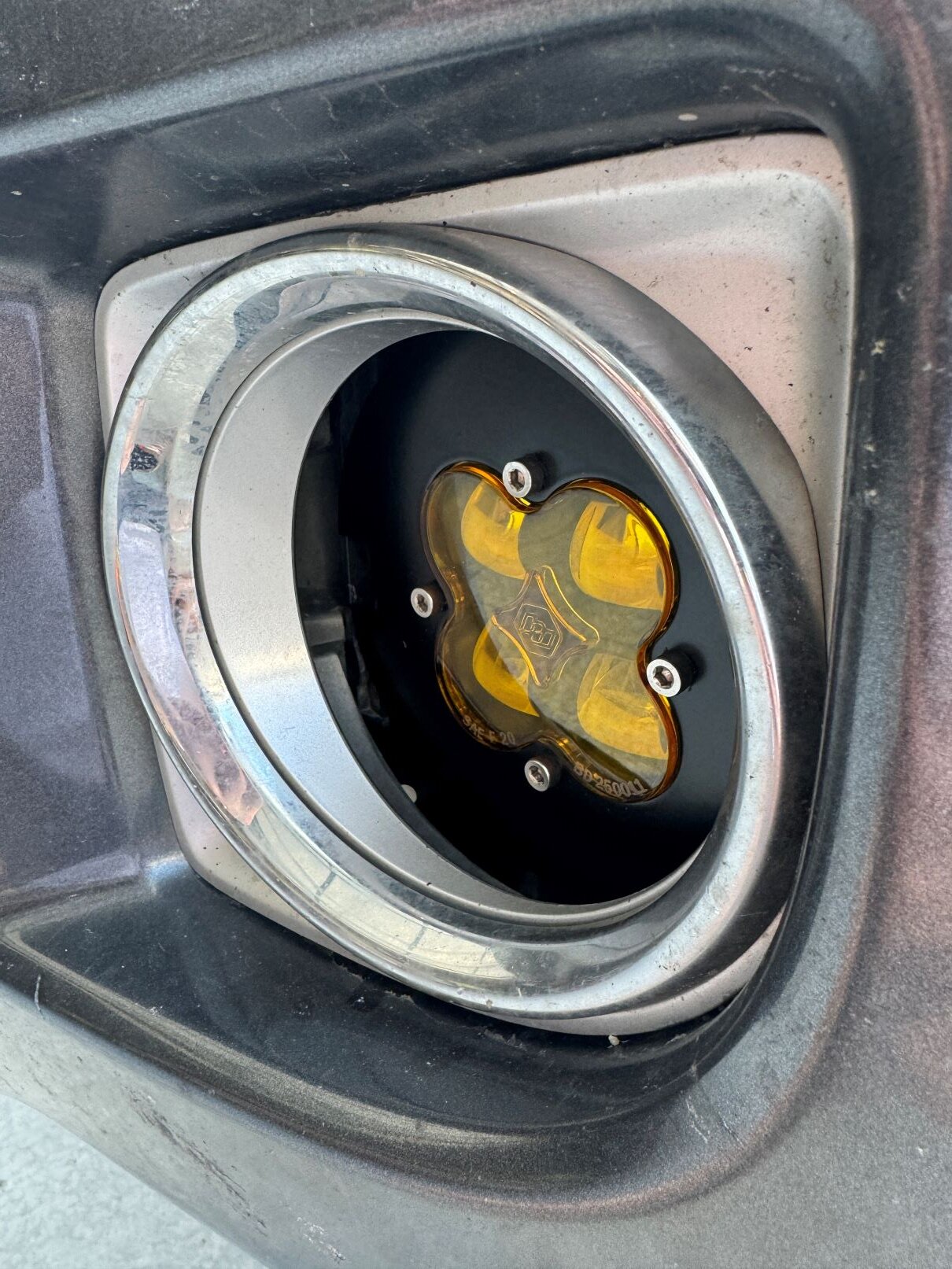

Here is the stats from my order: "SS3 LED Fog Light Kit for 2016-2021 Toyota Tacoma, Power Level: Pro, Lens: Yellow SAE/DOT Fog" this kit was direct plug and play for the 2013 LX570 stock fog locations. However when I installed my IronMan front bumper I ordered new Flat/Round light bezels. The ones in the Tacoma kit have an angled bezel that would have looked a little weird in the IronMan.
This definitely wasn't a plug and play install for the IronMan bumper. I had to modify the bumper itself and grind out a fair bit of metal behind the fog location and make my own brackets to get them in there and flush. VERY happy I took the time though, I LOVE these fogs.

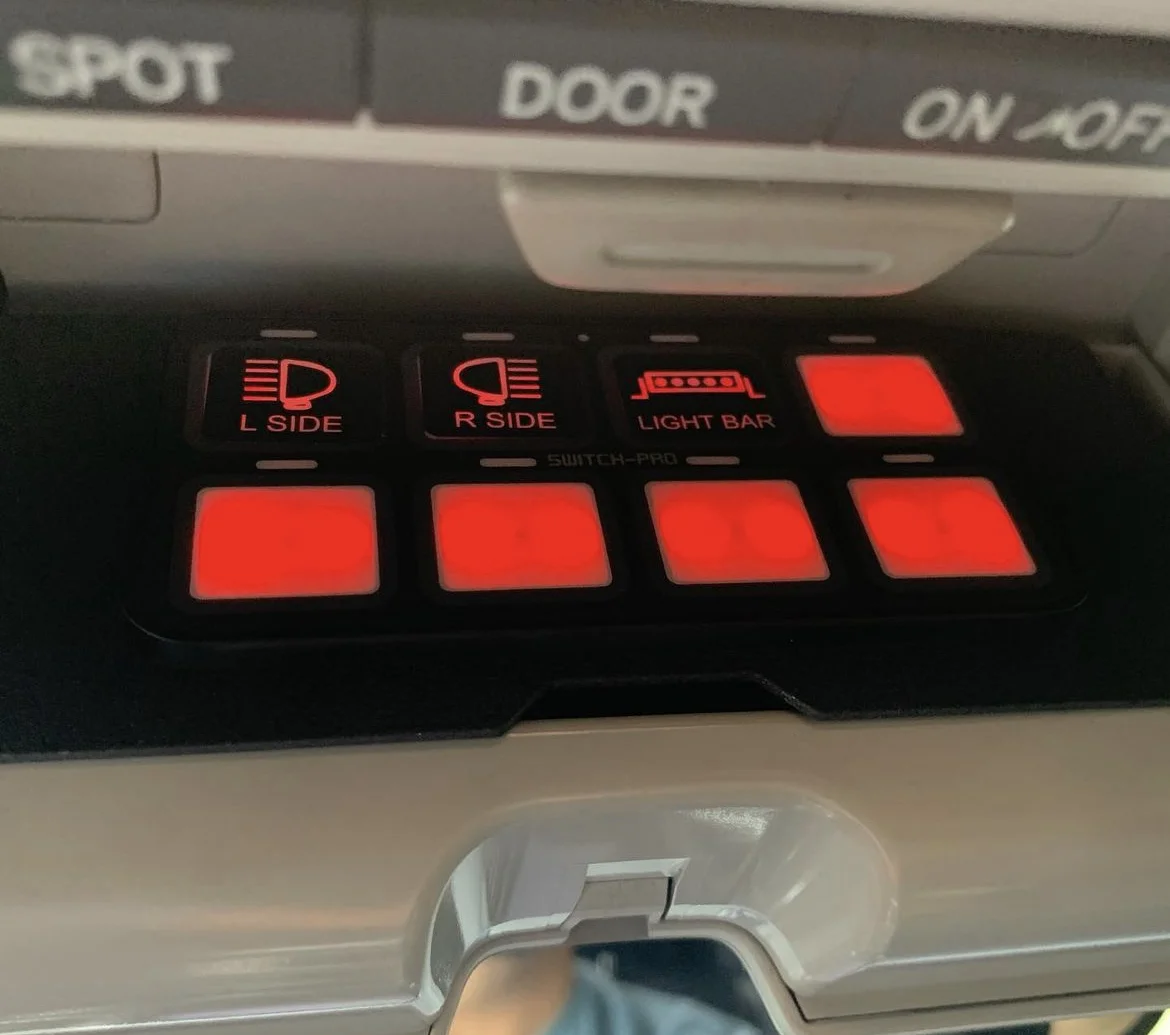

I use the SwitchPros SP-9100 panel for my aux lights. All of which are dimmable.
"Lighting outputs can dim from 100% to 10%, with ability to dim during Flash or Strobe patterns"

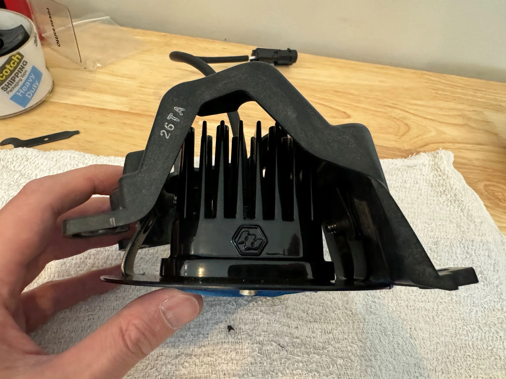

An update to this and I hope it helps someone else as well. THEY DO FIT. You just need to bend the brackets a little bit (like an s-curve) and retain the factory plastic fog light bezel.
This was the kit I purchased

Diode dynamics Elites can be made to work on 13-15 as well with some simple brackets. And it retains the ability to set beam height precisely using the DD adjustment screw. Still working on finding my notes with the dimensions..
