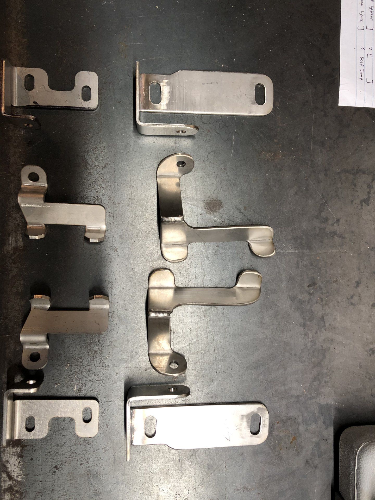

BD doesn't have a mount that fits the '13 land cruiser. I had a local shop fabricate brackets out of stainless and used the Tacoma angled hood to fit them in my '13.
They were not cheap since they are one off and based on the hourly shop rate.
Left side are the BD Tacoma mounts, right side are the fabricated ones to fit the '13.

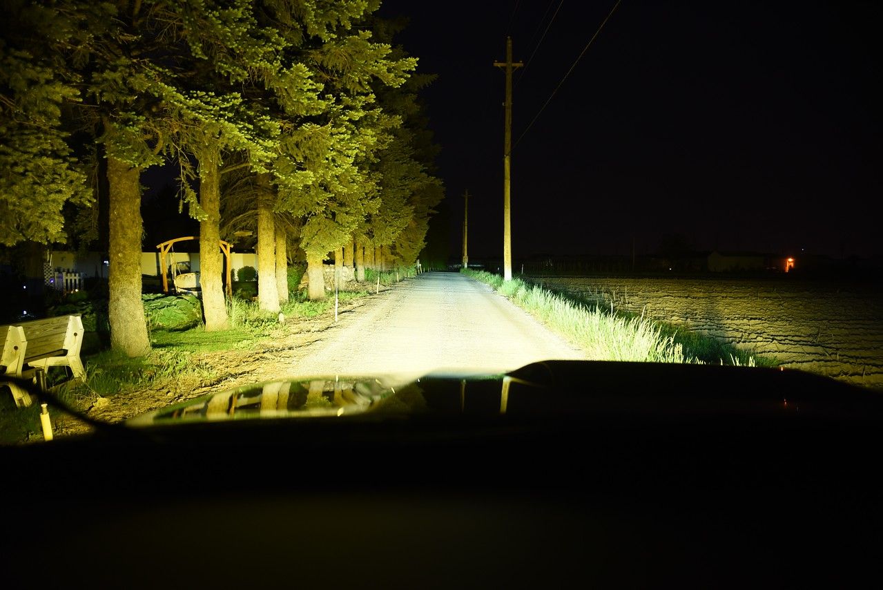

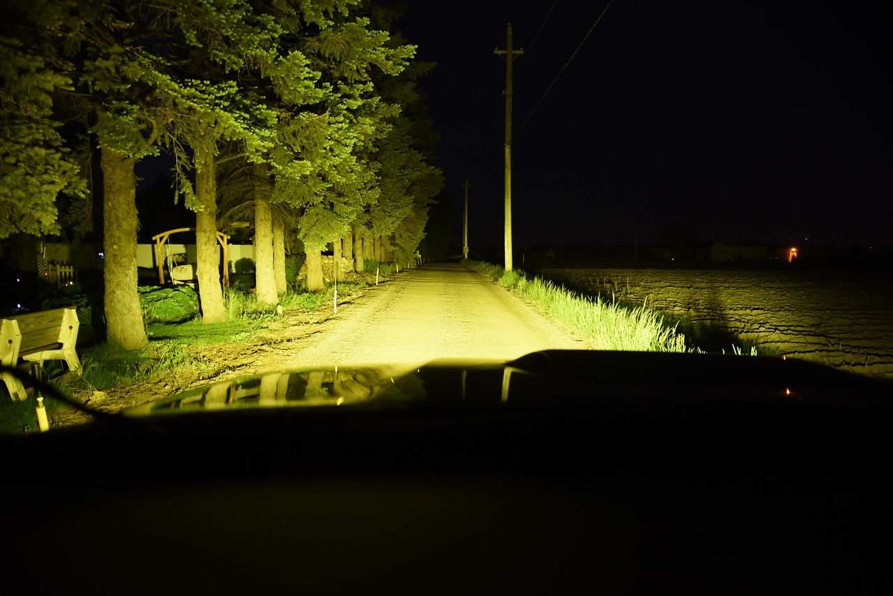

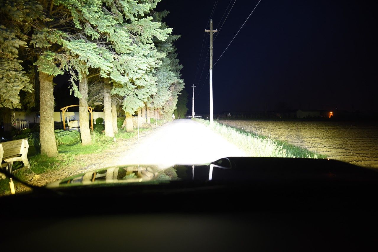

Not exactly what you were asking for, but at least a comparison to other lights. Camera set in manual mode with manual white balance to give true comparison. These are on my 2016 4Runner.
Xenon Depot HID low beam only
Baja Design Squadron-R Pro Amber Wide Cornering only
Xenon Depot HID Low Beams and Baja Design Fog Lights
OPT-7 32" LED Light Bar on Prinsu Rack only
Xenon Depot HID Low Beams, Stock High Beams, Baja Design Fog Lights, and OPT7 Light Bar
Nice pics there and they really do well to convey the pattern, intensity, and contrast differences. Makes me want to apply a yellow filter or lens to my aftermarket Rigids as the contrast is just awesome.

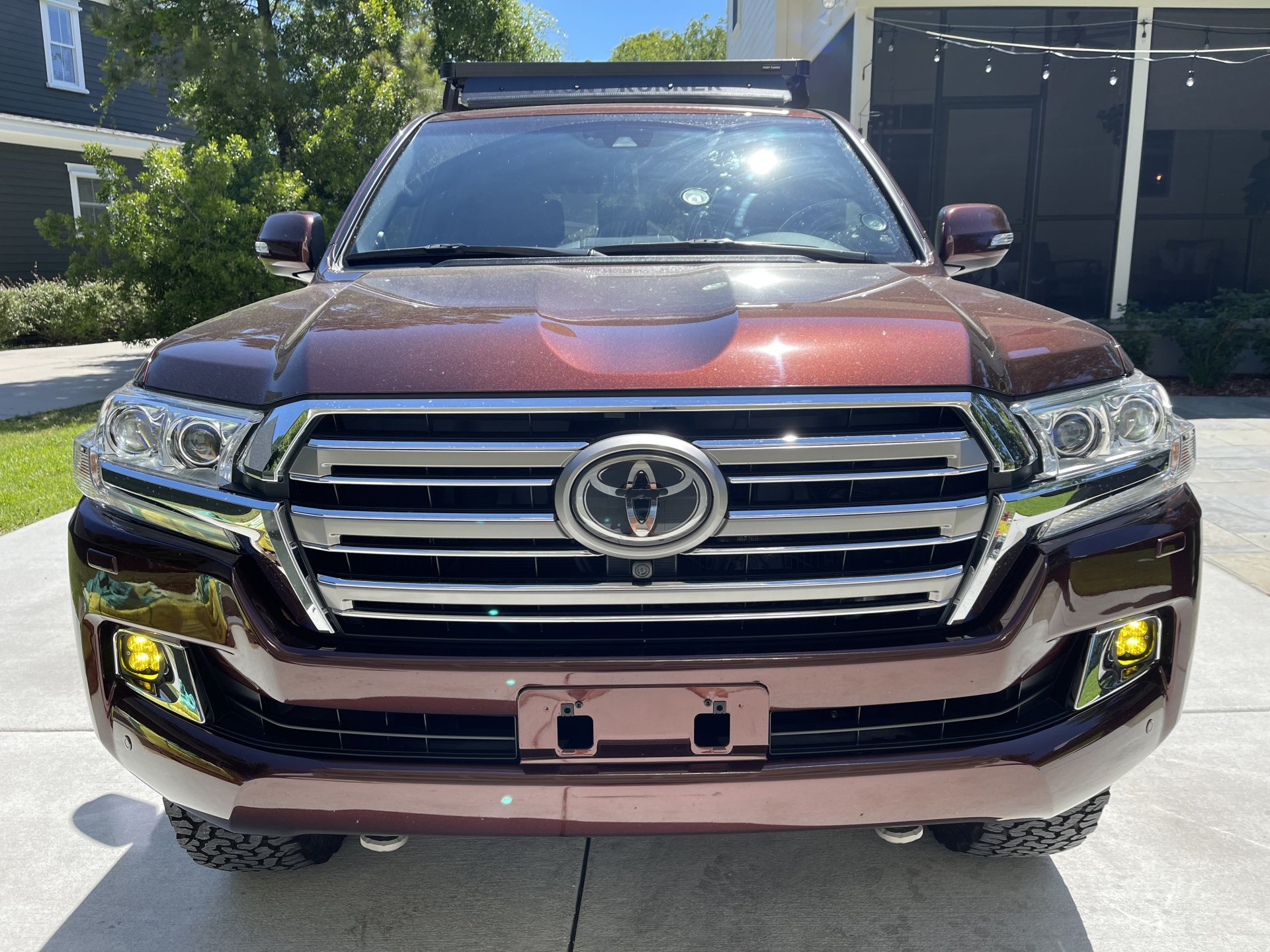

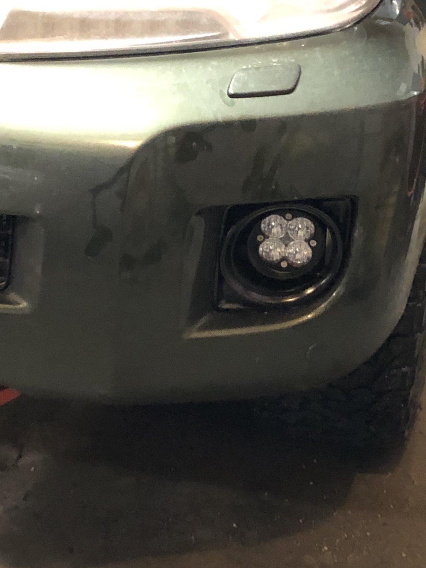

I've added close up photos of the BD lights with the black shroud still installed. I know you asked about Rigid light fitment but maybe this will help with fitment questions...

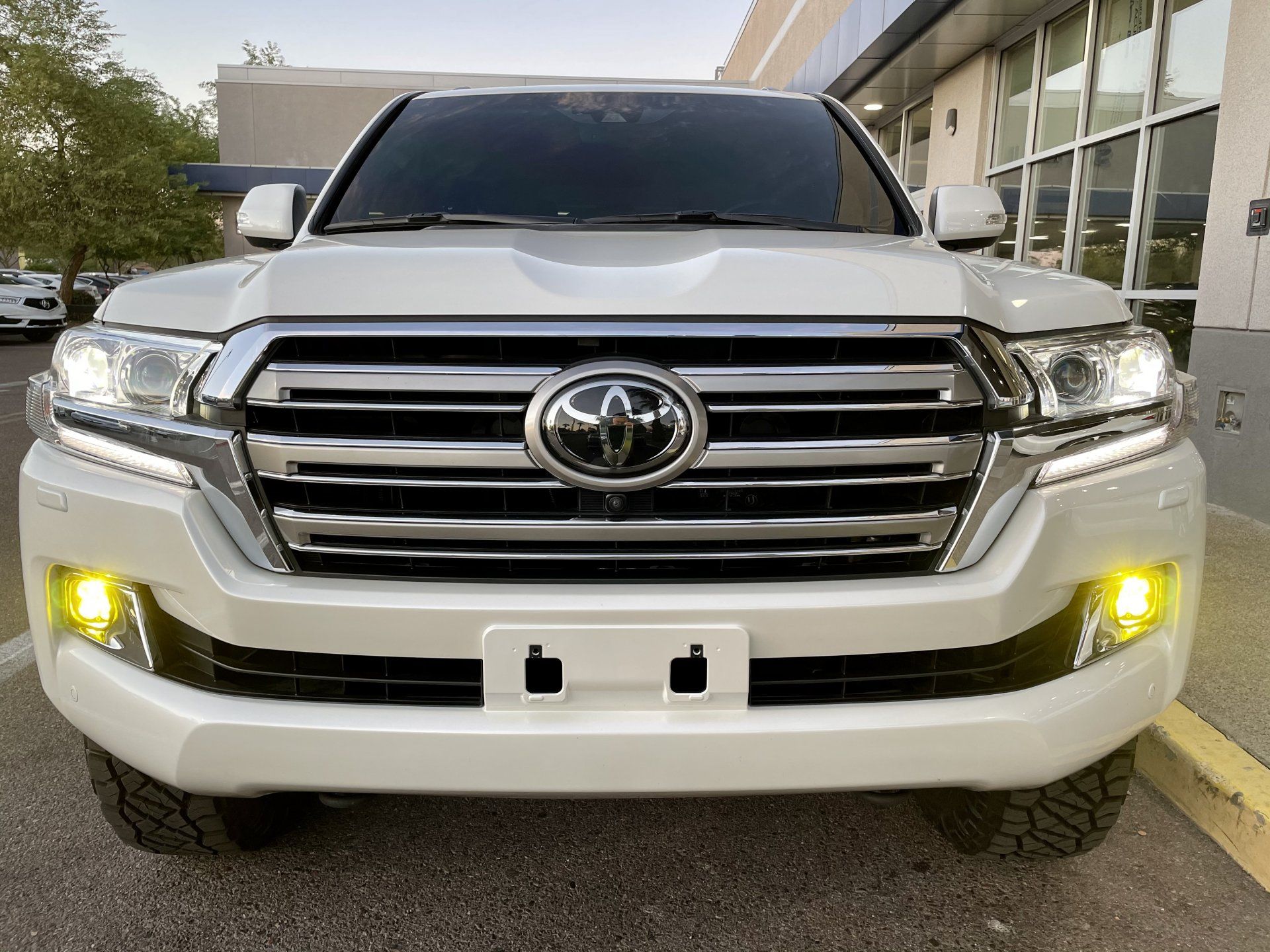

Finally found a solution with the help of a local shop (SDHQ) I’ve been looking for an alternative to the factory fog lights. I put on the squadron pros and used the bezels they included in the kit for a clean fit. It is the tundra fog light kit. Hope this helps for anyone else that has been looking!

Mounted mine up today!
