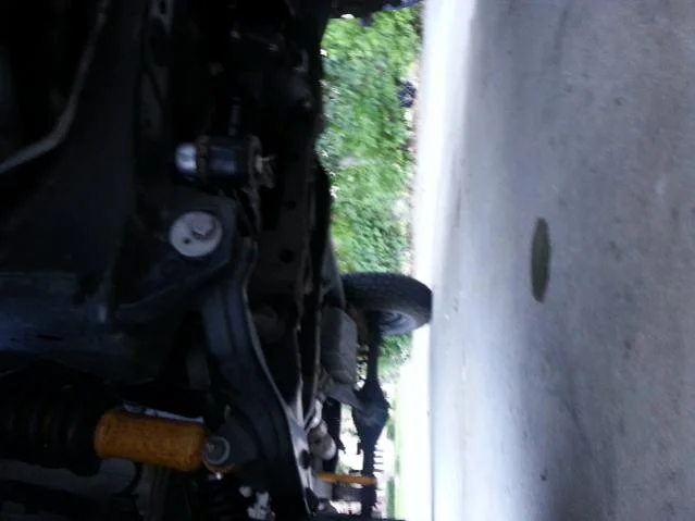

Sort of an update.... Been collecting parts for quite a few months... Actually started tearing the truck apart today.

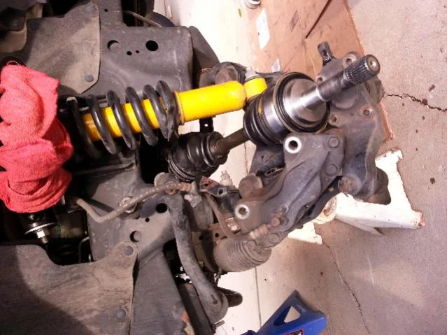

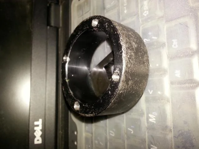

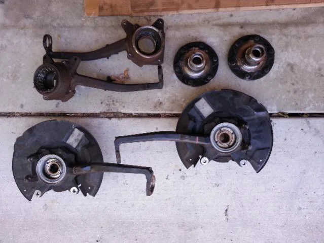

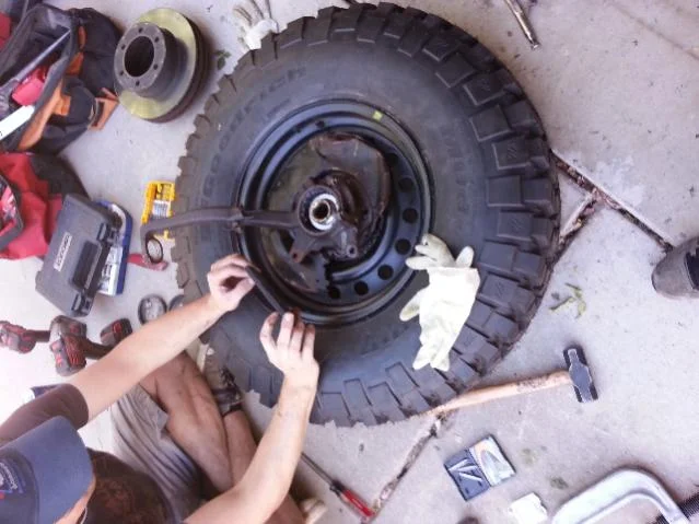

Having a bit of trouble with the spindles/hubs. Can either use the manual spindle setup as-is that's a quite a bit rusty and well-used...or press the hubs out of both manual spindles and my prerunner spindles and then press the manual 4wd hubs into the nice prerunner spindles (the spindles are all the same between manual, ADD, and prerunner--its the hubs that are different). Problems I've ran into are the broken off bolts for the lower ball joints in the rusty ones (and they're rusty and need cleaned up) keeps me from just throwing those ones right in. And to swap the hubs to the prerunner spindles, I gotta undo the 200ft-lbs torqued down hub nuts and get the hubs all pressed out and in and the hub nut tool i bought from OTC is a POS and broke and I don't have a press so I gotta find someone with one or a place to do it. I really want to swap hubs though so working that angle for the next day or so. Hoping to be able to fix up the hub nut tool and I got a couple lines on a press.
Anyway, truck is down and out for the current. Hopefully get the front end back together in a couple days cause everything else is ready to go in. Gonna tackle the tranny/tcase swap in a week or so.

I'm over it and will just be swapping the 4wd manual hubs onto my prerunner spindles for sure...once I find a press...
Got the hub nut wrench/socket all fixed up today with some solid pins and gonna give it another go. Only have one last bolt to break free and then can start pressing hubs out.

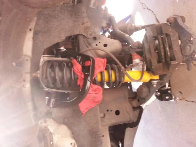

Got the old upper arms removed today as well and the new light racing uppers installed. Should go pretty quick once the press work gets finished.

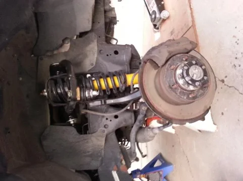

Hubs all swapped around.

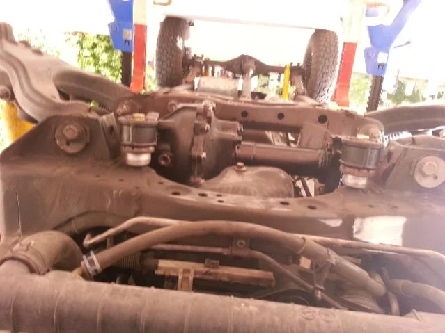

Diff installed. (No idea why this is upside down. Stupid phone or something. I'll fix it later.)
CV installed.

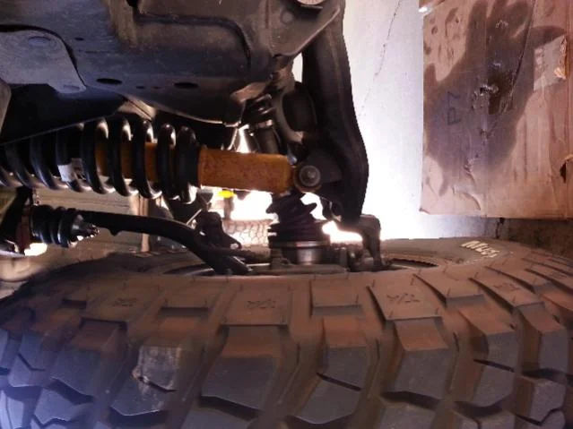

Spindle installed. Lockout installed.
Front end is almost all together. Should be able to drop it off for alignment Monday morning. Looking to start the tranny swap next weekend.

Thanks man. The front really wasn't that difficult other than messing with the hubs--and if you found a nicer condition donor, you could possibly just swap the entire 4x4 spindles in and not even worry about swapping the hubs around (I also went with brand new bearings and seals all around while I was at it though).
To swap from ADD is about the same amount of work. At the diff side-tube, you either have to clamp off the vacuum actuator so the stub shaft stays engaged fulltime, or swap out the actuated side-tube for a manual side-tube. Then you have to have manual CV axles as they are different than the ADD CV axles, then you have to also swap to manual hubs since they are also different than the ADD hubs (so pressing them out and changing them like i did, or swapping out entire spindles), then of course you need the manual hub lockouts too. Then you also may need to do something about the electrical for the transfer case as its most likely wired to receive an engagement notice from the original front ADD tube.
So ya, just about as complicated. And I've also heard/seen many folks say the manual CVs are actually weaker than the ADD CVs (a smaller tripod I think).

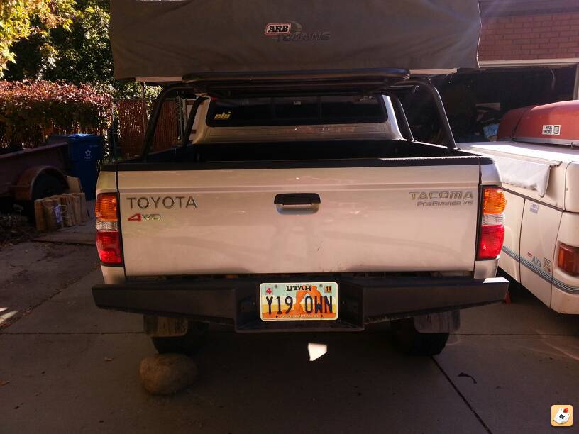

Stopped by your friendly neighborhood Cruiser Outfitters this morning and got a nice new ARB snorkel installed. :)
Also picked up a hardly used ARB Simpson III off a local guy. Just need to give the cover a good cleaning. :P

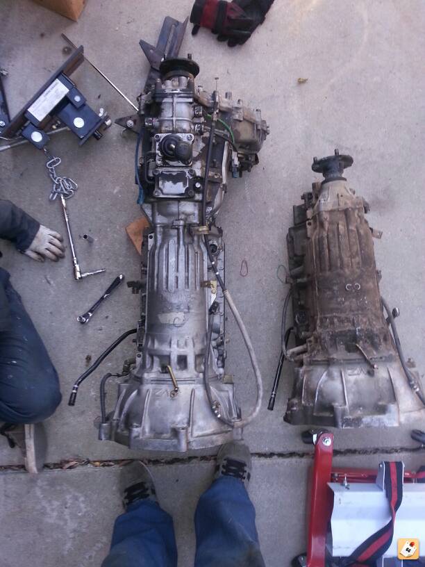

Still waiting to get the tranny and tcase in.

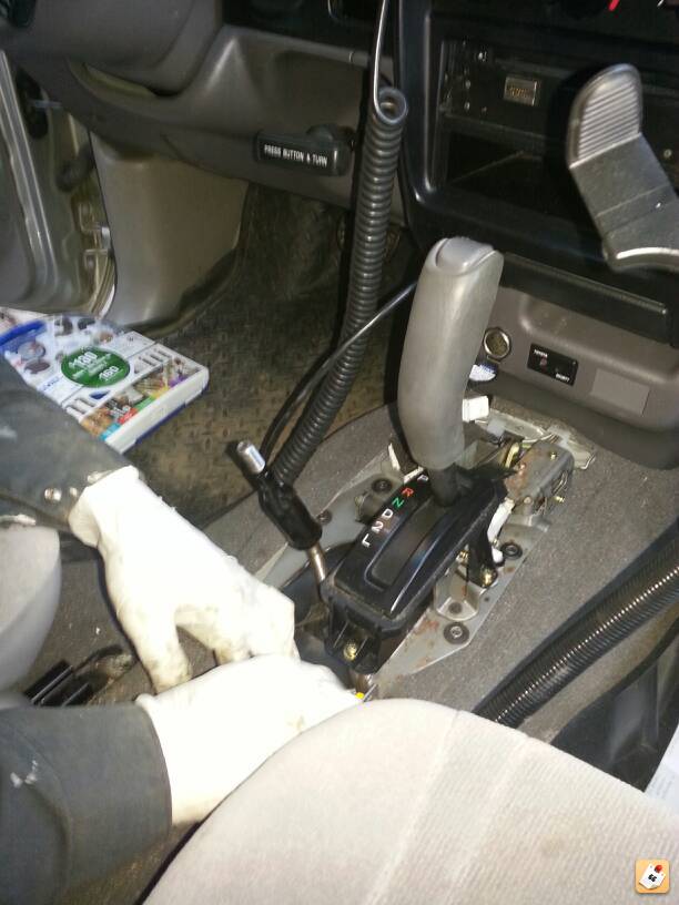

Inside back together. Anybody have a gray j-shift handle they want to trade for my black one?--i don't like the black...

So so close. Could be driving it if I would have gotten the correct tranny mount... Oh well. Couple more days.
