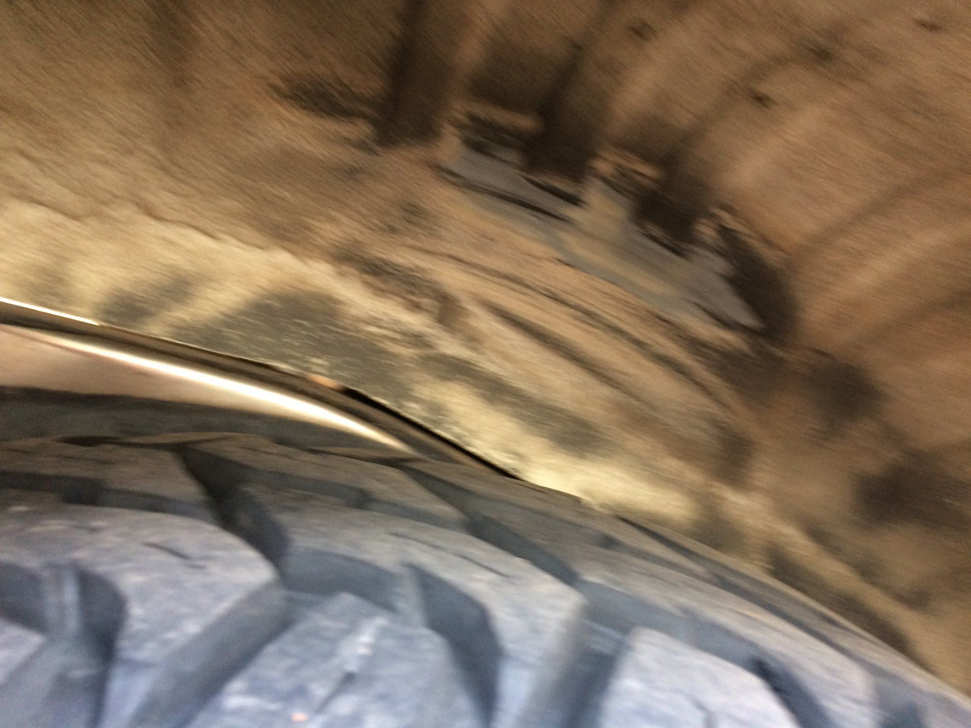

The higher you lift an 80, the farther the panhard rods move the axles laterally, moving them off center. If you use an adjustable panhard rod to recenter the axle after the lift is installed, then the axles will NOT be centered anymore when you flex/compress the suspension. This will result in less clearance between Tire and fender or frame. My panhard length is nearly stock. It positions both of my tires when flexed to be centered in both fenders. I get very light rub marks on the frame and fenders that are virtually identical. But, my tires are NOT centered when sitting parked on flat ground. WHO CARES? You really can’t notice it from the driver’s seat!
View attachment 1742801 View attachment 1742800 The higher you lift an 80, the farther the panhard rods move the axles laterally, moving them off center. If you use an adjustable panhard rod to recenter the axle after the lift is installed, then the axles will NOT be centered anymore when you flex/compress the suspension. This will result in less clearance between Tire and fender or frame. My panhard length is nearly stock. It positions both of my tires when flexed to be centered in both fenders. I get very light rub marks on the frame and fenders that are virtually identical. But, my tires are NOT centered when sitting parked on flat ground. WHO CARES? You really can’t notice it from the driver’s seat!
I get identical frame rail rubs on each side of the Cruiser with my adjustable panhard.
