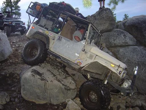

What size tires you running?
36 x 14.50 x 15 -- But I run heavy. Fully loaded for a week on Rubicon, I have about 3" of rear clearance. Full family cage, top rack, etc.
