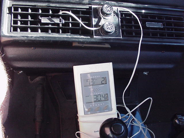

My old 40 series AC output on R12 30.4°:flipoff2:
mvc-585s-jpg.87067
mvc-585s-jpg.87067
Yeah.....I miss R12 refrigerant. I have 2-3 cans sitting on my shelf in my shop from bygone days.
