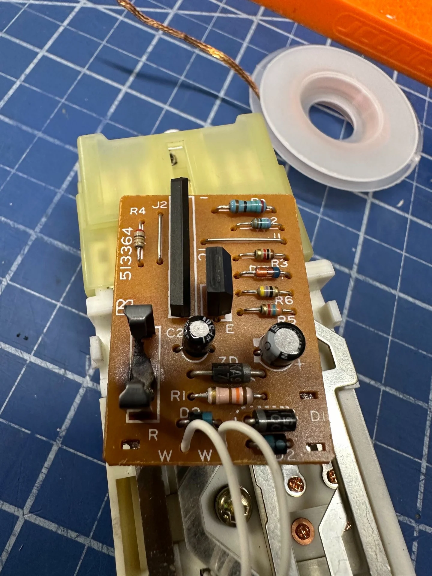

i'm just over here melting stuff :) I've been poking around the EWD, am I correct that the current for the window motor flows through the switch itself? Must be in the case, otherwise the diode current sensing wouldn't work?
So, desoldered the boards hard points to get a better look. This is a big ol resister based on the labelling, that's all I can dig up.
New switch coming from switchdoc... hopefully I can just reinstall my diode on the new switch.
Yes, you are correct, the power flows into the switch (terminals 7 [up] & 8 [down]), from the relay, and then to the motor (terminals 6 & 13):

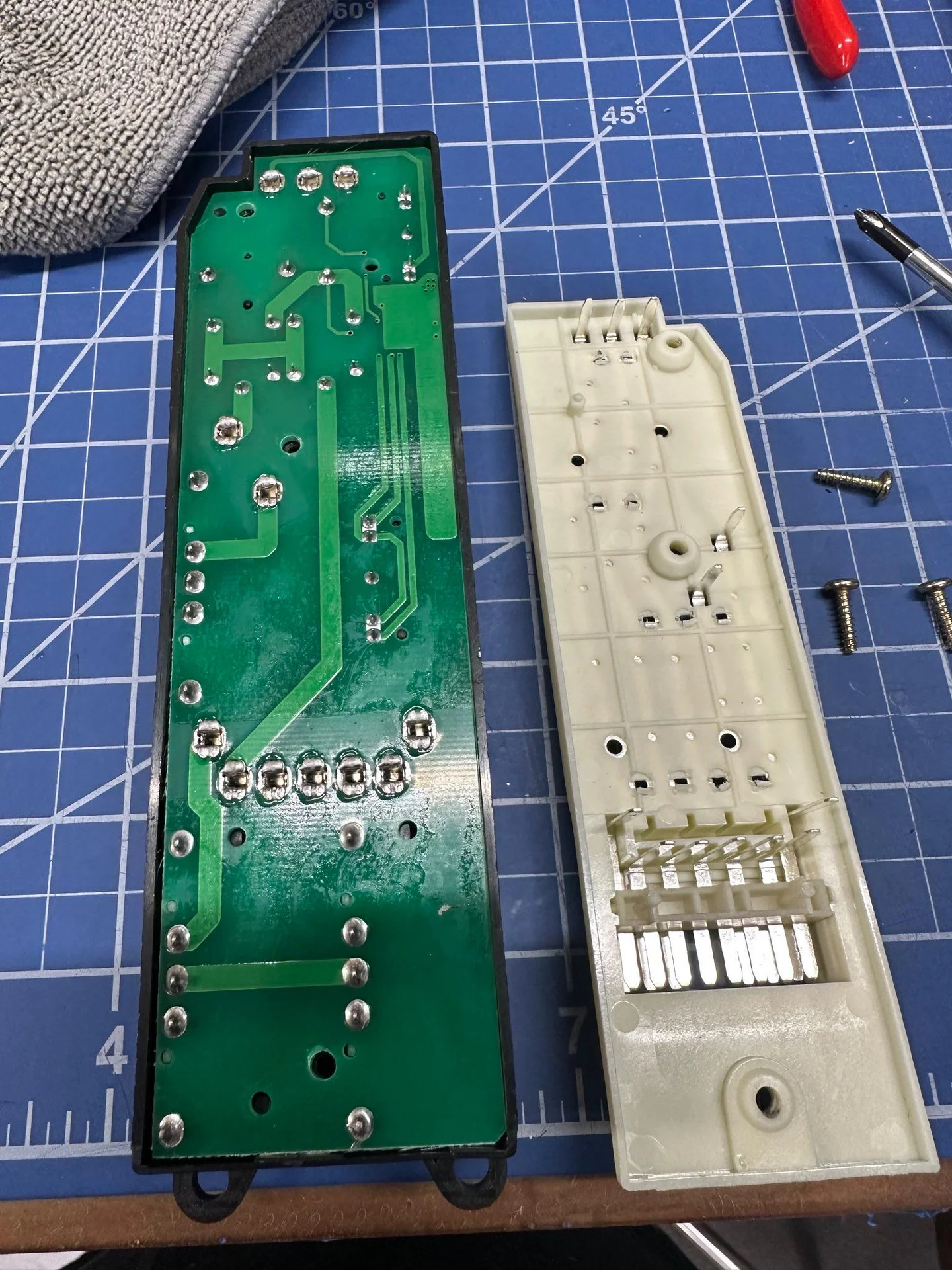

I just got my switch from switchdoctor, looks like some of the folks who've posted asking about a different switch (big green pcb inside), have one of these aftermarket parts. Here's what mine looks like for reference:
Does not appear to be any way to do the auto up mod on these.

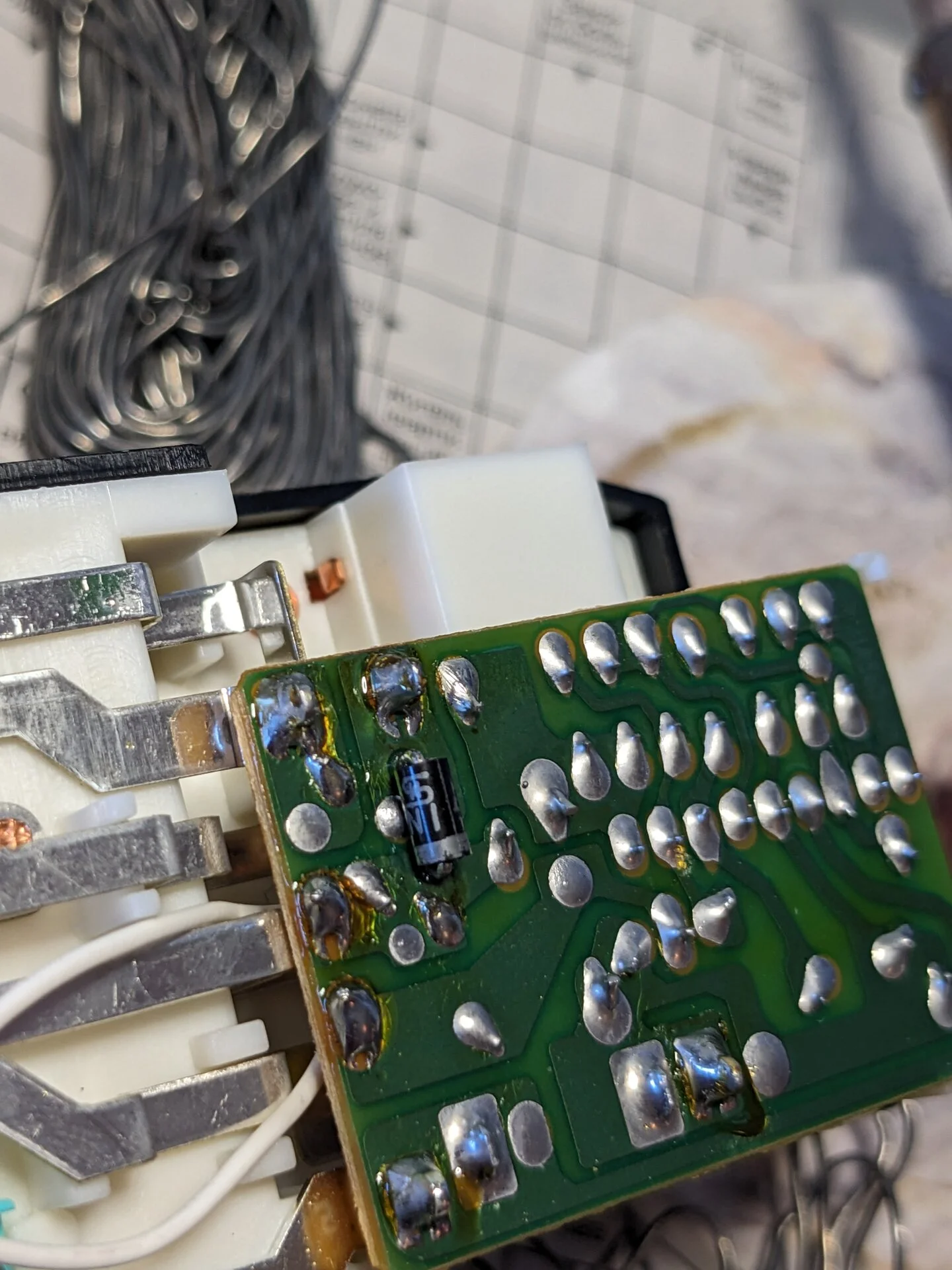

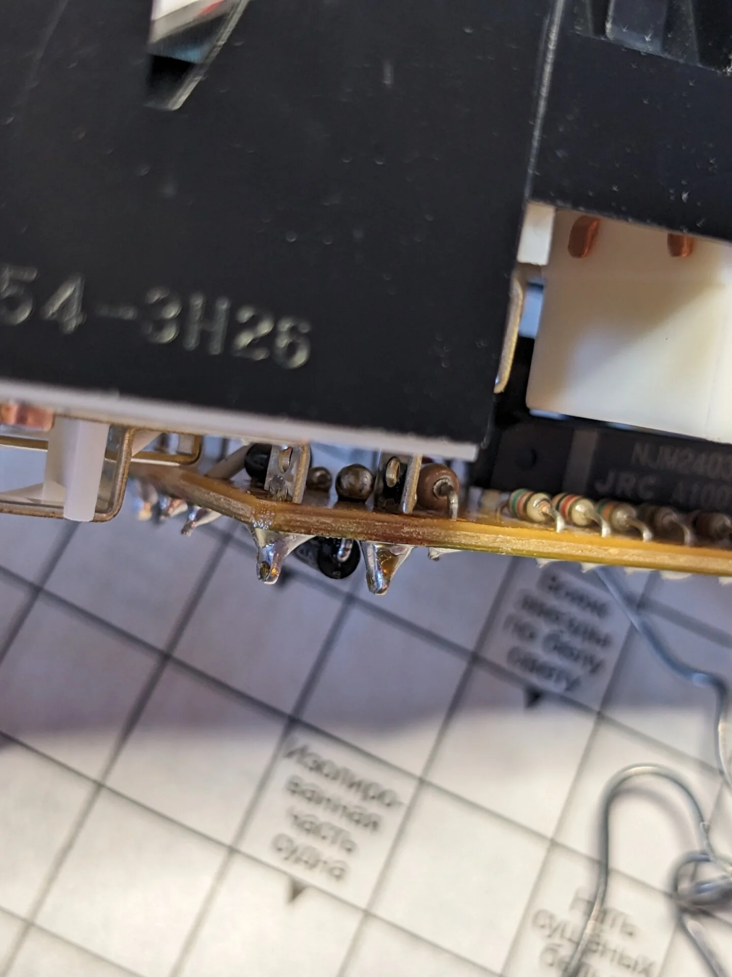

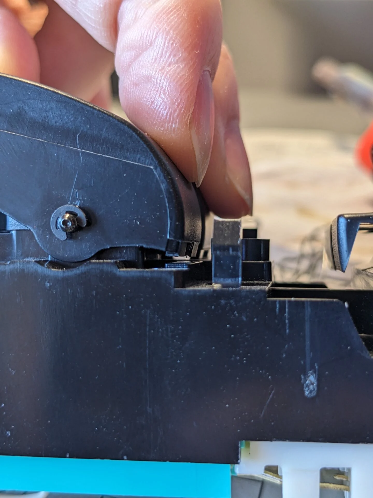

Hey all, I was hoping someone knows what I'm doing wrong here, since I went through and my window doesn't do the auto up. I don't think I was able to succeed in either step. I cut the tabs, but the switch stops short of hitting its new stopping point - you can see it hovering as if the tabs were still there. with enough force, it maybe moves .5mm further - barely noticeable. is there another adjustment to make? it seems to only move as much as the uncut passenger tab. Also, when I soldered the the diode, the solder seems like it dripped through the holes in the PCB to the other side (see the globes of solder opposite the new diode. I heated up the diode until the solder melted on contact. Is this a bad technique?) rather than pooling on the board surface like the original pictures - does this matter? I've done a fair bit of wiring but never worked with a PCB so I don't know if I needed to prep the surface and didn't.
It looks like you didn't get enough heat into the right place. Your solder should "wet" and form a nice fillet around the pieces and flow. Look out your solder joint vs the OEM solder joints. Also, your joint should be shiny, if it's dull it didn't get hot enough and we call it a "cold solder"
Soldering isn't easy, but it does get easier with practice. Plenty of good youtube videos.
The right tip and the right solder go a long way.

hmm, i ended up with the same situation in reverse even though I heated it long enough that the board started to scorch... in fact, the solder seems to have disappeared, no globes on the backside like last time. the videos I found all have way different boards with bare metal contacts so I can't find a comparison. does this type have special name?
Surface mount pcb.
Are you tinning the tip of the soldering iron?
