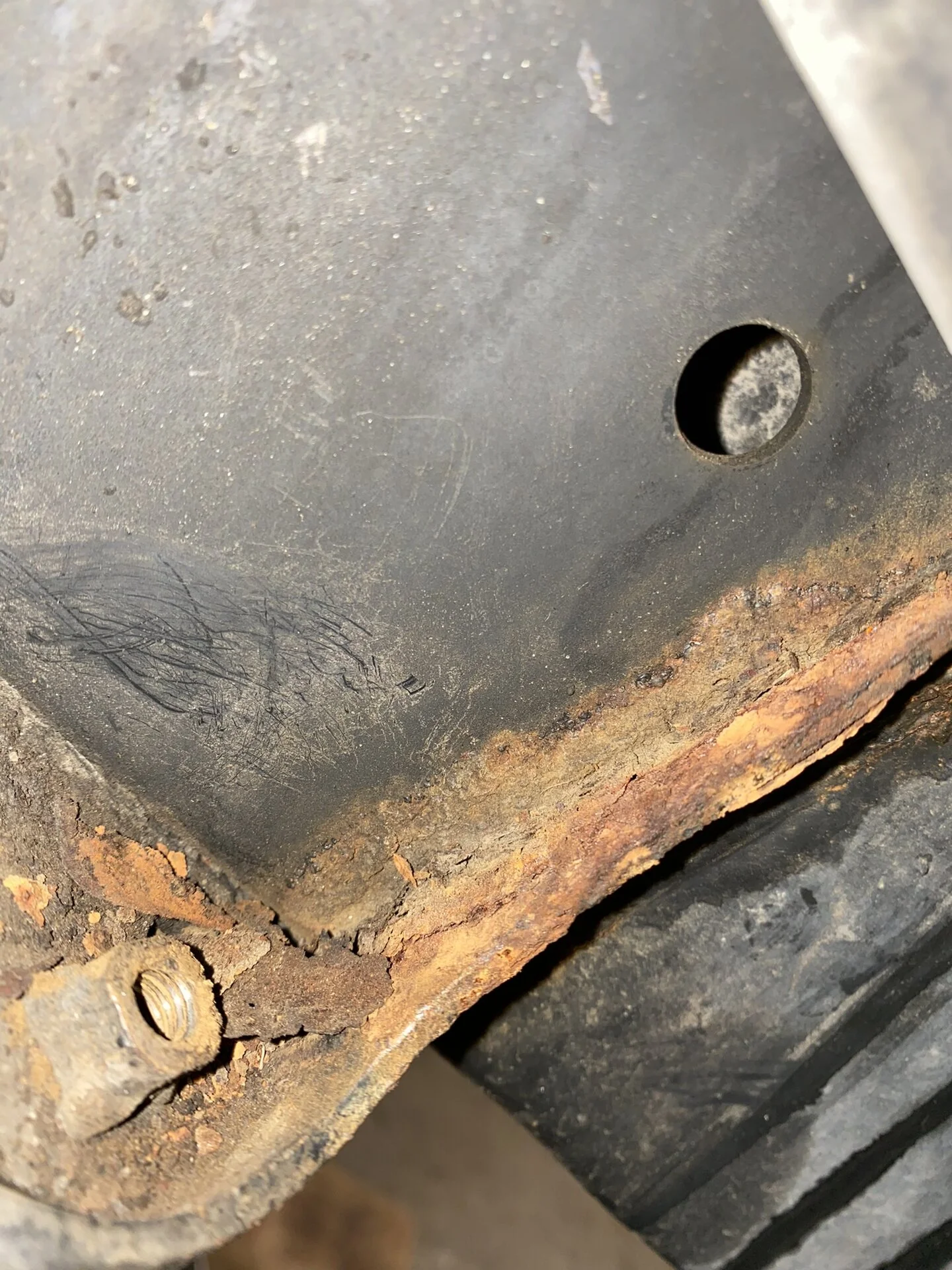

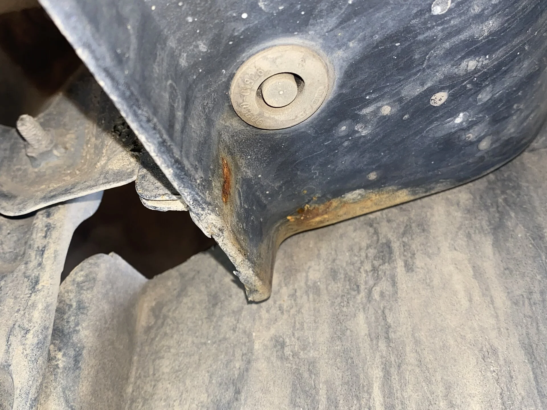

Those that run front and rear AC often. Should mitigate rust areas, induce by condensations from AC. At front AC drain on stabilizer bracket on frame and rear RH quarter tip inside body panel cavity.
RH frt stabilizer frame bracket. AC condensation hose comes out RH fire wall and drips on bracket. A mud member sells a kit, to diver hose.

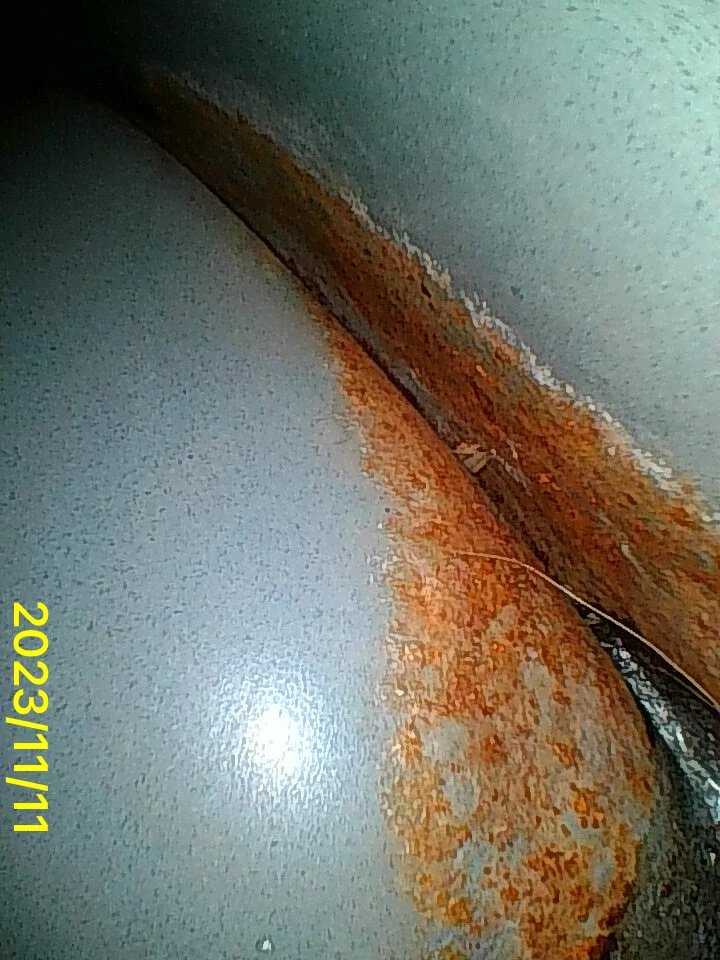

RH rear body cavity, below rear AC unit.
Condensation is hidden in cavity, sweats of rear AC unit. Working it way out. There are weep holes, but dust clogged them in time.

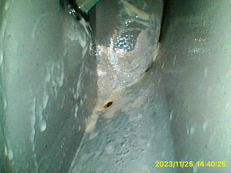

Cleaning cavity is an important first step. On both side even if AC not used much.
3M body wax, is one product. That can be used after cleaning.
