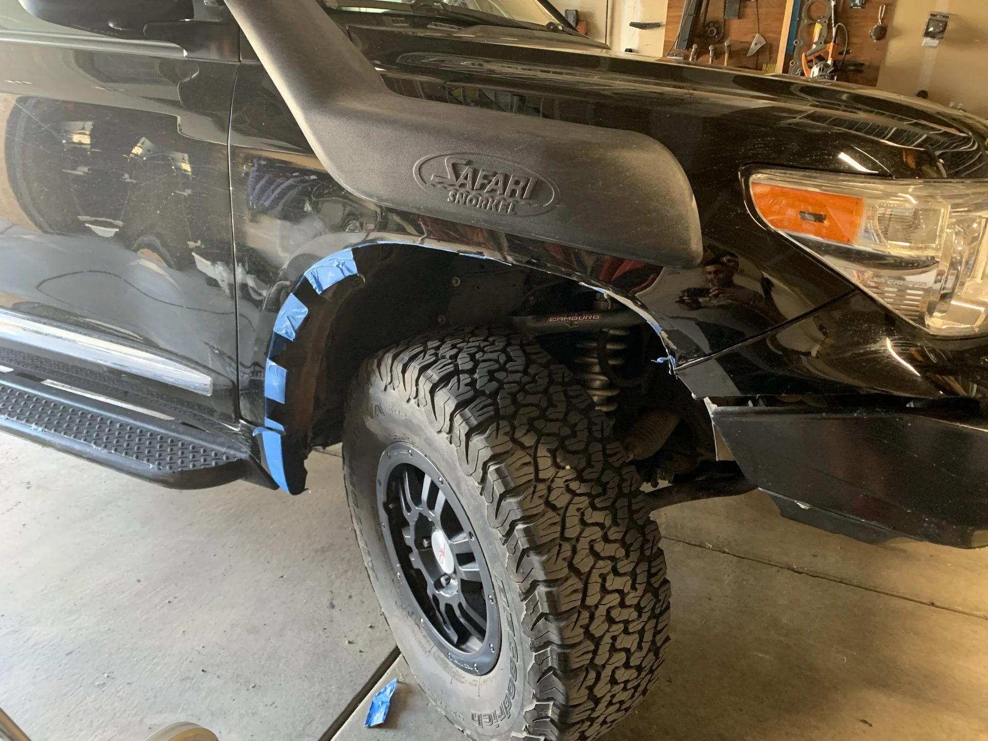

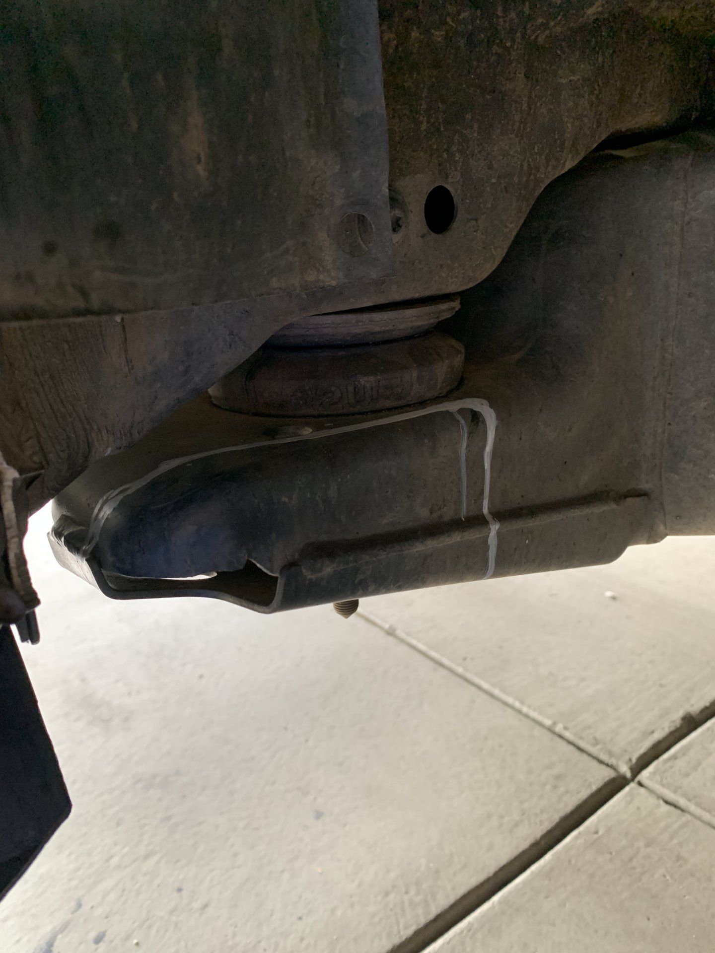

Started cutting fenders. Used m8 nutserts and re-drilled holes to hold fender liner. Plan is go 35s when my current tires need replacement. Body mount will also be chopped.
Wow!
Hey Kamal—
If you are considering 35x12.5x17 Ridge Grapplers, I have a near new set of 5 (less than 1800 miles on them). Could save a bundle... If I could afford a chop and other similar changes, I’d keep 35’s....but since I’m not and you are...you might want these.

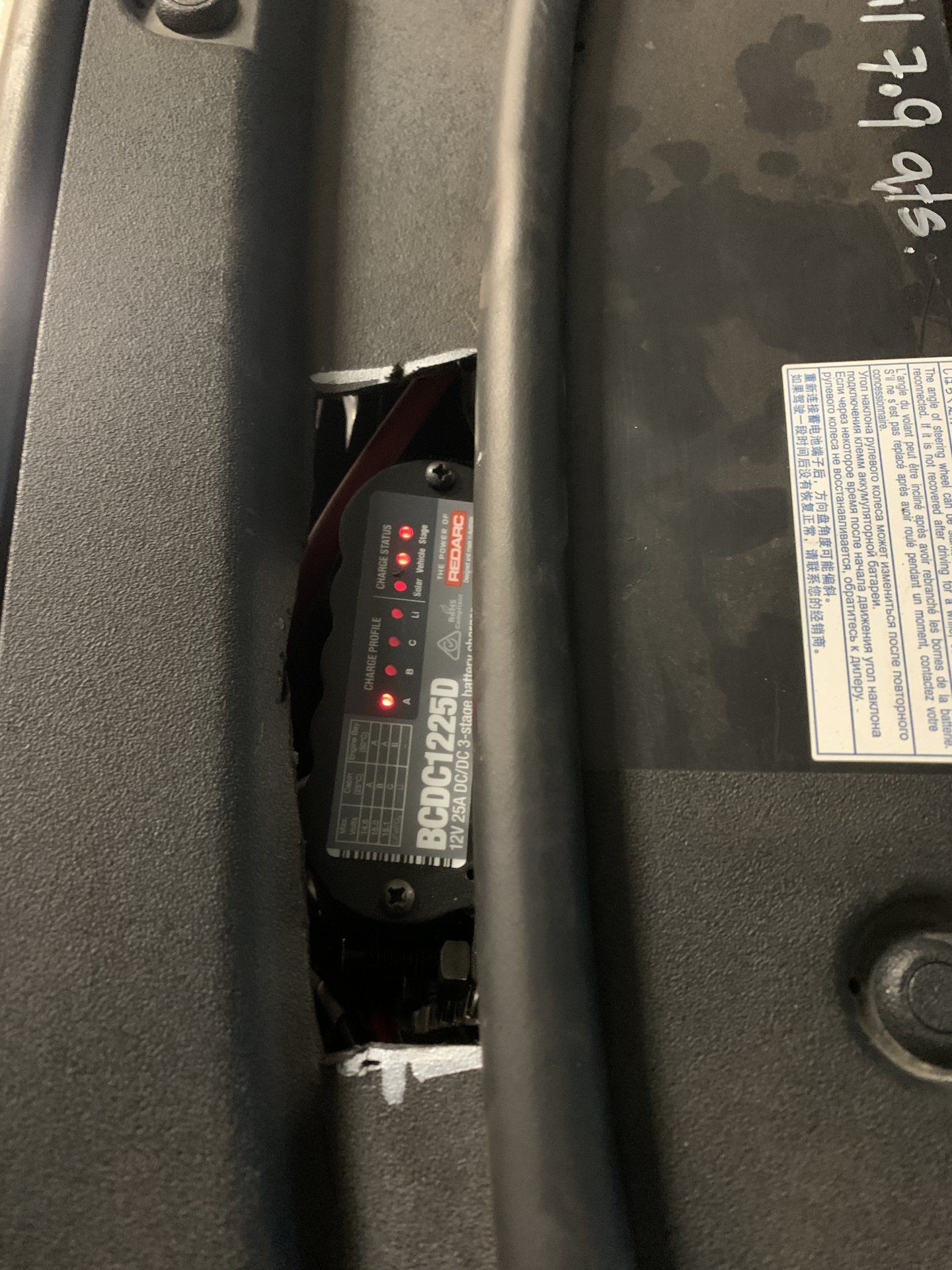

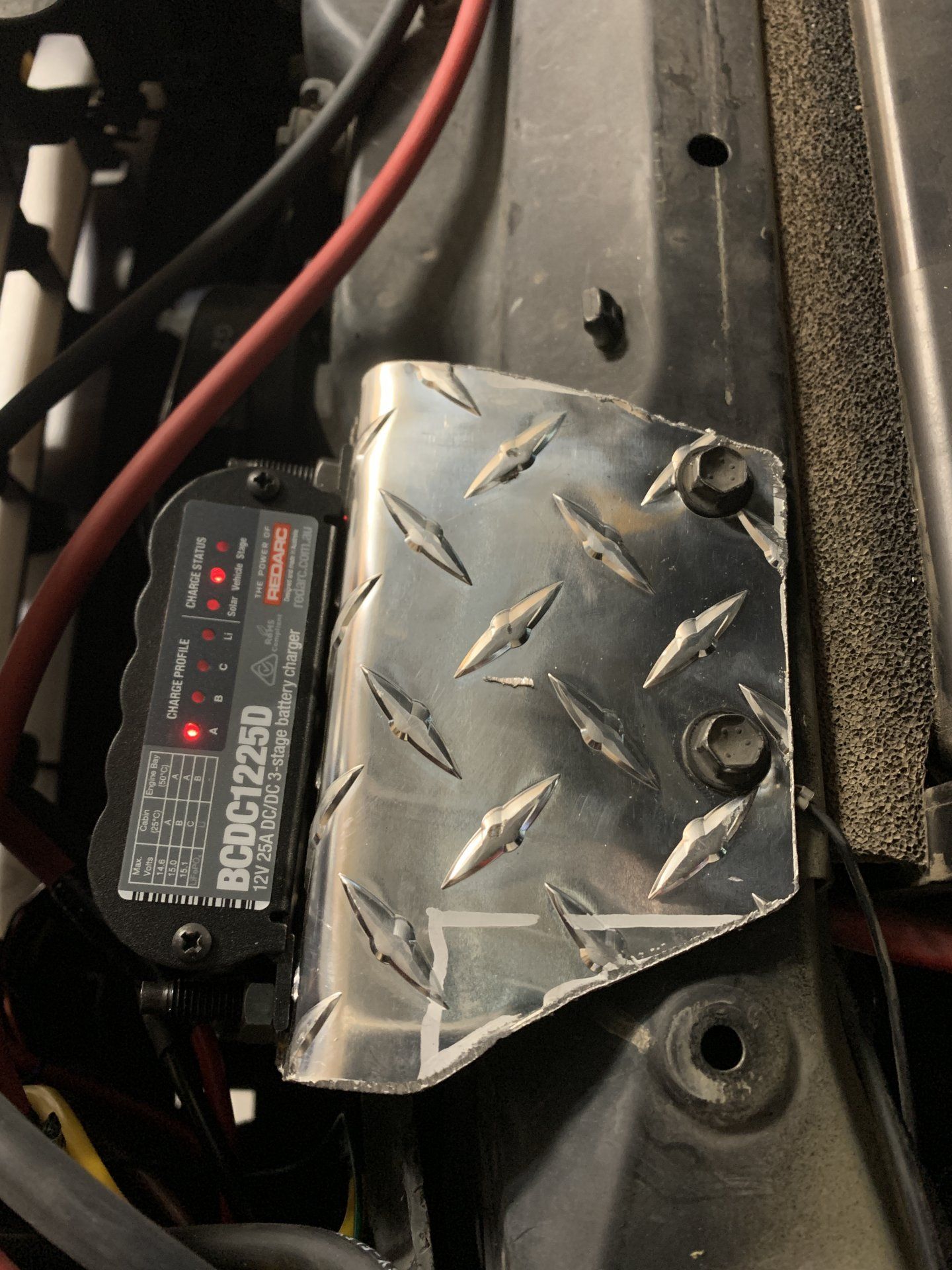

2nd battery hooked up with redarc bcdc1225d.

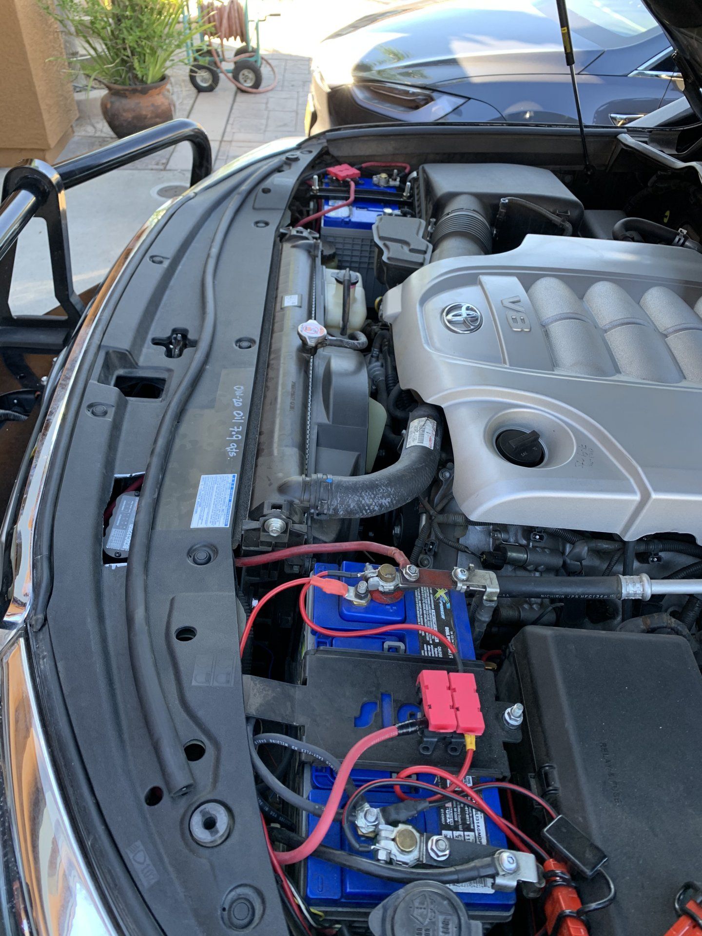

@Atwalz are both batteries X2 Power Group 31 or is the battery on the passenger side a group 35 (X2 Power)? Also when you get a chance, could you share your dual battery setup/ detail and how the redarc bcdc1225d is performing? Thanks~
Main battery is group 31m and second is 35. Performance is good. I have been running the fridge continuously. No issues. You will need a 40 amp fuse to each battery connecting the red arc. I did not connect blue wire or solar or led. Just ground and two + with 40 amp fuses to red arc. Then wired the fridge from aux. Winch is off main battery. I used 6awg wire to connect both batteries to Redarc. And 10awg with 40 amp from blue sea fuse block w/15 amp to fridge
Thank you for your insight. Are you set up to jump your main battery with your aux (35) if ever needed? My understanding is that redarc bcdc system does not have that capability..?
I did not wire for fancy jump start. Simple jumper cables can accomplish this.
Self jump is pretty straightforward: a heavy duty relay and four wires - one to each battery (fused), a ground and a trigger wire to your "link" or "self jump" switch. The bcdc isn't really involved, although Redarc does publish a wiring diagram for it leveraging the SBI12. I found the SBI to be unnecessary with a BCDC, so I neutered it, turning it into a simple high load relay (you can purchase the equivalent relay for $15-20). Or you could use jumper cables, but what's the fun in that. :)

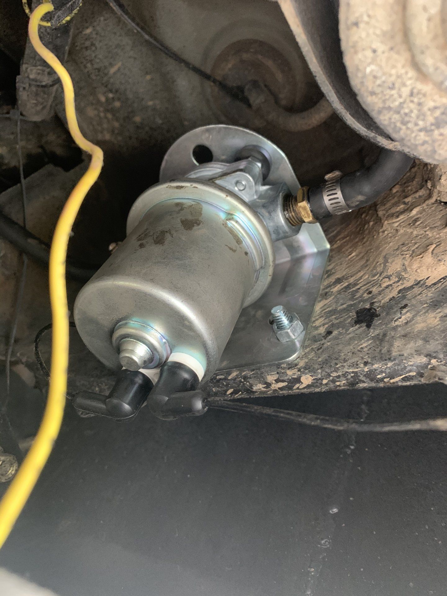

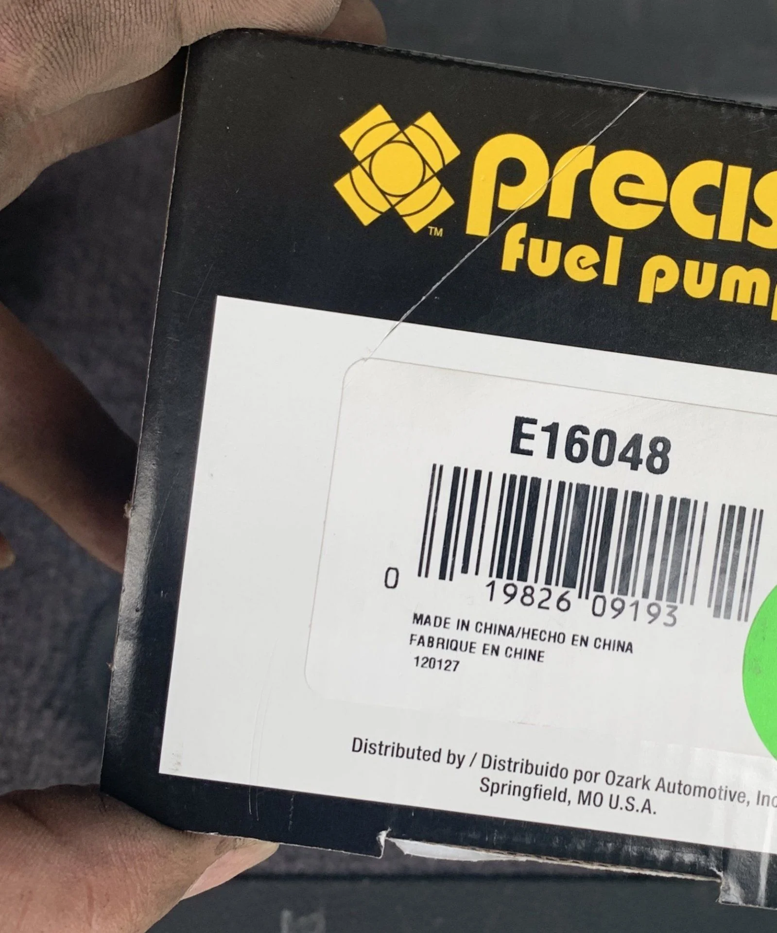

LRA fuel pump swap. Waiting for relay to finish wiring. Tested without relay. Works well and it’s quiet. @jmlockwood thanks for sharing info.
Wired fuel pump relay, I really like this setup fast and quiet. Also, ordered 4.88 nitro gears and ARB lockers. Scheduled for installation at Hunters 4x4 in Oct.
