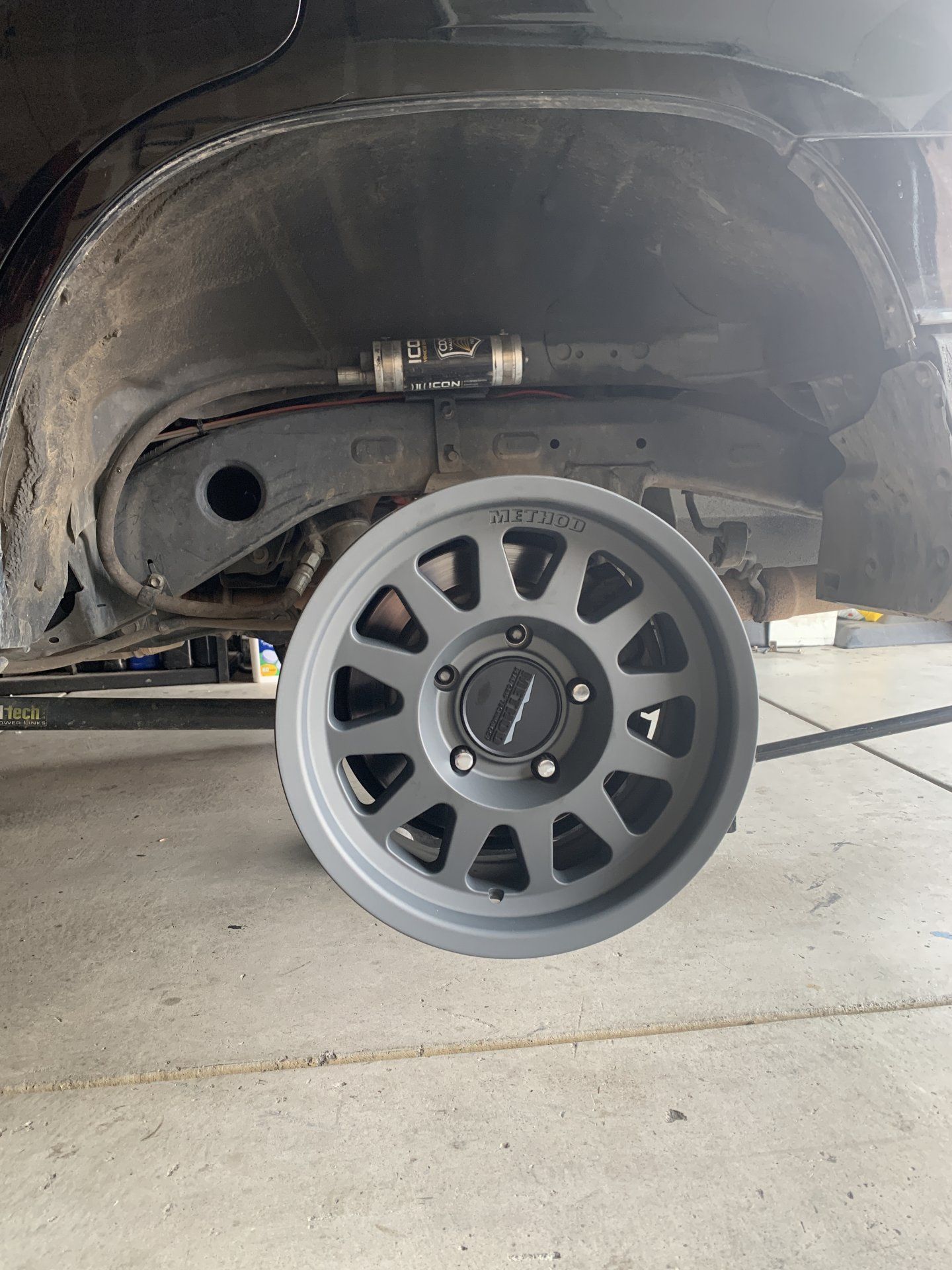

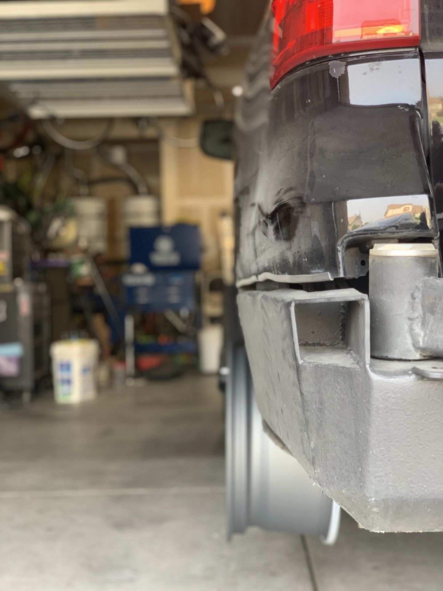

What about the RW doesn't work anymore? Do you need a rim with a lower offset to clear some of the new components?
Freaking awesome work!

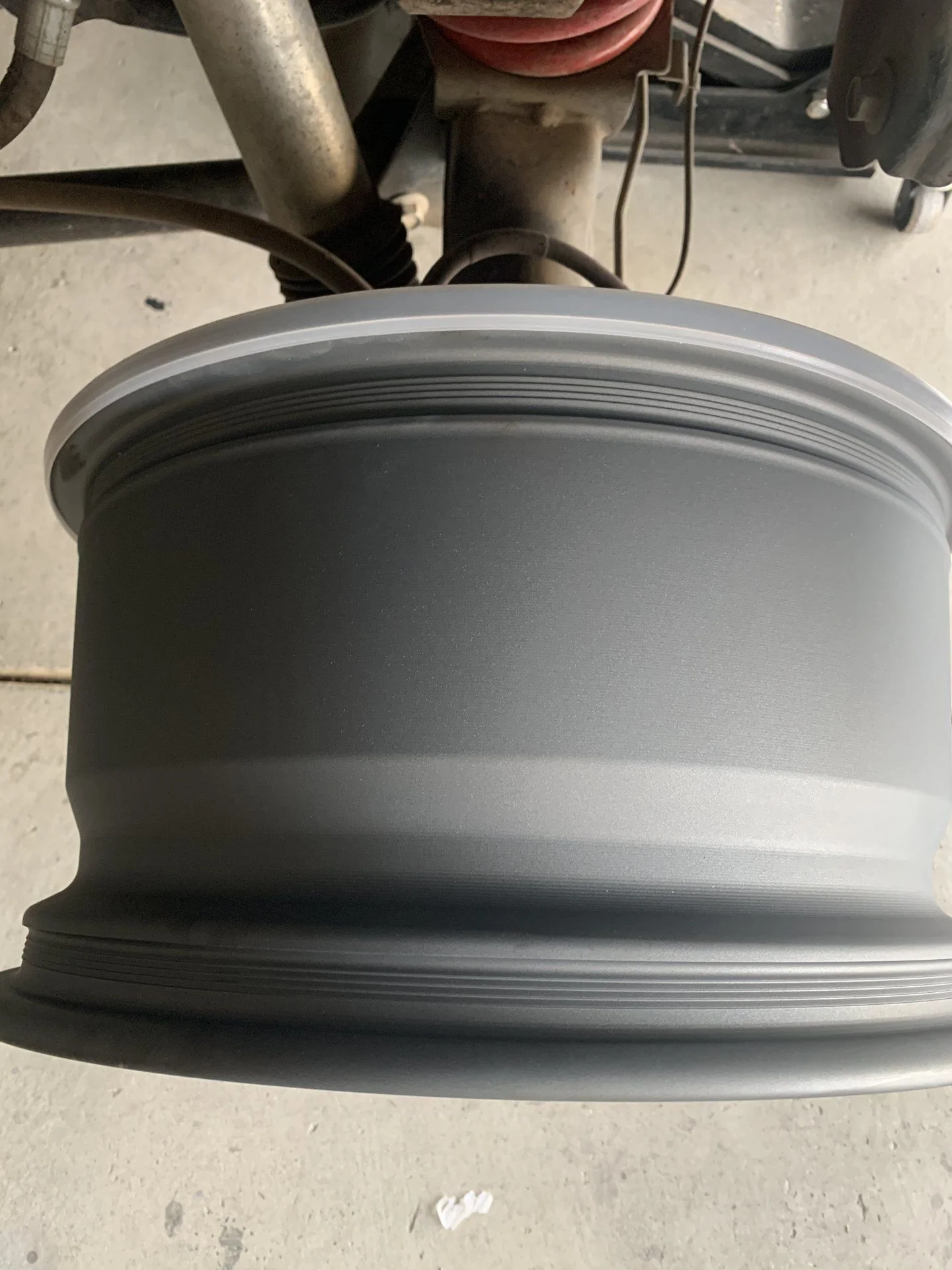

I am running spider trax spacers. It clears 34s. Offset needs be +18mm or lower for 17s. I will probably do method mr704 with 0 Offset.

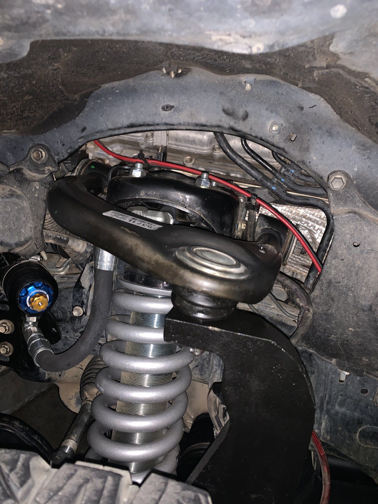

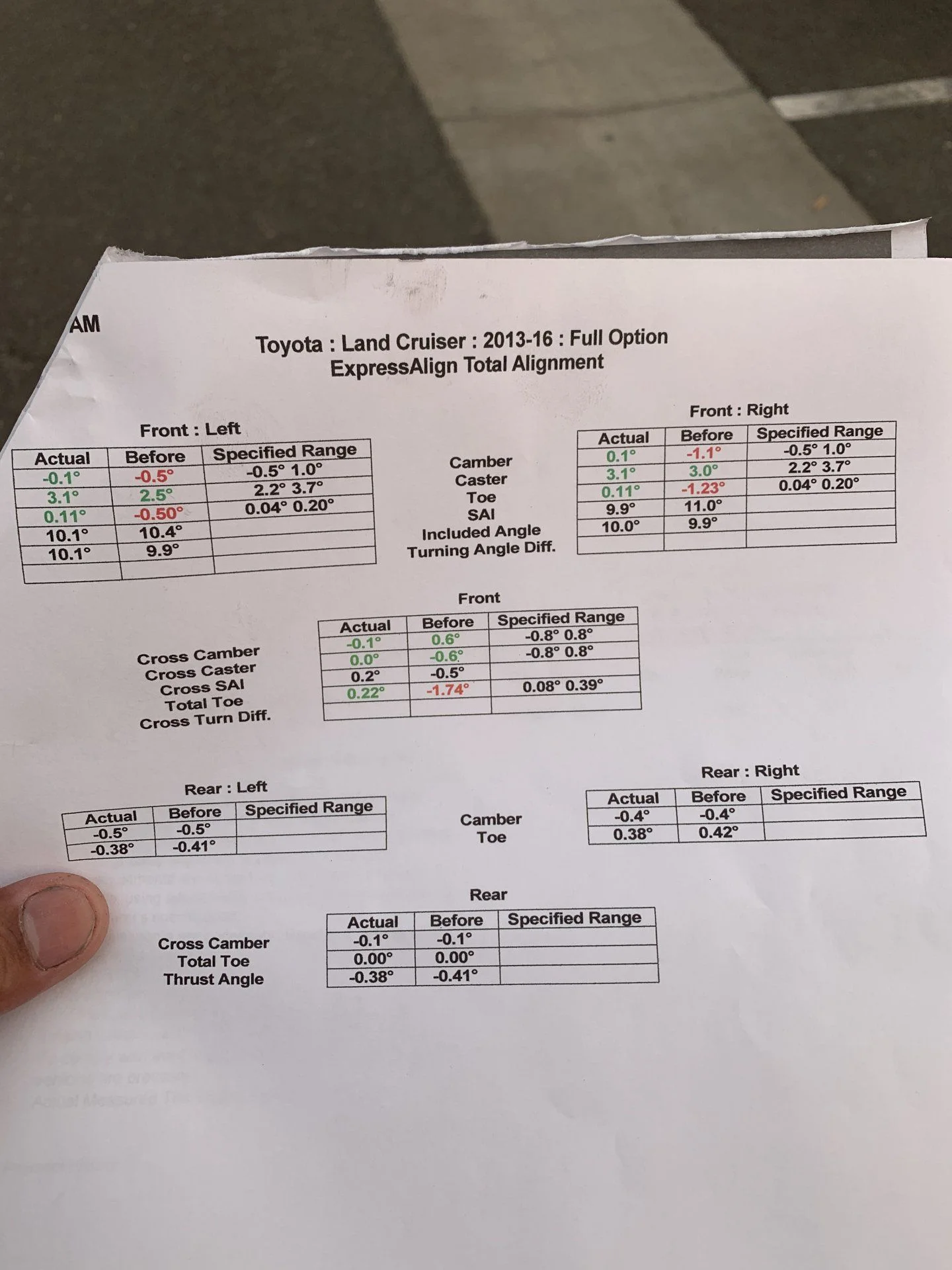

I swapped out the upper control arms yesterday. Top long bolts are PITA to remove and torque. I had a camburg engineering control arm when I did tundra conversion a while ago. With the BDS lift installed, the camber was negative as the arms were designed for 1" to 3" lift. I picked up a pair of stock tundra arms and installed them. I hope to get alignment issues worked out tomorrow. I will be selling camburg UCAs, Icon coilovers with 700#/1" spring rate- remote resi with CDCV valve (rebuilt in April 2020 by Rock and road performance), and 5 rock warrior wheels (wheels available after methods are installed). I will post these items in the classified section.

Alignment adjustment turns out great! Specs are below.
Tundra stock upper control arms did the trick.

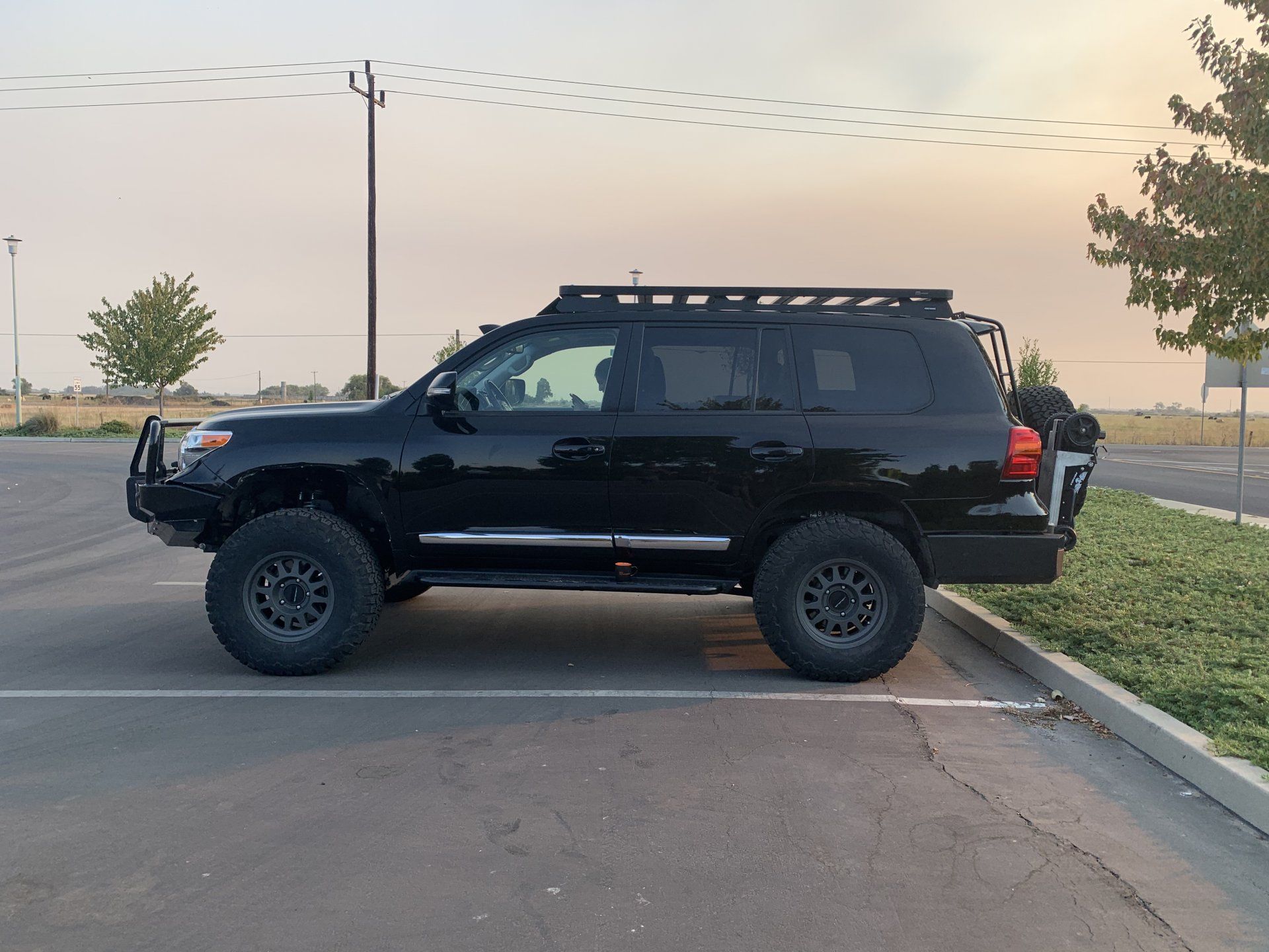

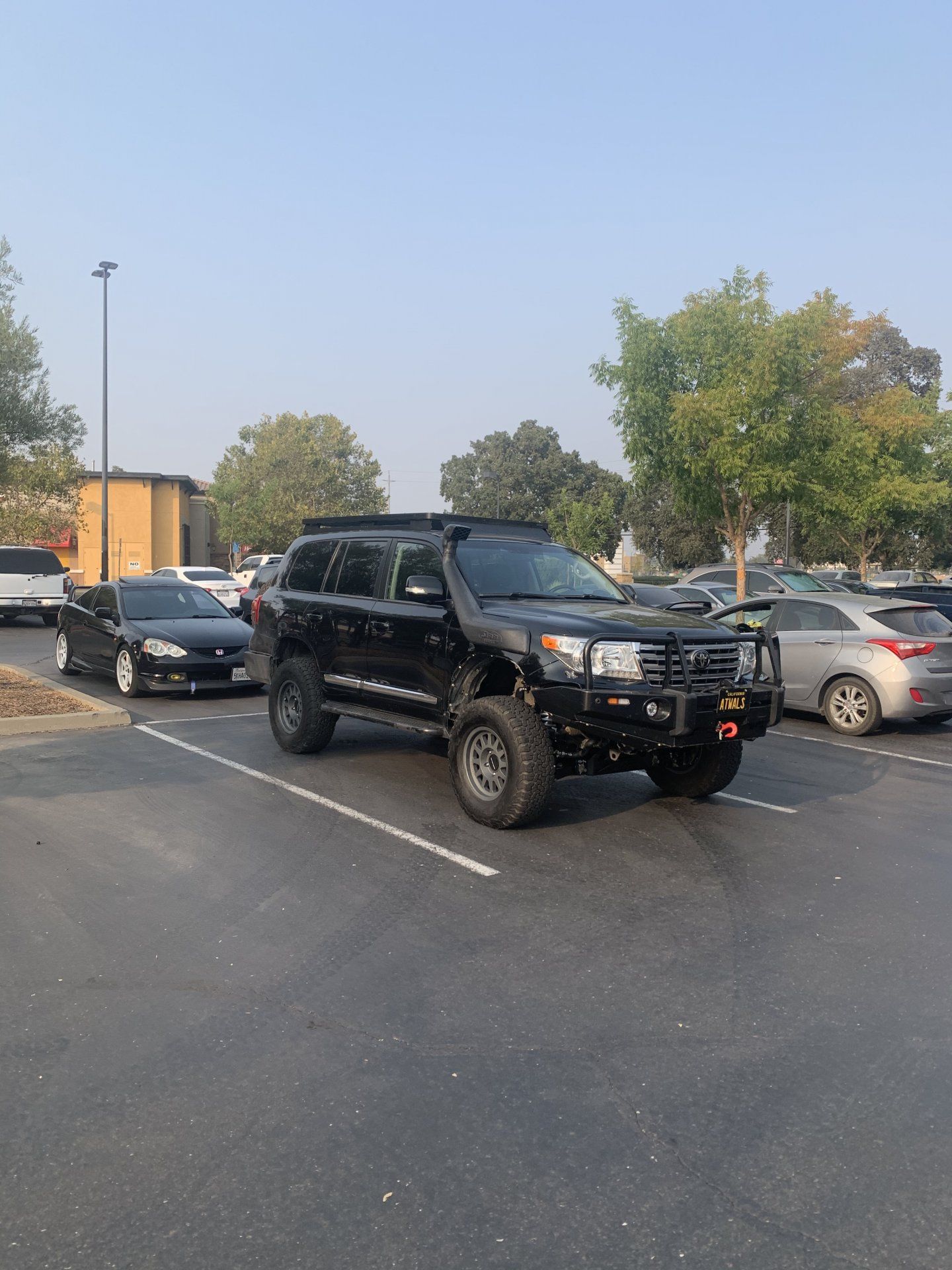

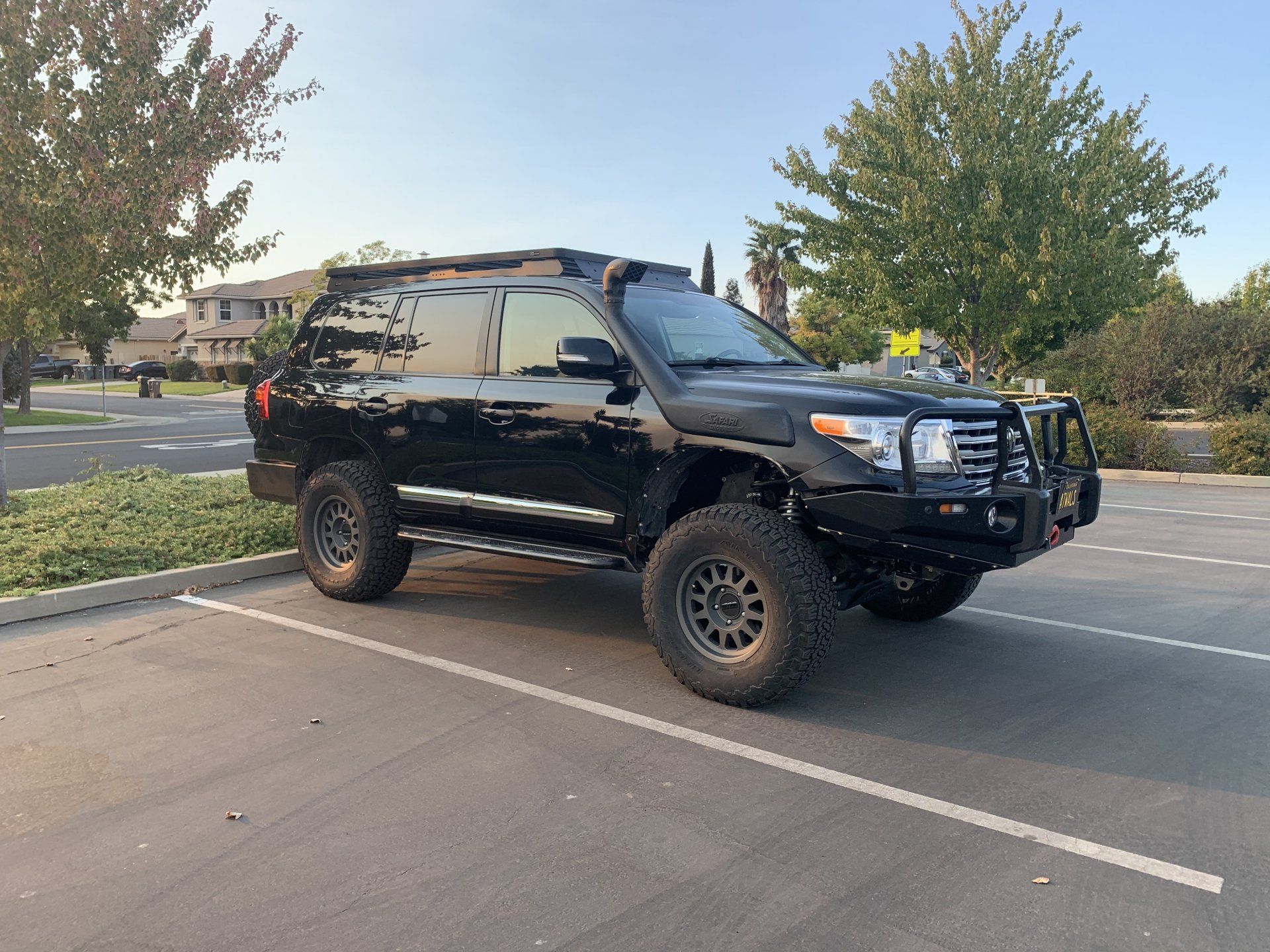

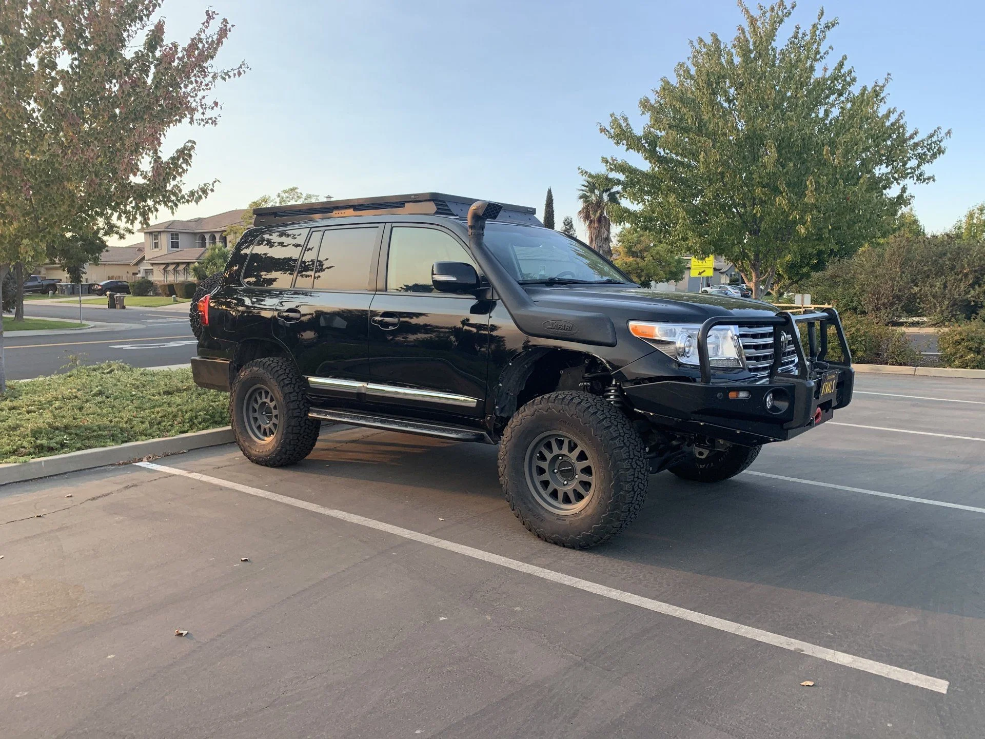

I have put about 300 miles since the lift but only less than 5 miles after alignment. I like this lift for clearance purposes and alignment specs are within factory range. CV angles are approximately 5 degrees. The steering feels good too. I don't remember how stock steering felt. It drives straight after alignment and comfortable at highway speed at 80+mph. Also did some back road driving on curves, I like it. I keep in mind that the center of gravity is higher so I adjusted my driving behavior accordingly. Up travel and down travel for front suspension is closer to stock now, this is a huge difference compared to my old setup. There is definitely pro and cons of drop bracket and Coilover lift. Here is my feedback summarized below. I will update is as I put miles on the kit.
DescriptionBDS 4.5" tundra drop bracket/Steering knuckle (1.5" front fender cut)Coilover lift tundra/camburg UCAStock
Center of Gravityhigherless than bds but greater than stock-
Front CV Angles5 degrees+20 degree (depending on Coilover height)-
Steering+ Good feels solid with upgrade knuckleGoodPerfect
Wheels17" with 0 offset17" RW 50mm offset60 mm offset
Front Suspension travel (up and down)+++++
Clearance+++++++
Tire Size353433
Rear tire RubYes on full stuffYes on full stuffno
Front tire Rubnot known yetnono
Rake or leanYes, less 1 degreeforward lean (not known)forward lean (not known)
Under 7 feetYesYesYes
Mpg (w/o regear)<11 (regear will improve)<1213-18
MPG (w/ regear)TBDno datano data
Reversed back to StockNoYesYes
Body Mount ChopNoNoNo
Rear SpringsTour flex heavy (3" lift) & 30mm spacerTour flex heavy (3" lift)stock
Front KDSS links StressedNoYesNo

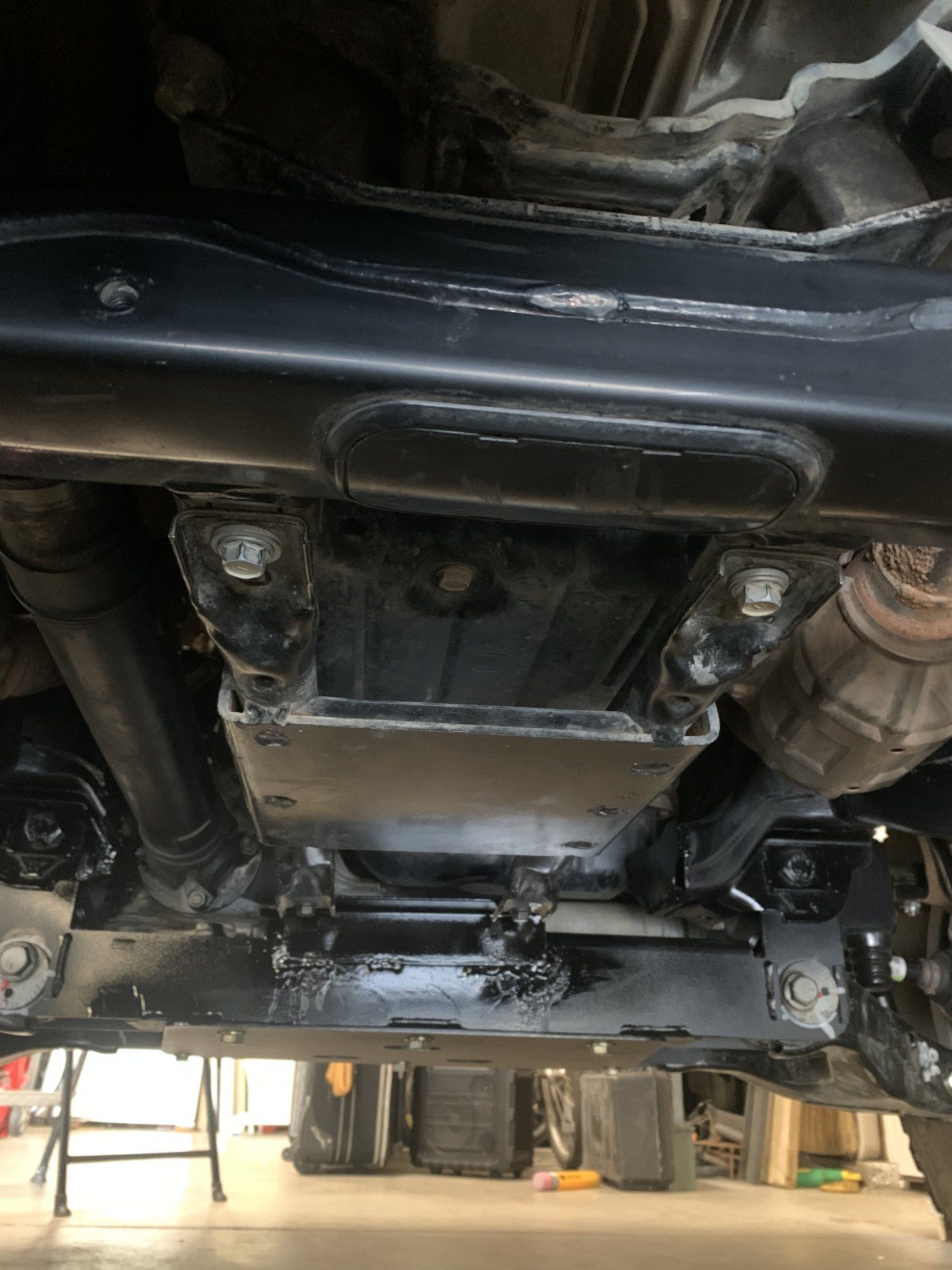

Redesign front skid splash guard with oil filter cutout. I used 14ga diamond plate I had lying around. Light weight compared to old one was 3/16” plate.

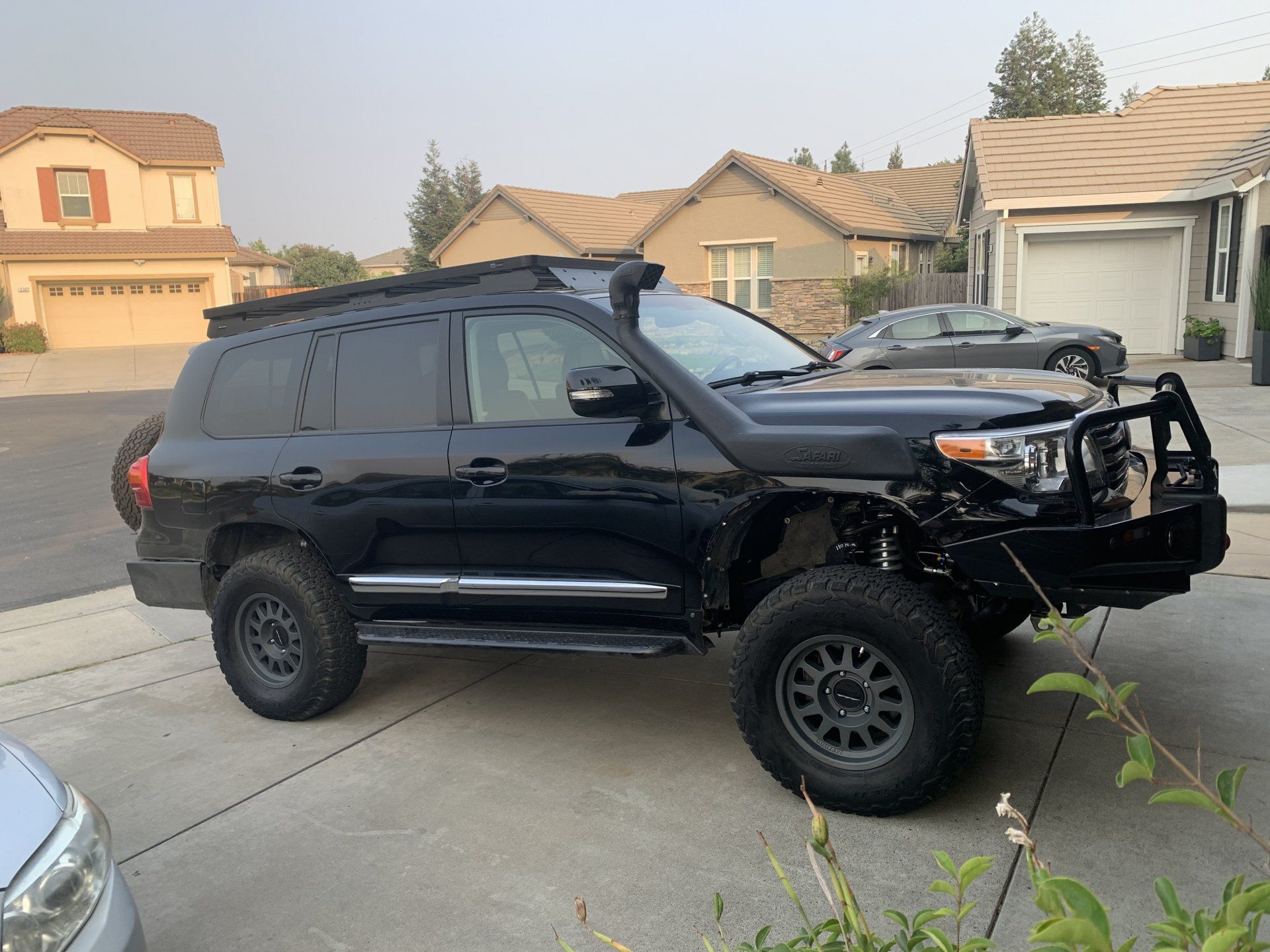

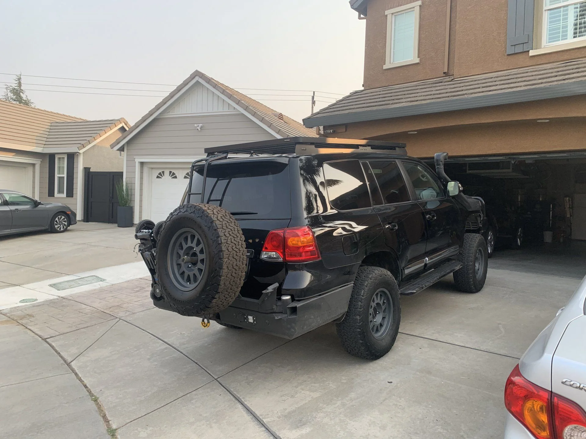

Installed 35x12.5x17.
