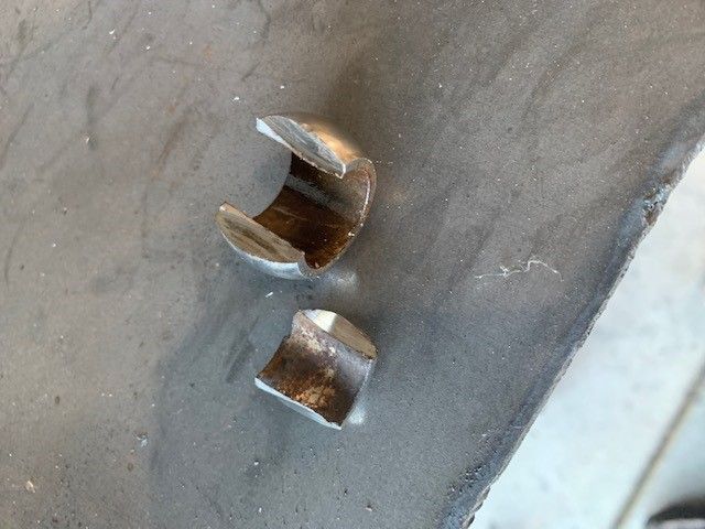

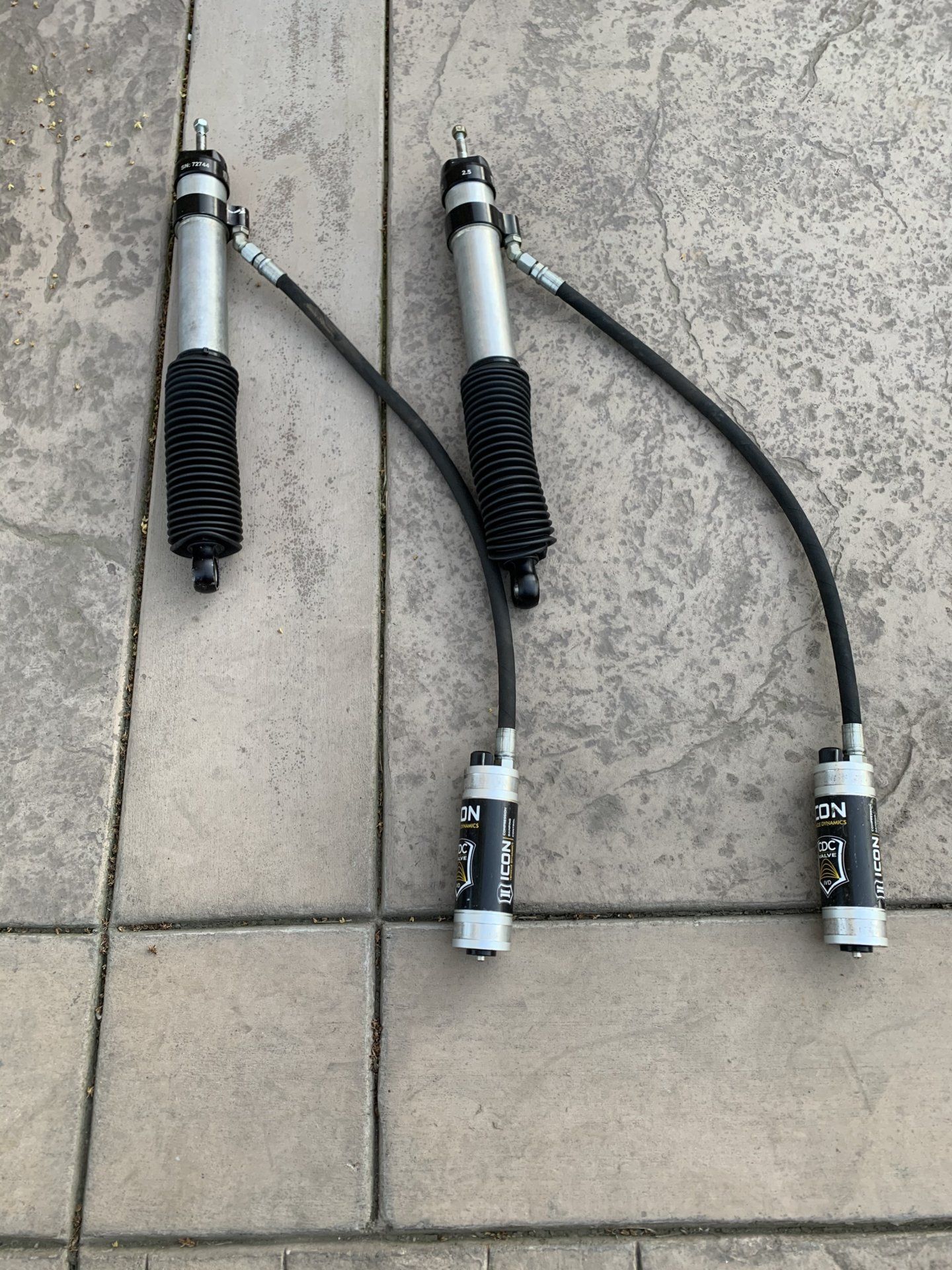

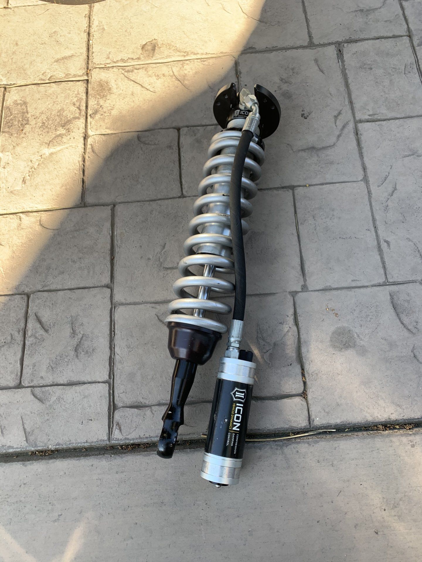

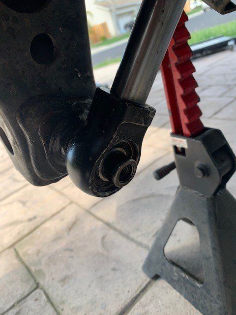

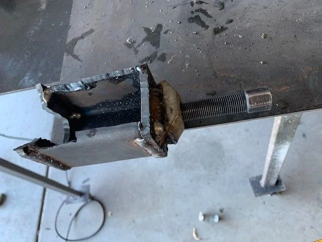

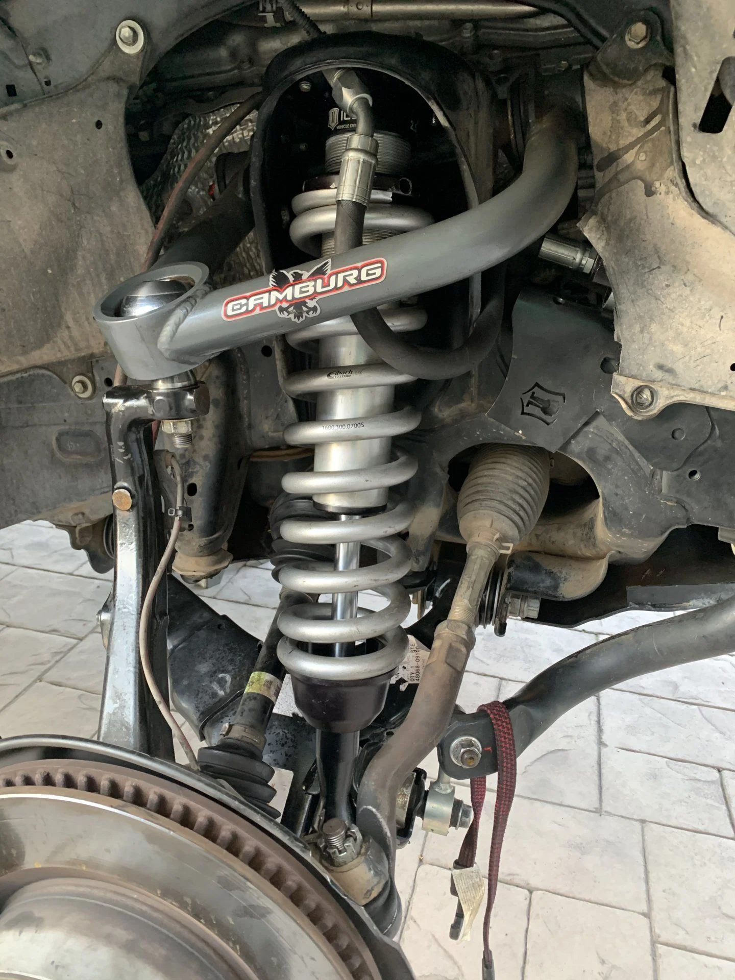

Removed shocks and coilovers for the rebuild. Rear shocks were frozen on the lower axle mount. After several attempts of prying it off, I had to make a custom puller to get the shock off the rig. Dropping them off locally today to get them to rebuild. I had to cut the FK rod end bearing for one side to get the shock off. I will be ordering a new FK rod end bearing from Icon. I am thinking about investing in the tools to rebuild them at home.
To what do you attribute the freezing? Was it impact damage? Corrosion?
It was corrosion.
Reporting back on the shock rebuild. on the front Coilover, shock shaft was replaced due to a vertical scar which caused a leak. The shock seal head was also replaced. I also added boots to rear shocks to protect the shafts. On the rear shock which was damaged during removal, lower eyelet was completely replaced along with new M12 bearing. I have acquired all the tools needed to rebuild shocks. So the next rebuild will be inhouse.

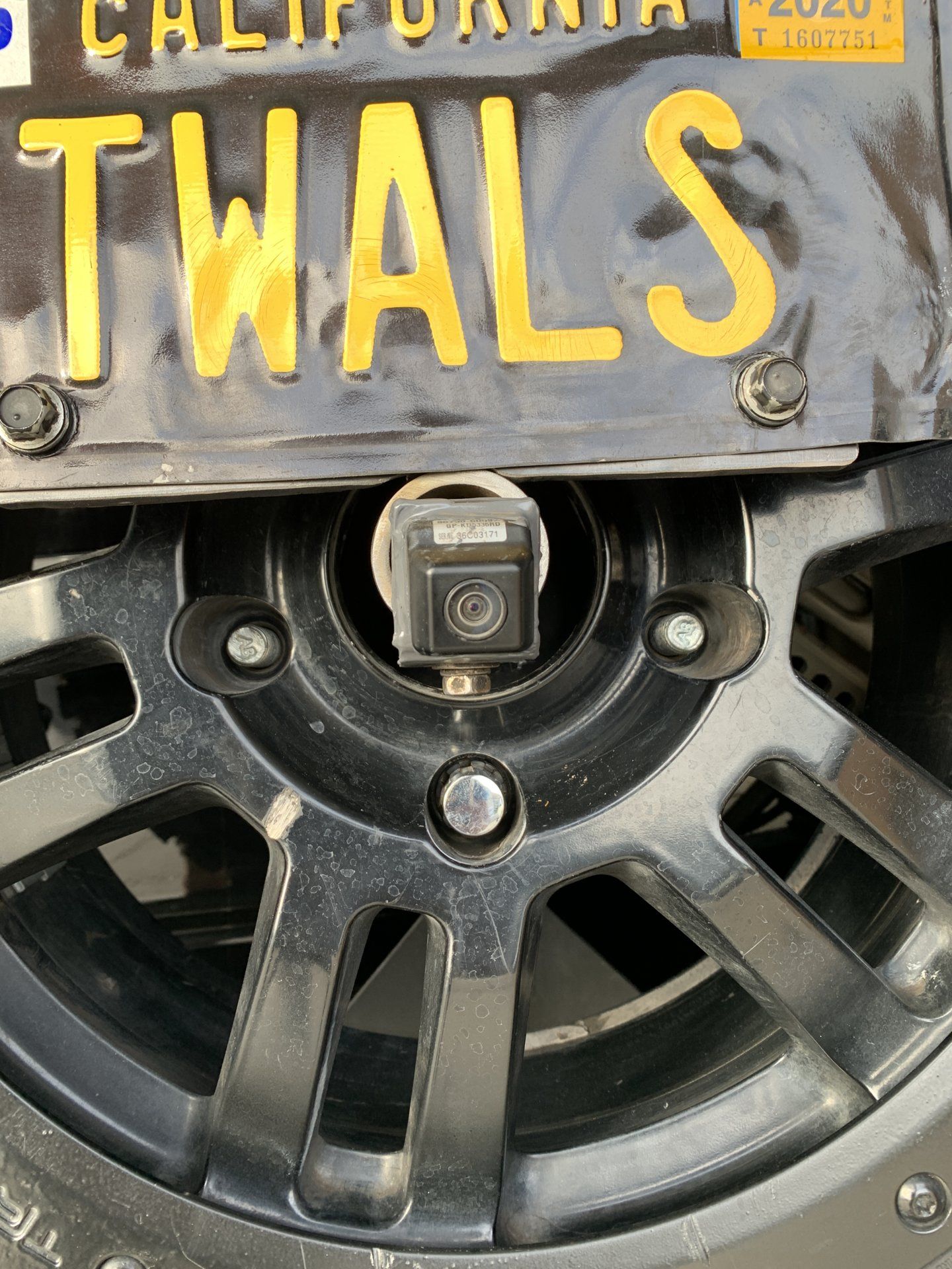

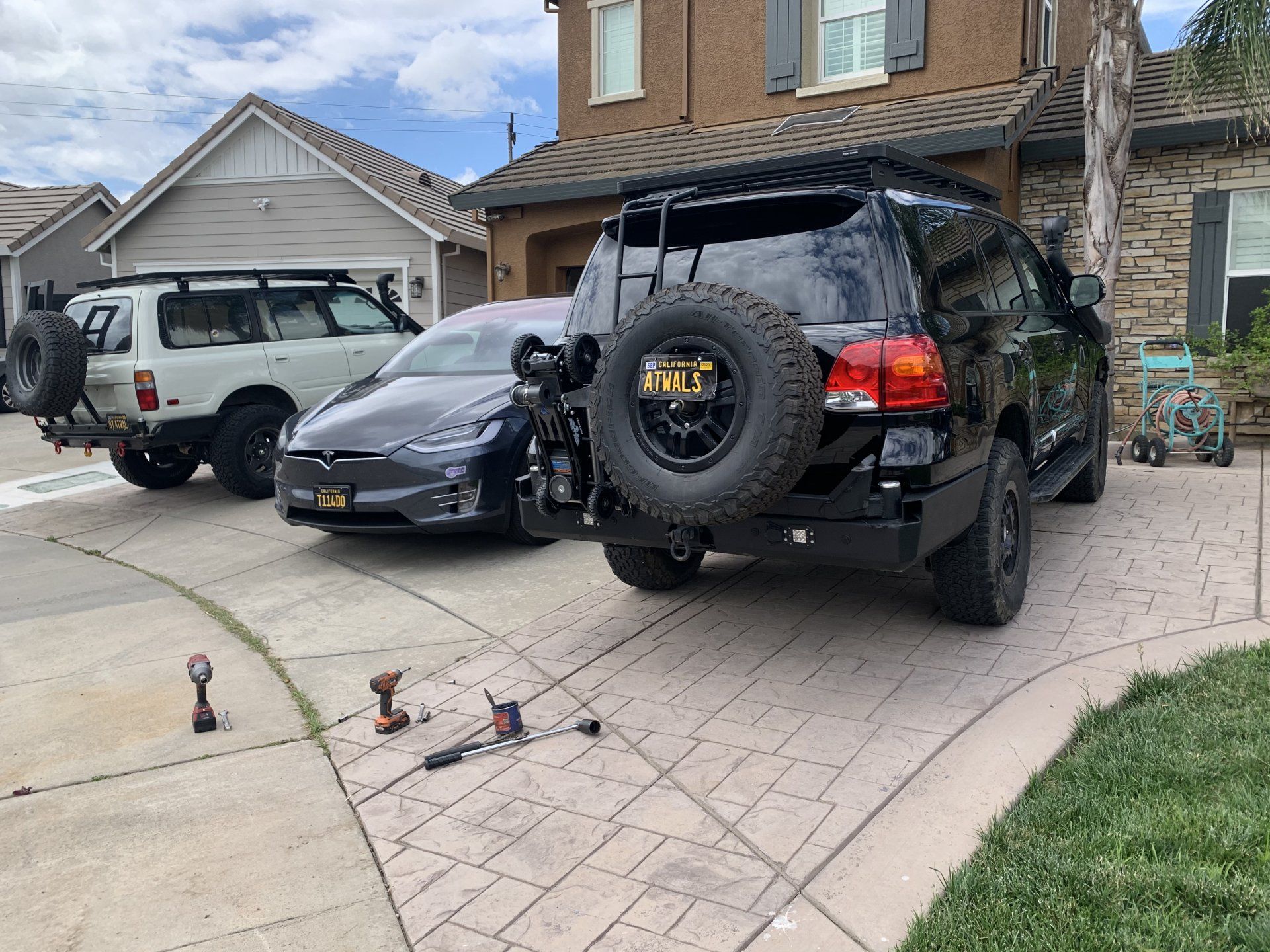

Relocated rear camera to spare tire carrier swing arm. Used 22-4 home security cable to extend camera wires.
Same chore I did this week. I used 7 conductor sprinkler cable, just in case I want to have some option in the rear door for lighting.

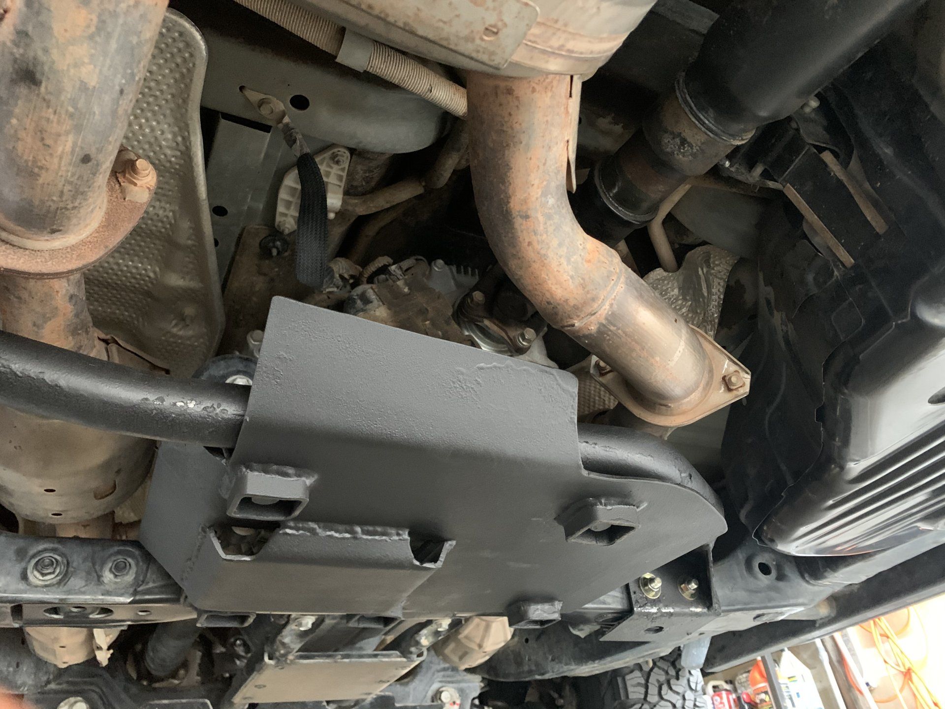

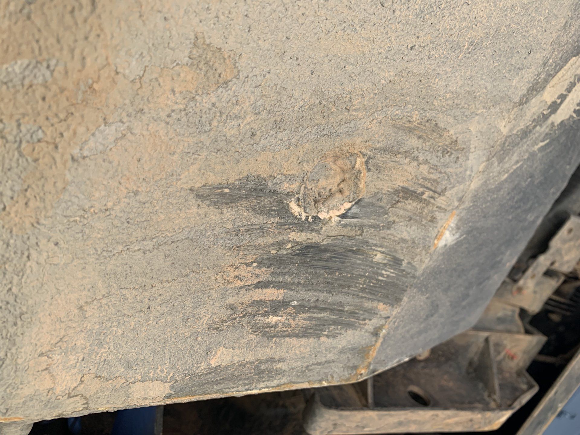

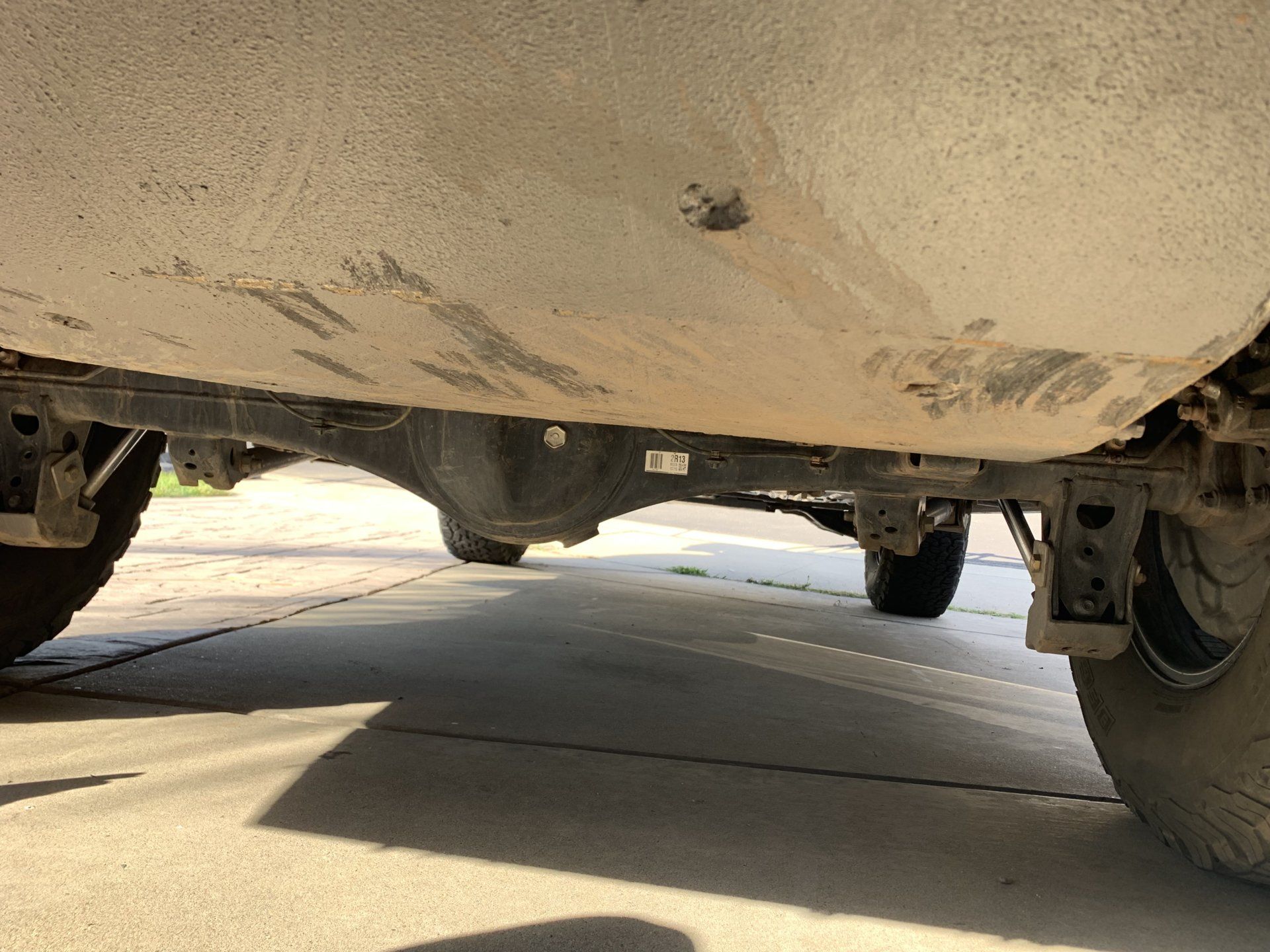

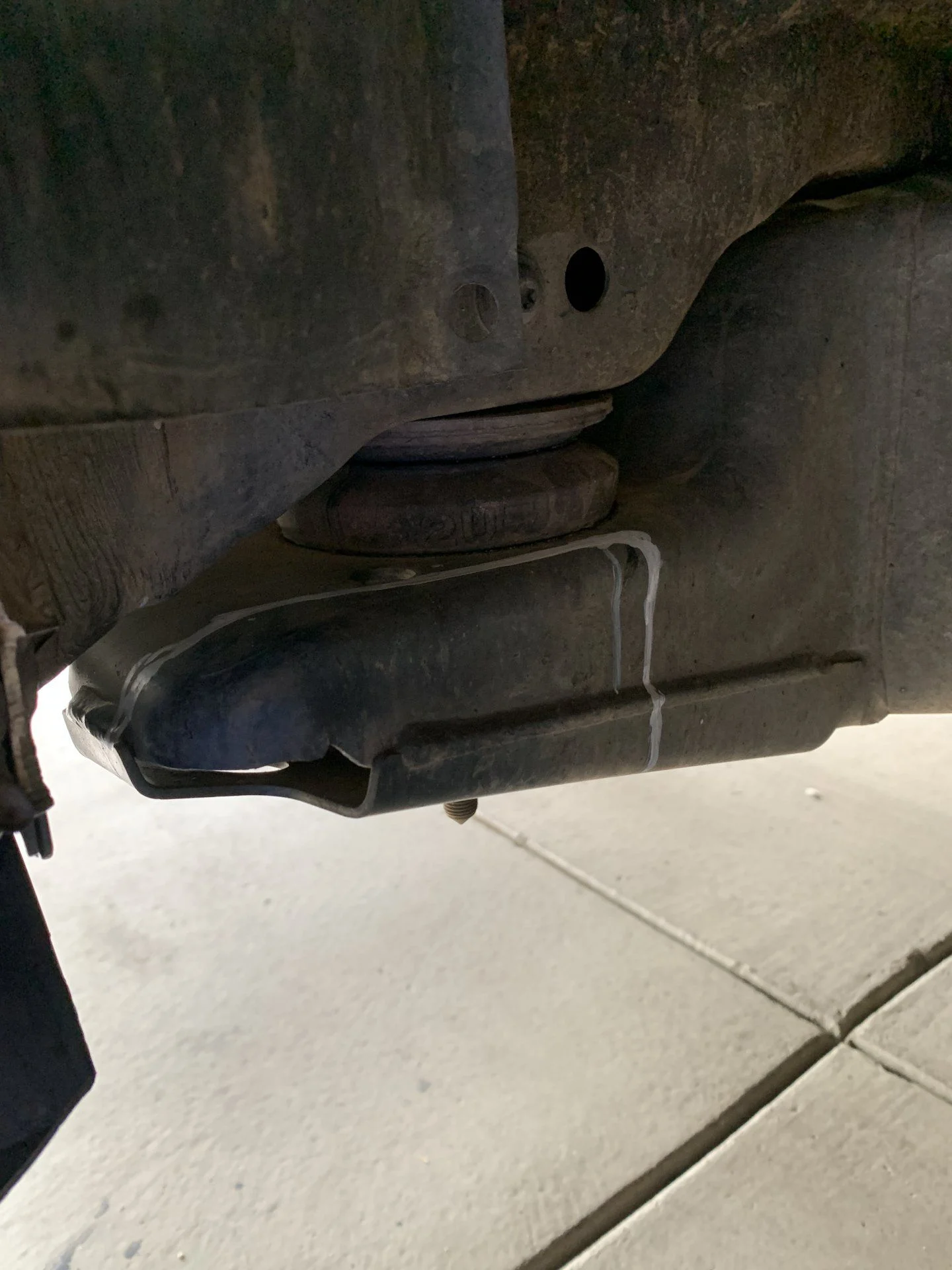

Built a transfer case skid plate.

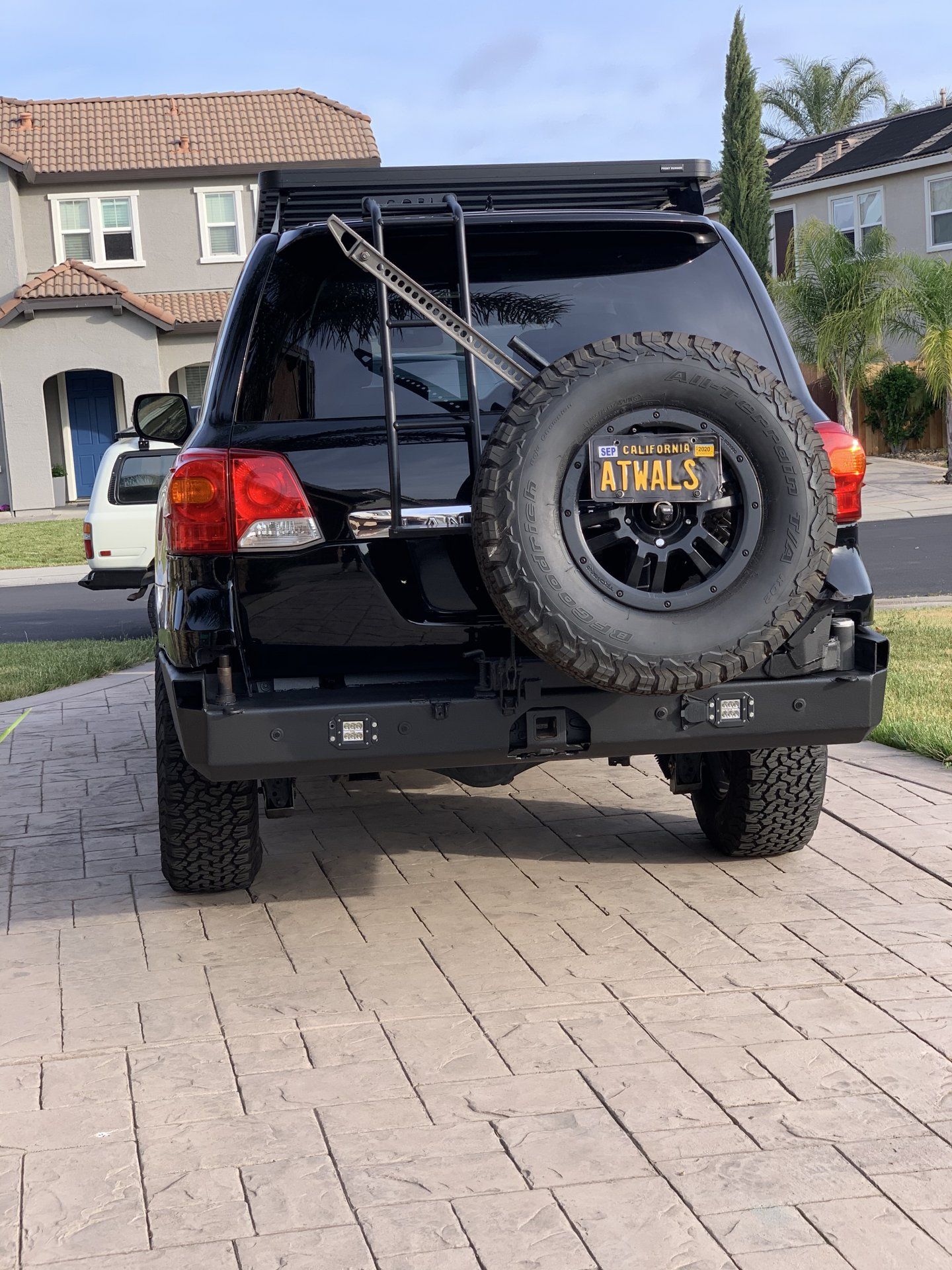

Sanded and sprayed the rear bumper with Rust-Oleum prograde bed liner.

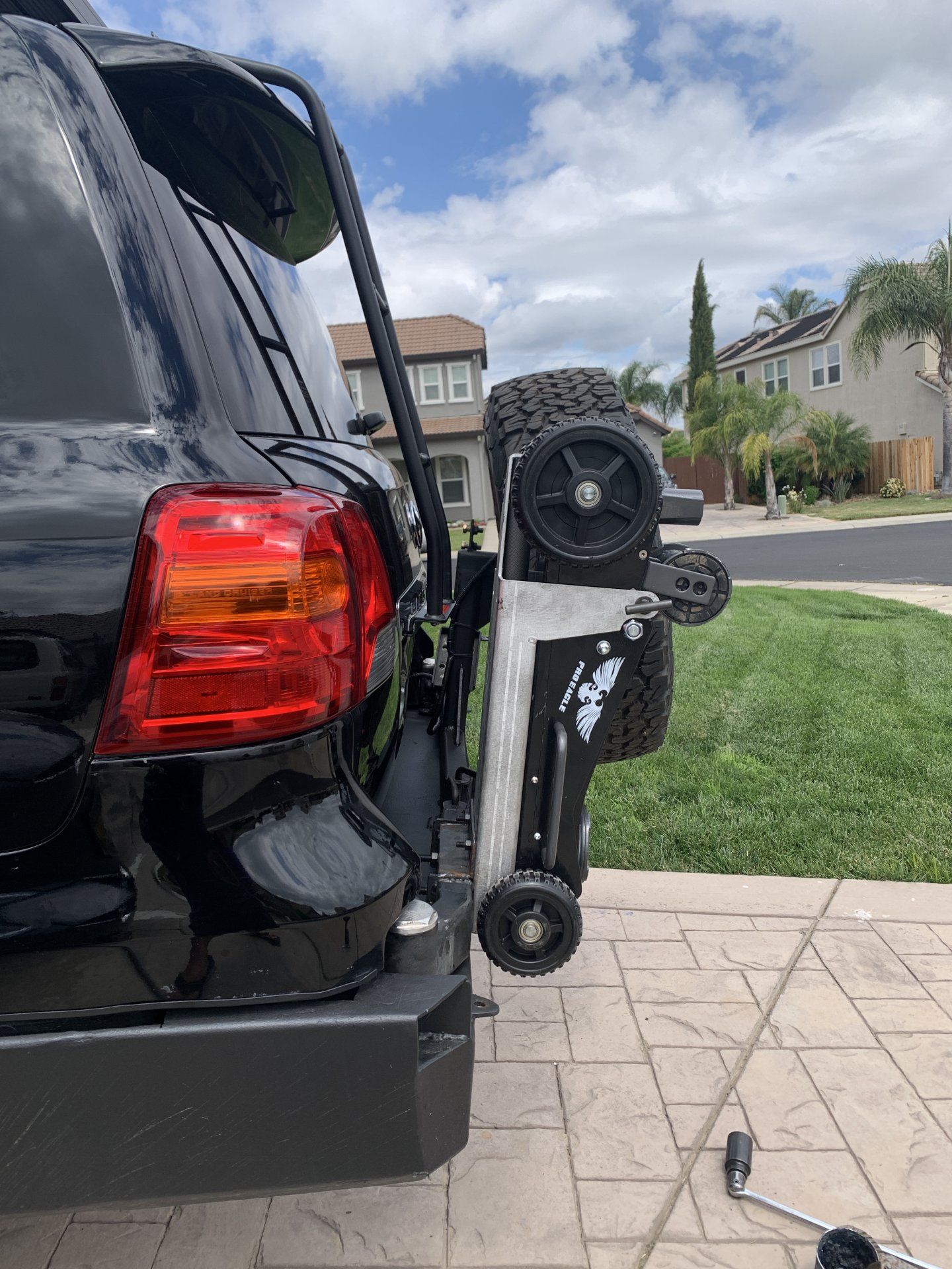

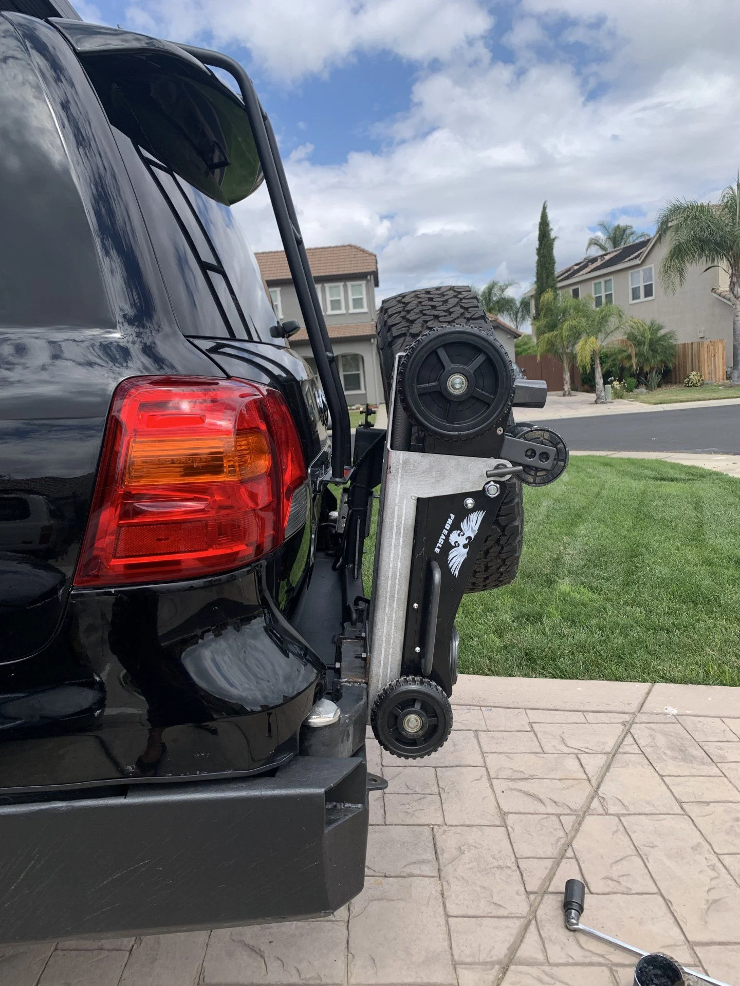

Added bracket to swing arm to mount Proeagle 3ton Jack. 🥴

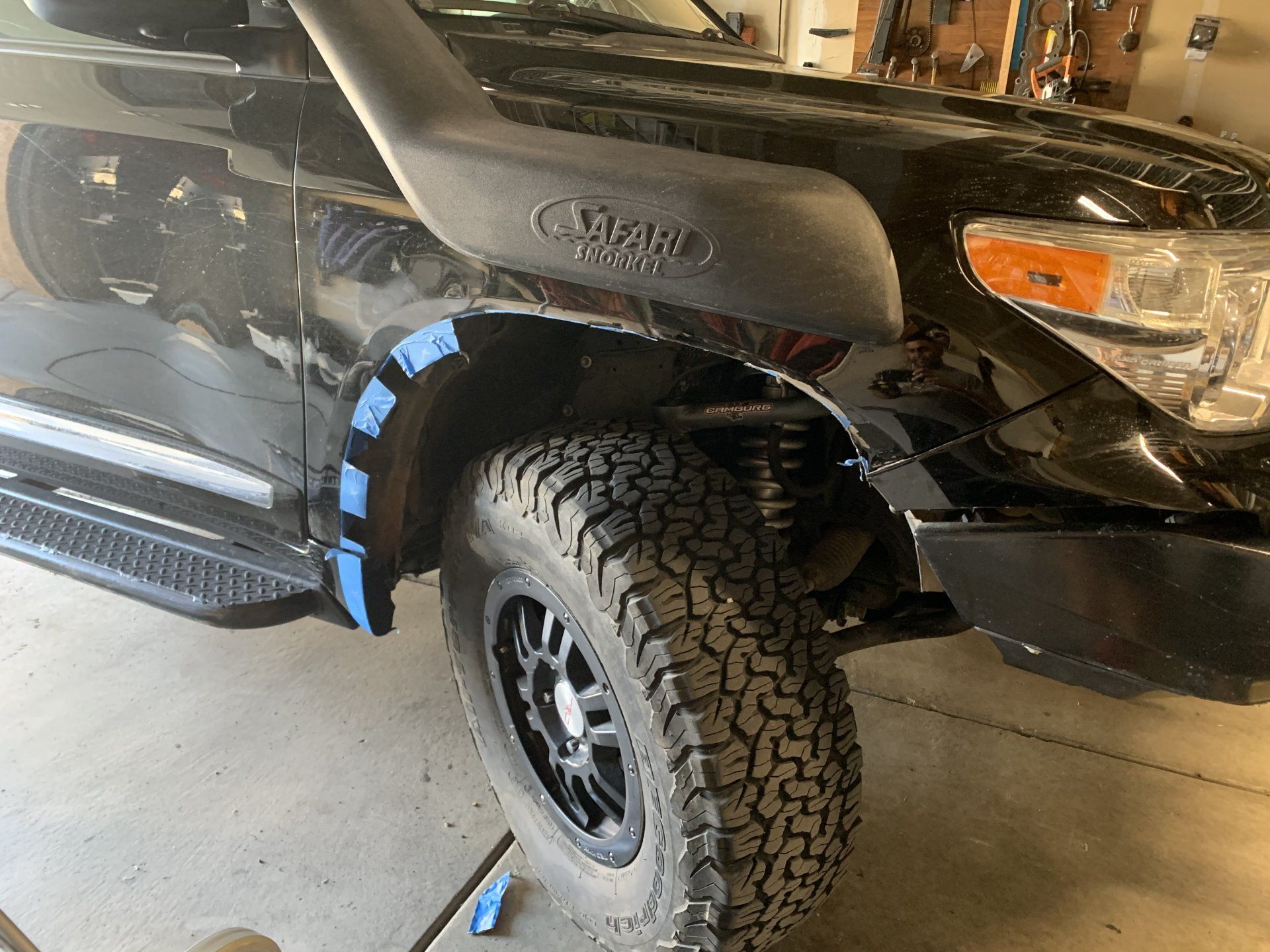

Started cutting fenders. Used m8 nutserts and re-drilled holes to hold fender liner. Plan is go 35s when my current tires need replacement. Body mount will also be chopped.
