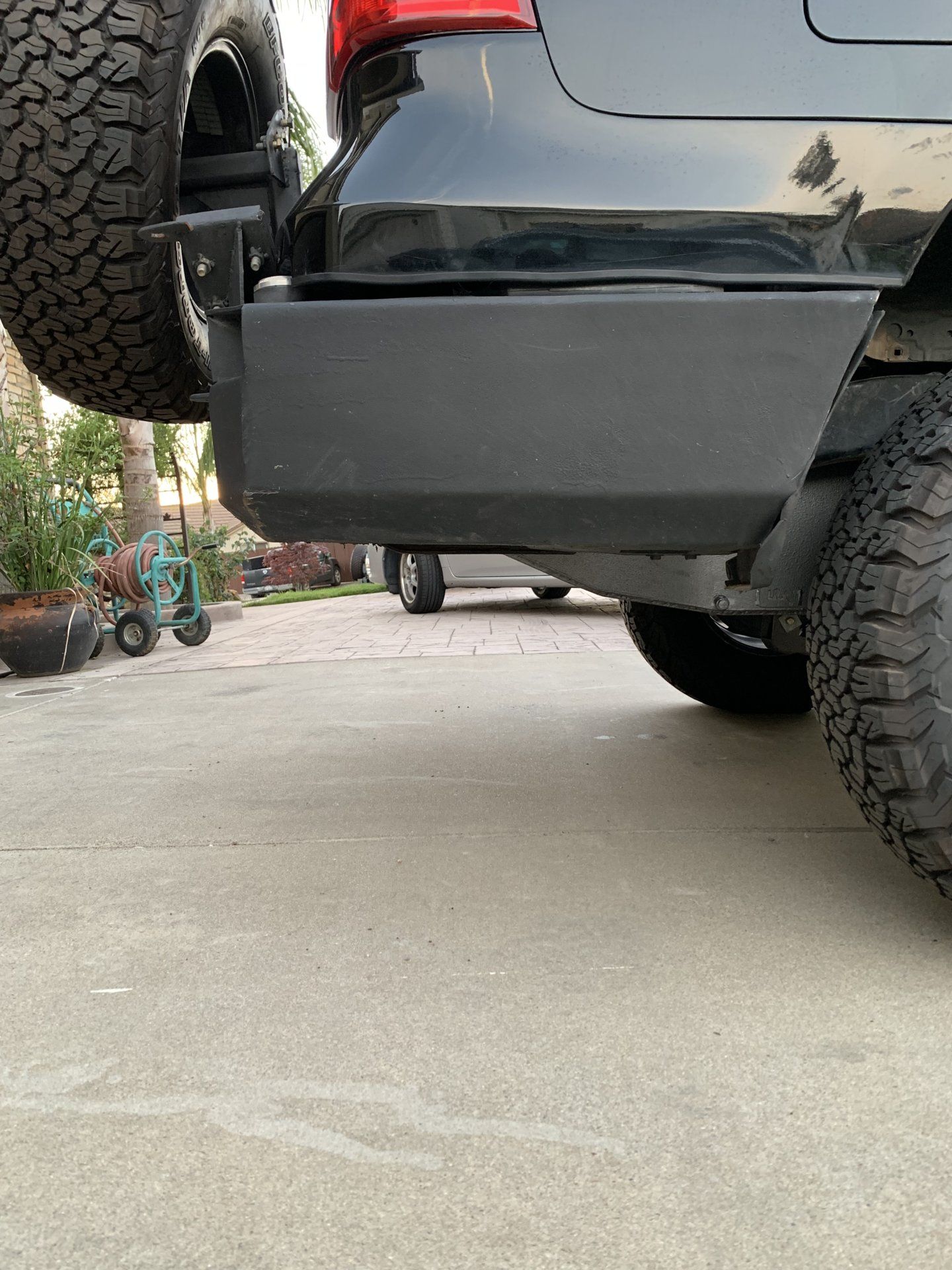

Man that is just SO nicely tucked for a 40 gallon.
I’m officially swayed. :)
-If I were to do it again...it would be an armored 40 instead of my armored 24. Love my 24...but I can’t seem to hit it no matter how much I bash rocks with everything else...so why not just do the 40?
Awesome work, Kanal!!!
Wow that's quite a bit more tucked than I expected. I really thought it would hang down more than that so I'm stoked. That is so awesome... Thanks a ton for the pictures! I'm super excited to get mine installed hopefully later this month. Definitely going to do the same and have them put some armor on it prior to paint and install.

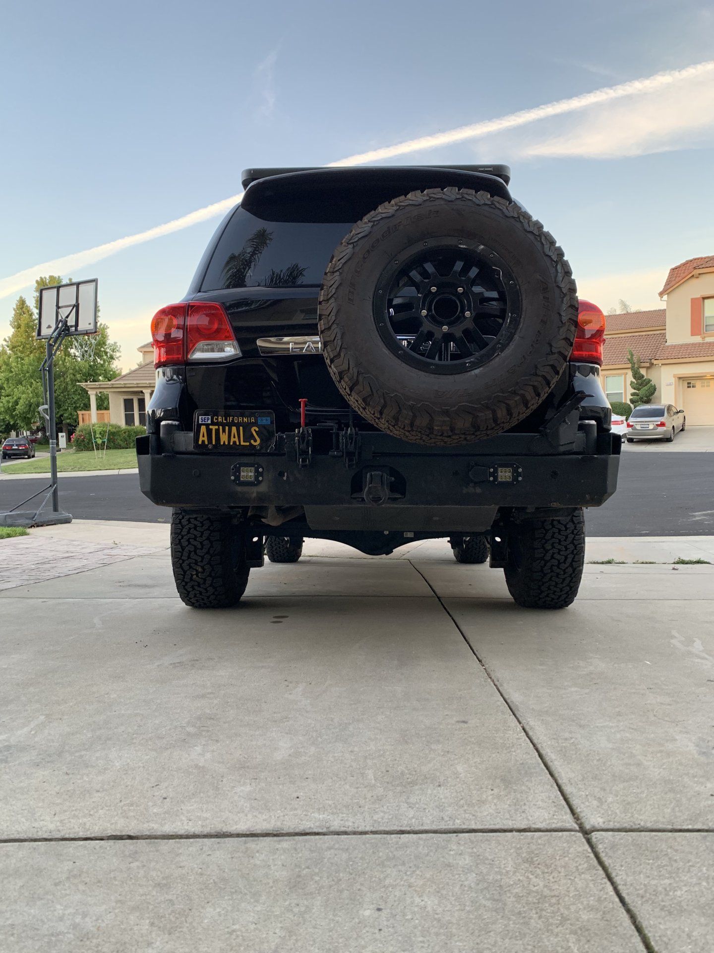

It’s looks tucked because of my bumper design. Your side profiles may be different. But it sits above axle. Skid will do its job. It does have drain. Range is now 600+ miles. I did delete OE breather and used the supplied revised version. I mounted pump near dual filler tube at an angle. Everything is tucked and zip tied. I didn’t loose much elevation. But truck feels heavy with all weight in back. Looking forward to making fewer stops to gas stations.
Right I wasn't thinking about your custom rear bumper. I've got a stock rear for now but will need a bumper to carry the spare eventually so I guess I'll that the side profile into account when I buy one.
Thanks

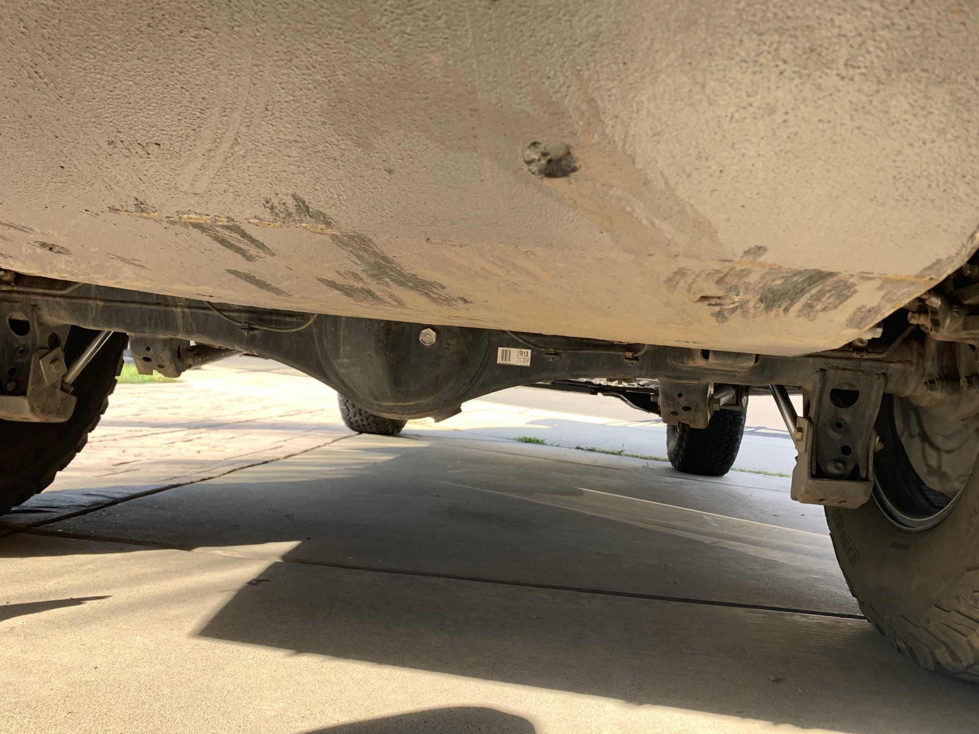

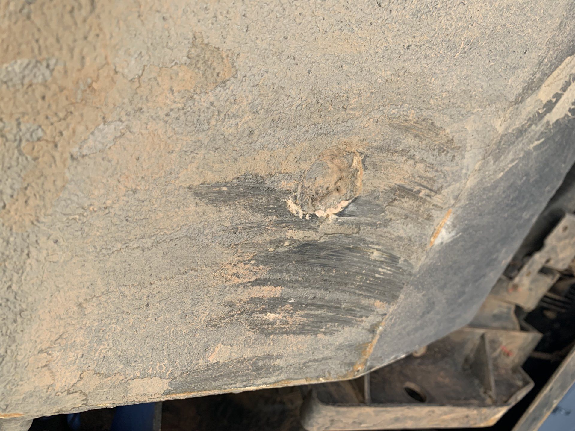

That looks pretty much identical to mine. While I have drug it across a few ledges in Moab, it has held up well and having 60 total gallons on board is fantastic! That's a Slee rear bumper on my 2016 BTW.
Qg_n_pKVa9TKrcs26PN3SG1itqzPkVY9l8-2vk0y7WInvND9bZRGZRQ7fOsMXvfVUhmmsq6V3Ml_Cv59h9tF9a_nQ17dS_qb5d87mgnxC5O5foxzbOJN6rxfIARIGJZi1SgyVBLgbQJ_OkgvYZy3GFf2G1v2HONq-kFZxE82_m2C_qAFn1GUjTWWghphS_viLAWz9ufjJ5fvLH26fVHJg5xQaYw-QfxjaymhI7L1zVtZidwJJ4BSaeHhiYynyRBMN7wUnvKa9FI_txU1gpqowY0b9JTUVC7zhc5m2MkT_CItbSAlPAbjl-bDuL0SI5QhGzmsHzJFr4OQDQGIsKfWDj6j-Qm9tdRaMKLytl8TrvU47fIgWNSXPmgkMLeSy46elGKFa7bXz6zjLL-vvdFwt7zJluxA9imHaGYEgu5we6n6u6IUNY3gwZ0xcrkacIElgP_-eFmcmcr2J3NtS78wLxMOf6wLEJEXSWDKYxr_BTWeHTdDN9Rsp_pxu_sPTfNKOKA_dfAnvt_vw1Ku4VCtt2V4yoywUEUV-t0PaUcFHt76Tn0w-gmcwBY_ALWS7CRBbXxlaTDmtJAmnPegn_I_m79RZtdzDRtcawJYeVJc-NQNWv_lUhTPvJ_qoD6W4vHM-pAZ9k8RHTh1_j0WrmpxWIX1p738FLQ=w1452-h1089-no
Yeah that still doesn't look too bad. Did u have yours armored up before installation?
No, this is the standard LRA 40 gallon tank installed by Slee. My rig is quite heavy, I really can't imagine adding more weight in armor. :-) I'm sure I am at 8500#s loaded and ready to hit the trail.

@Atwalz bumper effectively hangs lower at the rear-most bumper edge than our Slee (which isn’t exactly super tucked either) but I still think the 40 is tucked enough if armored. I like it. I don’t usually need 60 gallons...but when you need it, you need it. Next Time I do Baja, it probably won’t be point-to-point...so extra fuel for exploring options is nice. Even with my 24, I’d tote a couple jerry cans in that setting...so ya, I like your 40’s.
