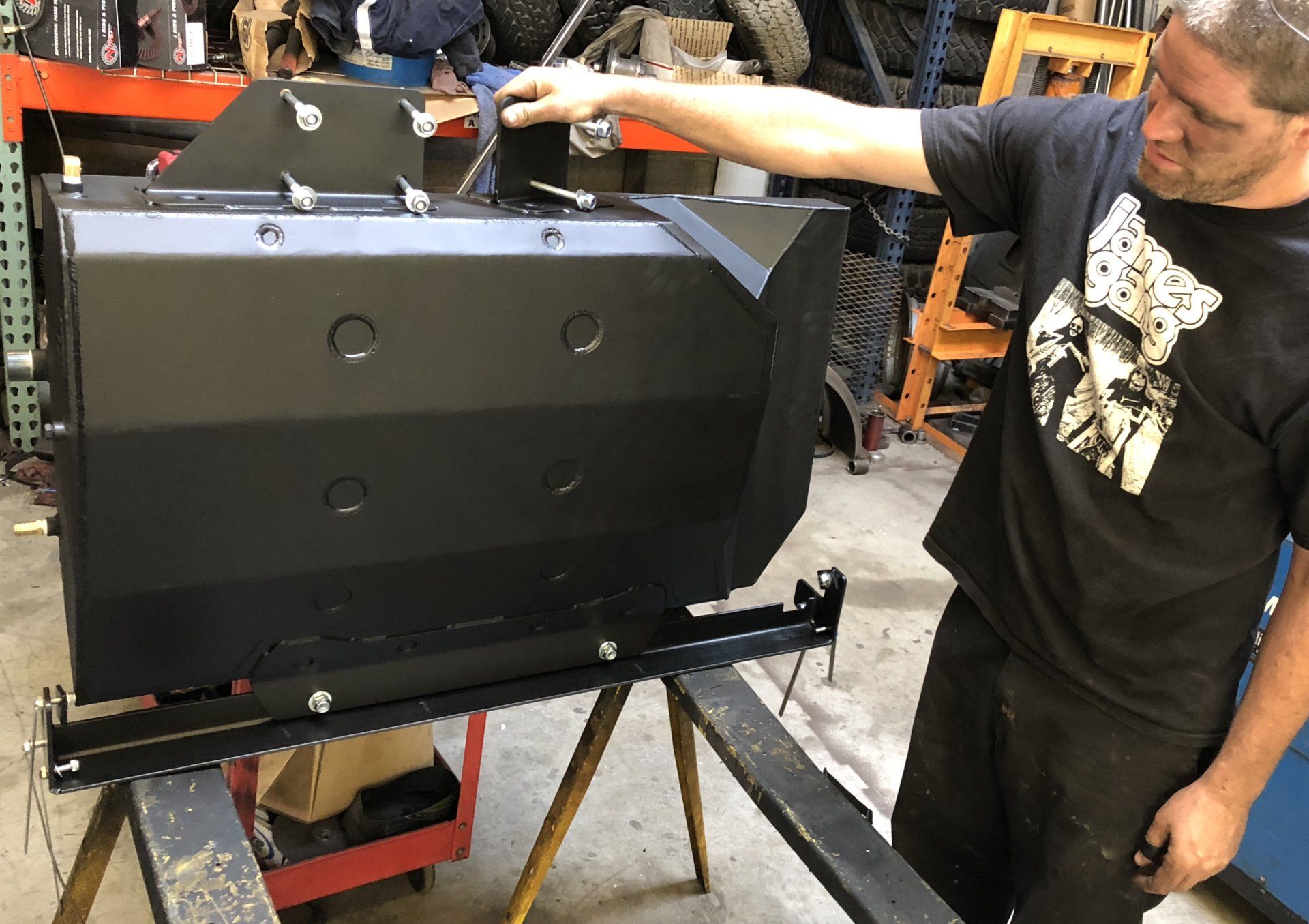

Here is a photo of the bottom of mine after VH welded steel and painted. You can see the circle cutouts which allowed welding throughout the surface rather than just the edges:

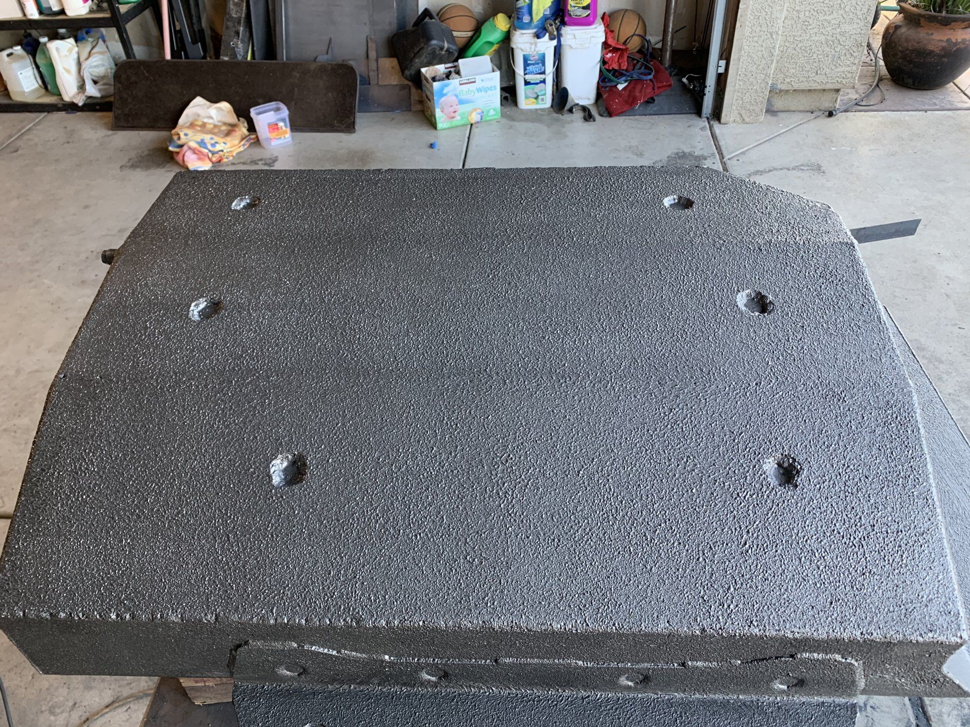

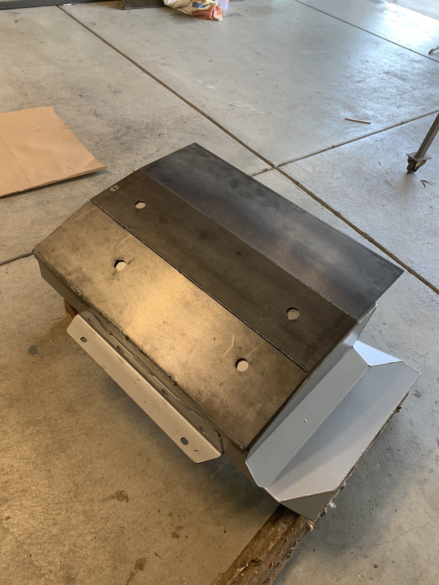

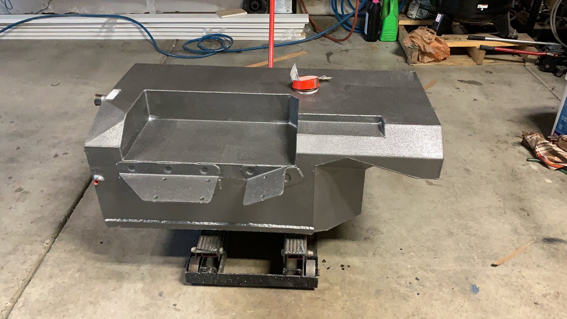

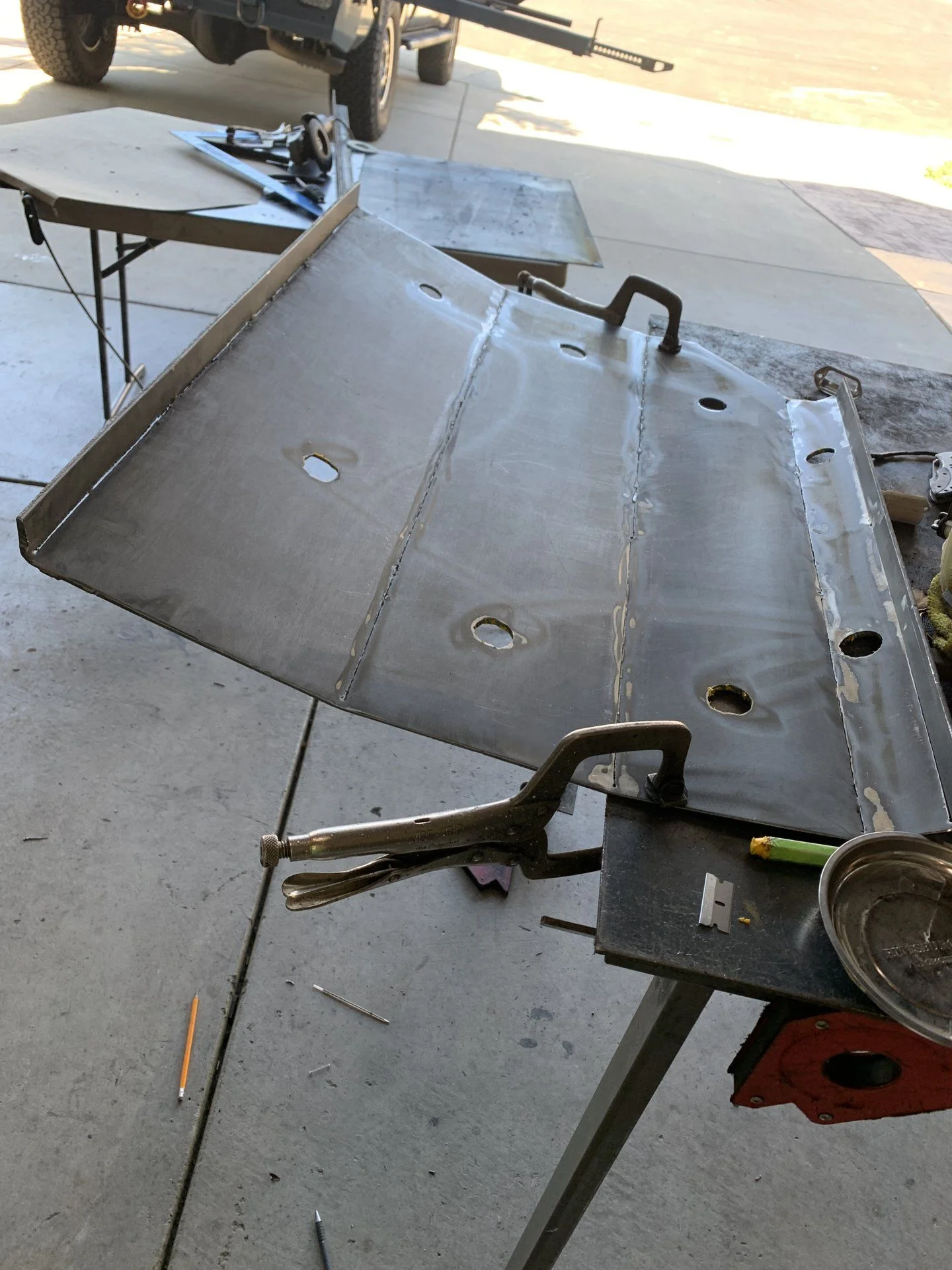

Picked up tank, fabbed skid plate, welded and painted.
Very nice. I decided to go with the 12.5 for right now. Down the road I might switch to the Kaymar and 24 or 40 gal tank.

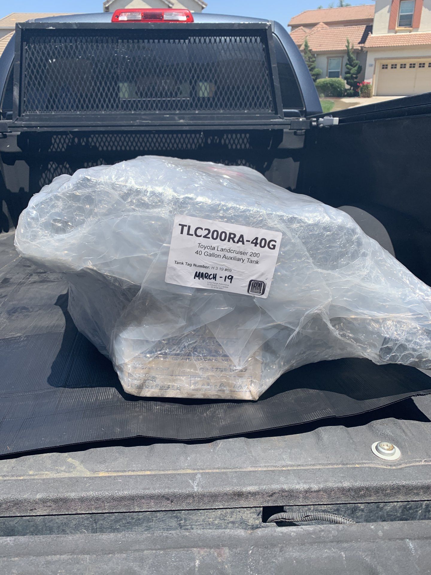

I think my 40gal tank is somewhere between here and Australia right now but should be in the states within the next 2 weeks. Interested to see how the install goes and to maybe see some pics of how it sits up in there once it's all buttoned up.
