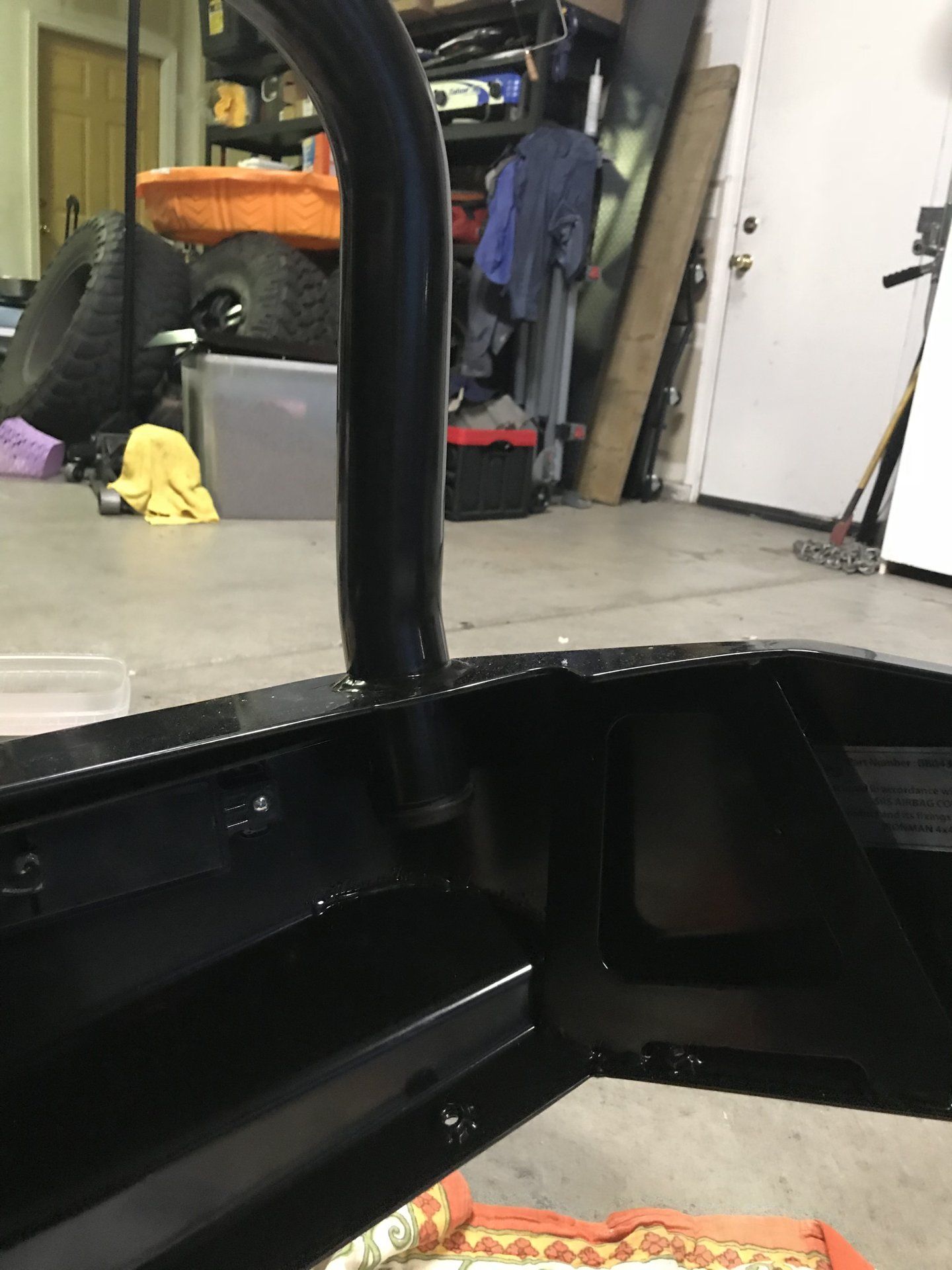

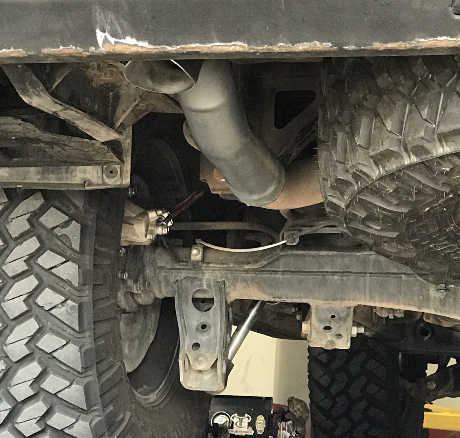

I am waiting at shop as they are welding it. I will update on noise change. Others here have done it and noticed no change.
Here is finished pipe.
My ears detected no audible difference.
Nice going. You just dropped 15-20lbs.
From five mile drive, I cannot tell difference even with mud tires humming. Good to lose some weight.

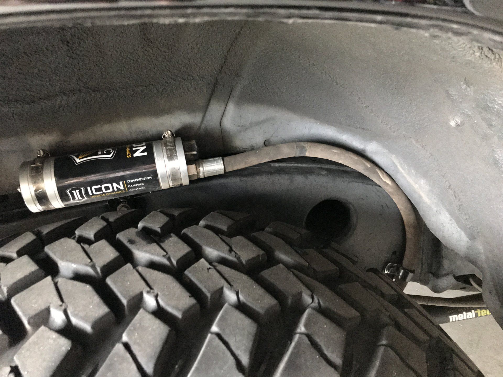

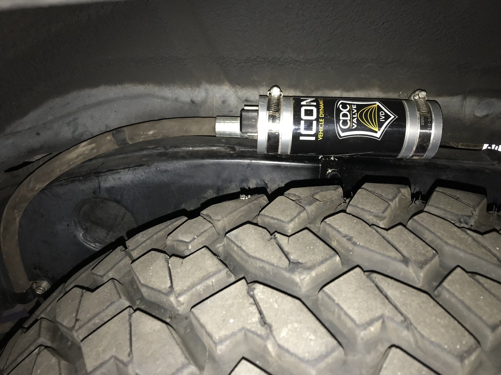

Relocated rear resi in rear wheel well. I used Home made brackets. I have wheel spacers in the back and they should clear in full stuff. It’s same location that King’s resi are mounted. @dc916cruiser runs em in same location and has no issues. Now hose is tucked away and not hanging low.
Looks good Kamal! And we confirmed no rubbage yesterday on the trail :)
Most definitely, we need to hit up some more trails soon!

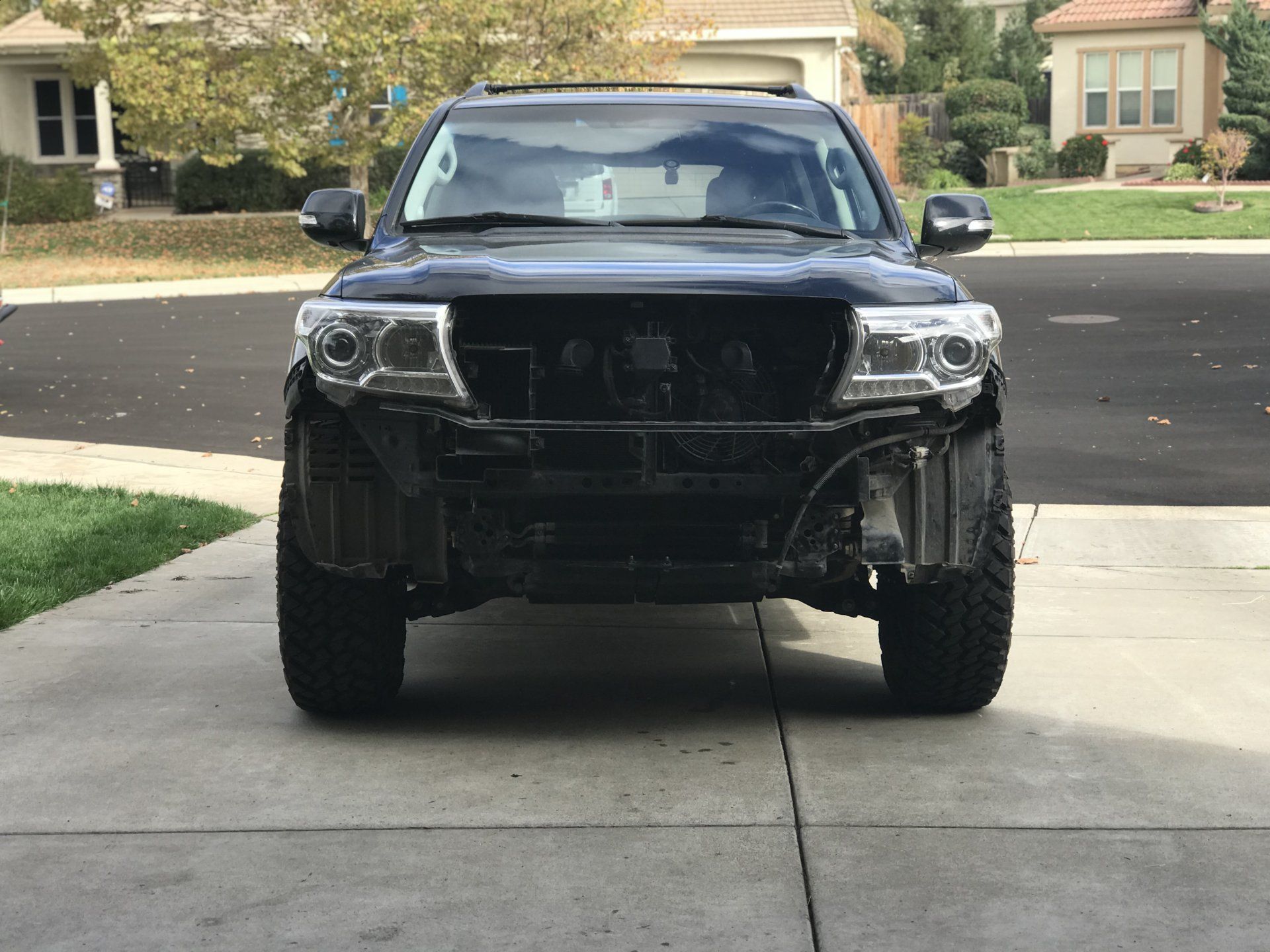

I'm digging the mad max look for now!
Caption contest? "I'm headed to Baja, ready to blend in....."

did the new steel arrive that quickly? seems like you just ordered it last week.
It’s shipped and will be receiving it by next weekend. I had spare time today to dissemble front end.

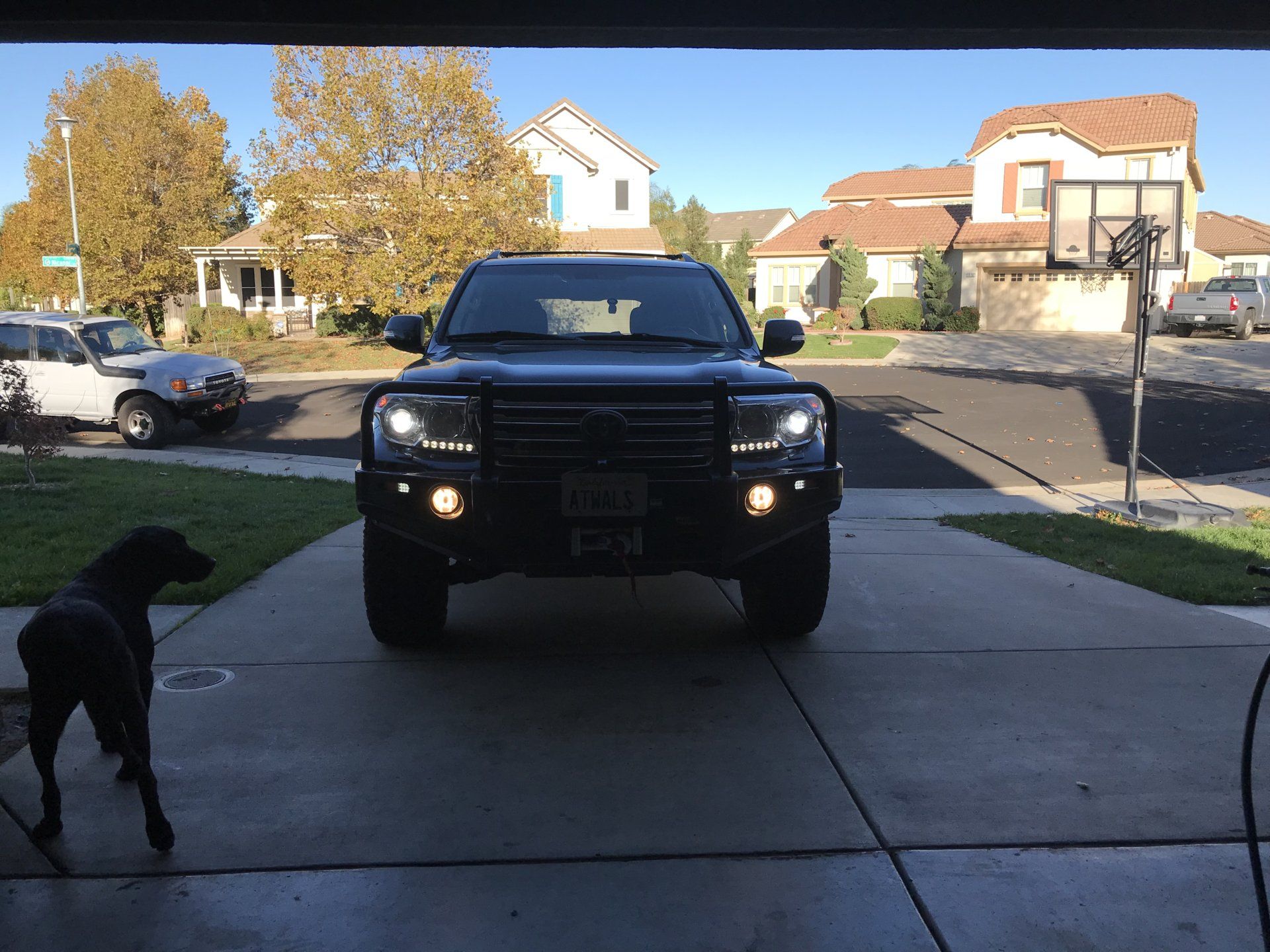

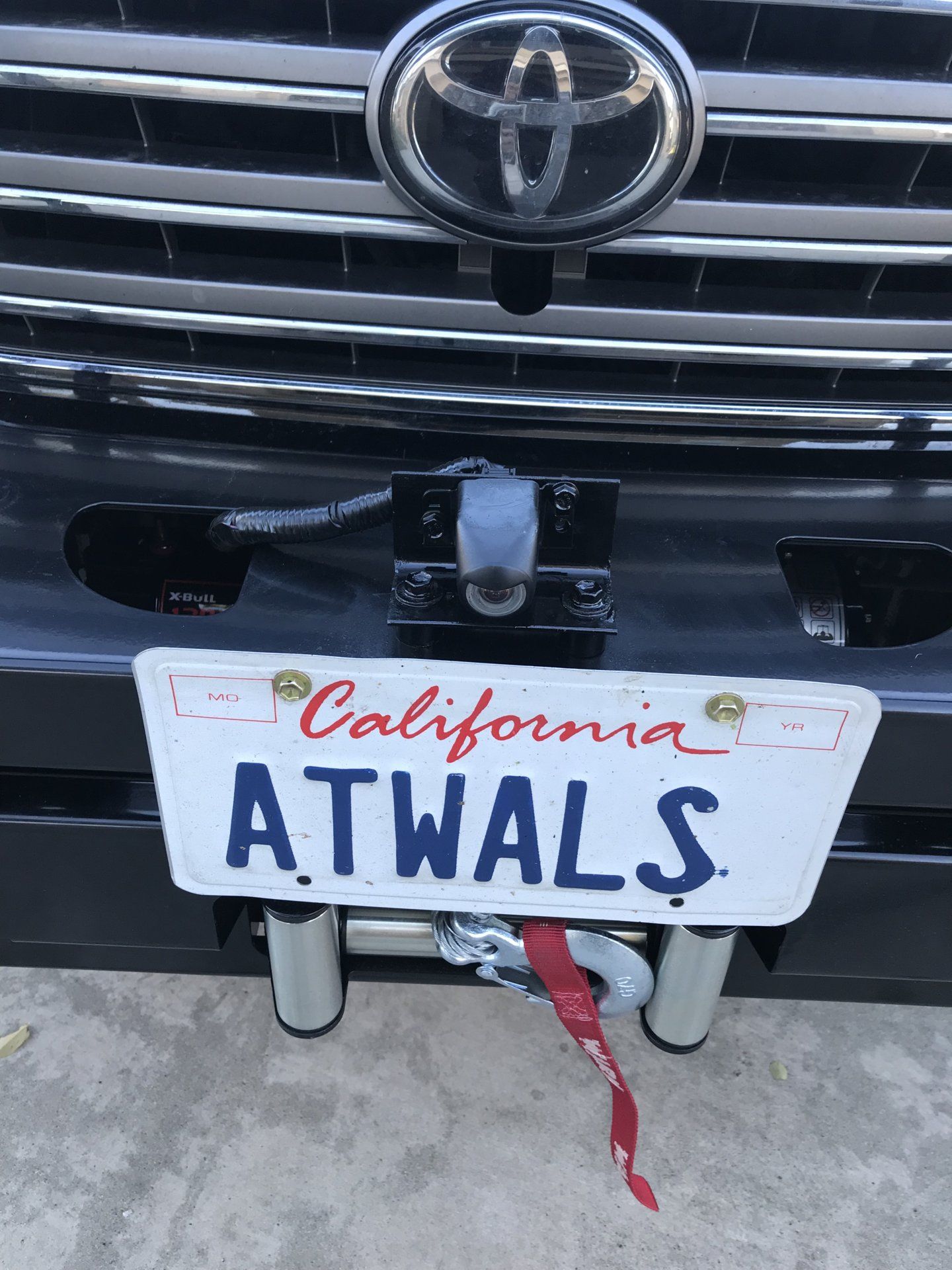

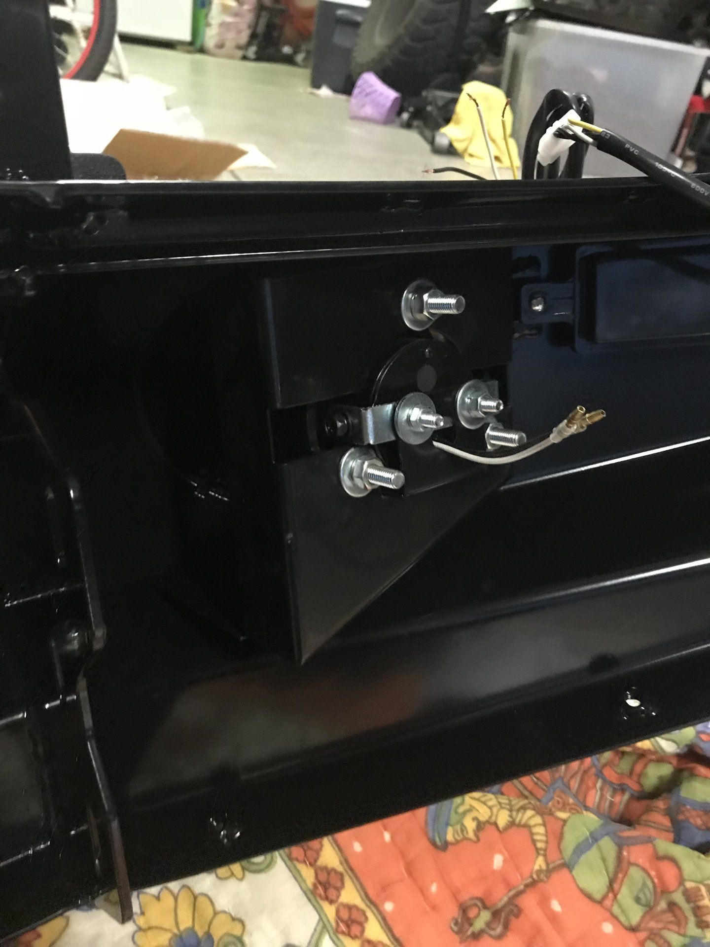

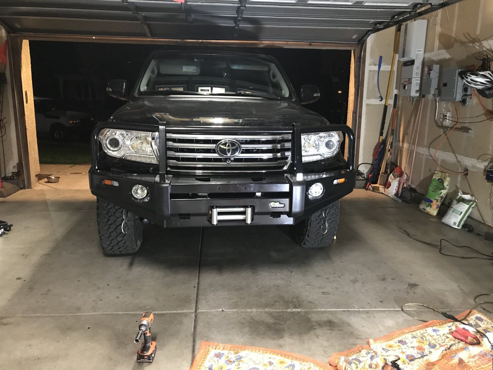

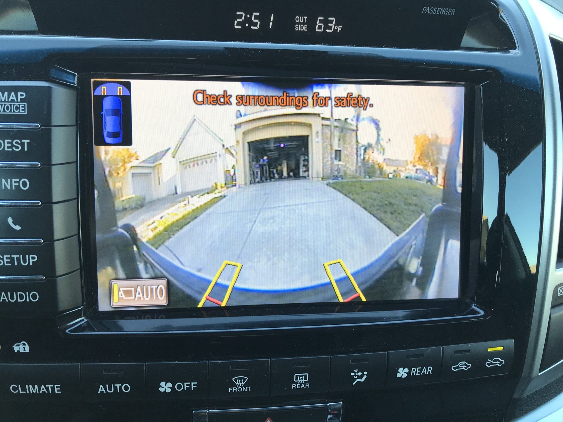

Relocated front camera and hooked up fog, parking and signal lights. Now pending control box. I am going to mount it behind bumper on passenger side of winch. I will make a bracket and modify the center skid plate as well.

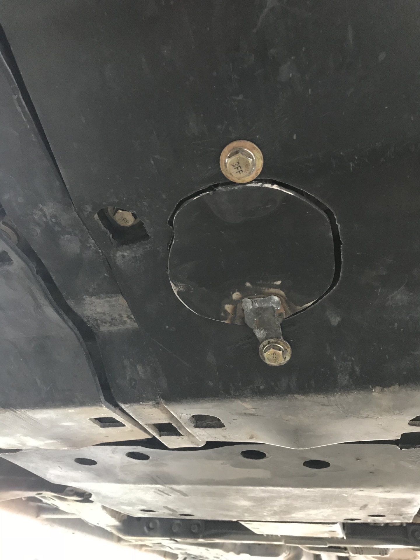

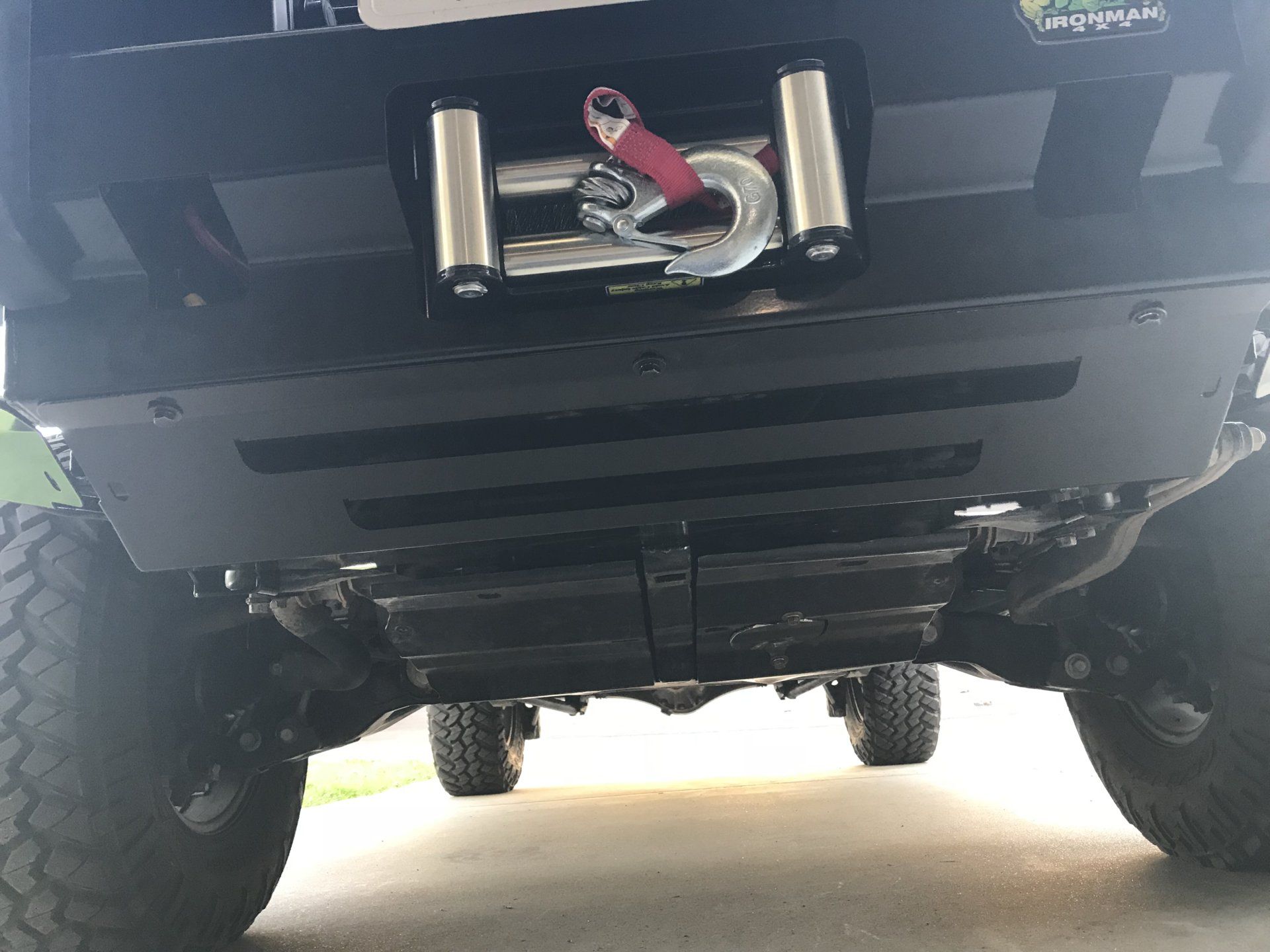

Modified home made skid plates to integrate with Ironman bumper. Also, added access cut out for oil filter. Control box mounted behind bumper and control cable can be easily plugged when needed thru an existing cutout in the bumper.
Just need to extend one wire and rest is all buttoned up.

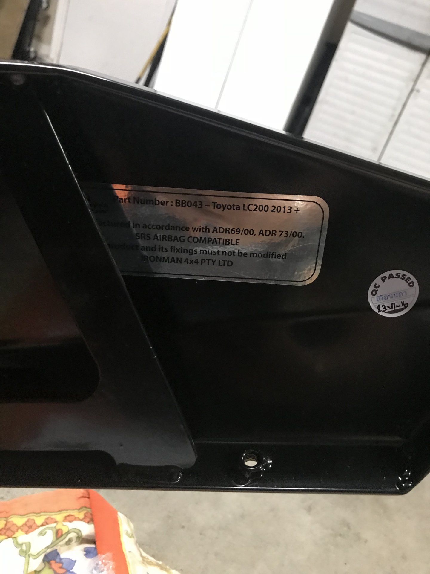

@Atwalz, how deep is the bumper? Can you hit the center with a tape measure when you have a chance?
