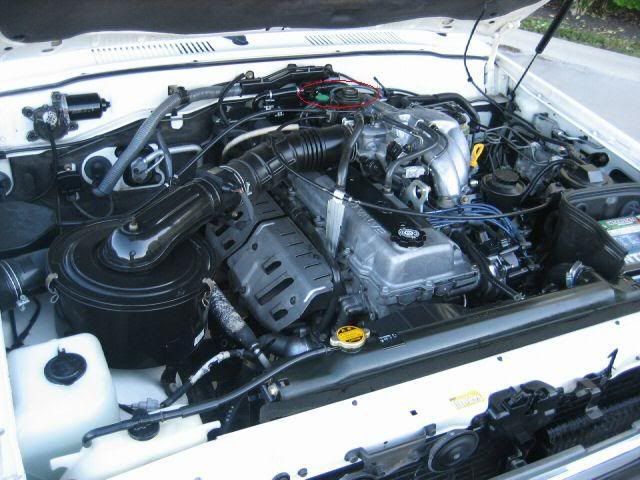

If it has the EGR system it should have a coulpe items like these:
On the right (as standing looking in the engine bay or USDS) is the EGR valve and on the left or USPS is the egr valve modulator.
:cheers:
Dave
