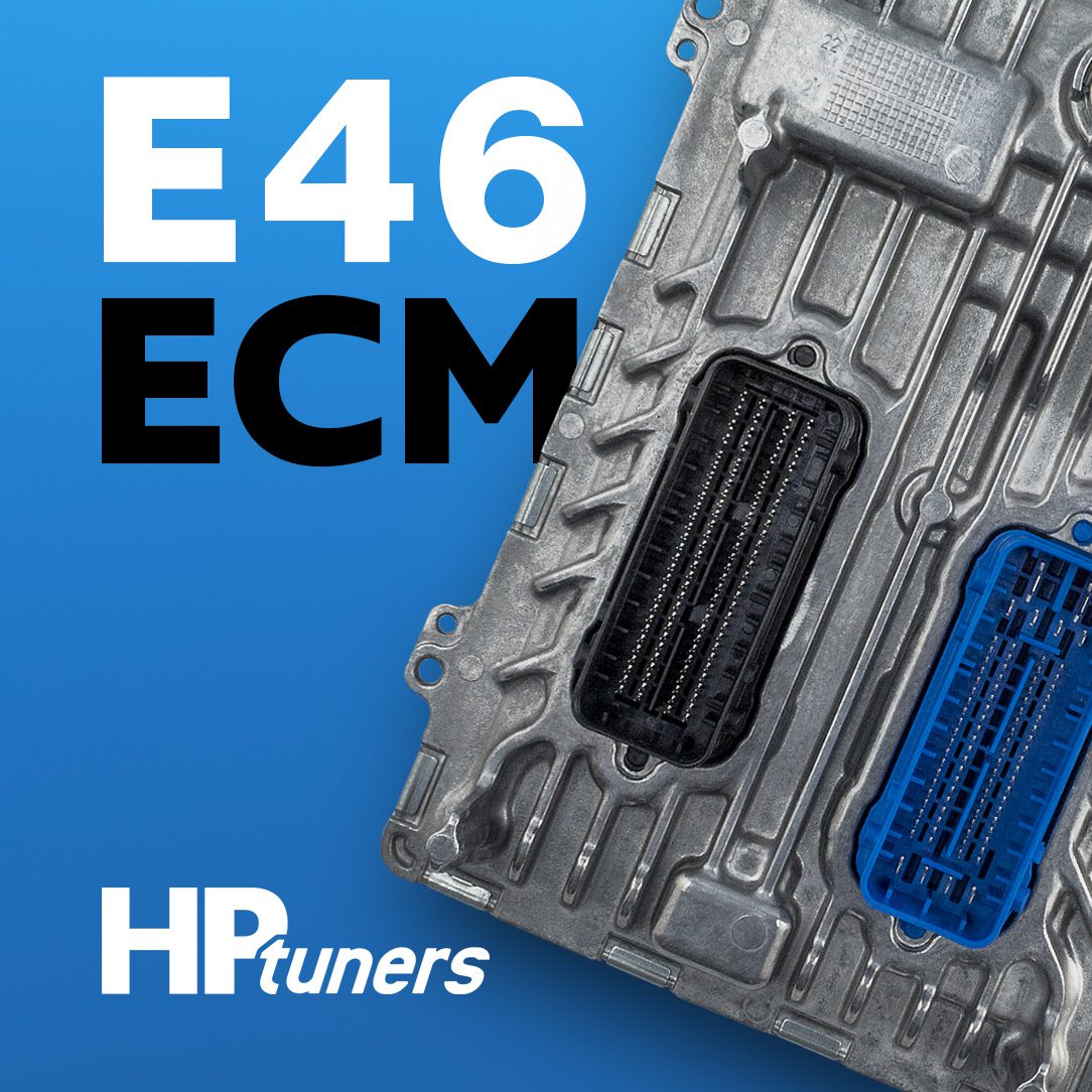

@Drewthecarguy Where did you source your engine from? What type of vehicle was it out of? If I am interpreting HPtuners website correctly, not all LM2s of the same model year are compatible depending on what type of vehicle they came out of. Do you have any insights on this?
Mine is from a 2021 silverado. Yea you have to be careful when you get newer than that your looking at a global B computer which as of right now can’t be made stand alone because of the transmission. But other than that what model it came from shouldn’t matter. Tahoe, suburban, pickup should be the same.
You have to look at the transmission. When GM went to a turn knob gear selector, those won’t work
The HP tuners website for LM2 w/e46 ECM says they don't support Chevy Suburban LM2s - only the pickups. Not sure what the difference would be. I'm interested in this swap but trying to figure out the best place to source an engine from.
Did you buy a full truck and pull the engine or buy a complete takeout?
I got a complete take out. I’m guessing the suburban has a turn knob transmission
Hmm that actually makes a lot of sense. I've been in a '21 gas suburban and it has buttons, not mechanical linkage for the transmission. I can't imagine they would have an entirely different shifter setup for the diesel version.
