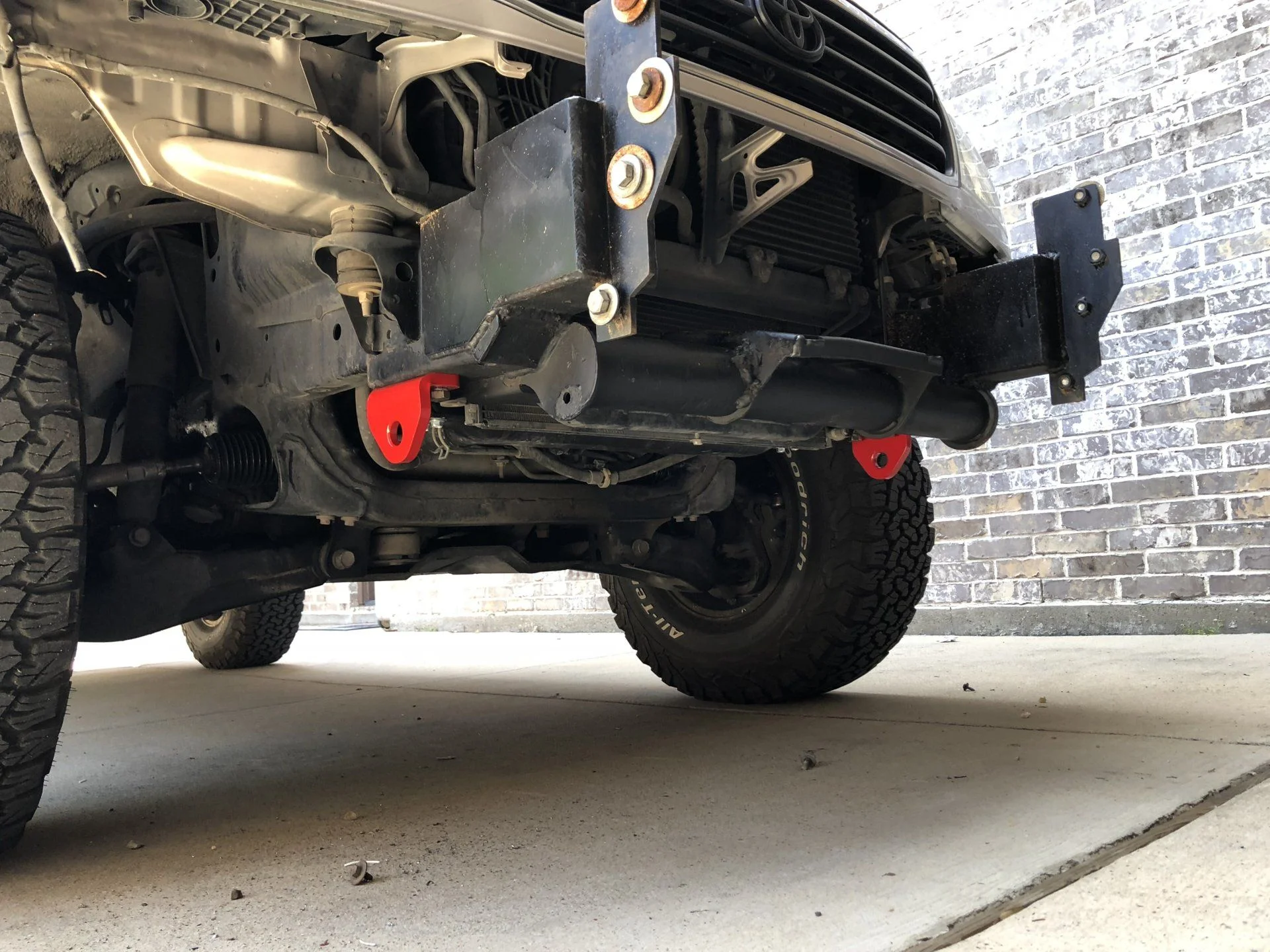

I went to do a test fit and accidentally stripped one of the nuts that's welded inside the frame. It is where the factory tow points thread into the frame. Without it I couldn't get the bumper to mount up without a ton of play, so looks like I will have my stocker on for a bit until I get that sorted and finish the bumper completely.

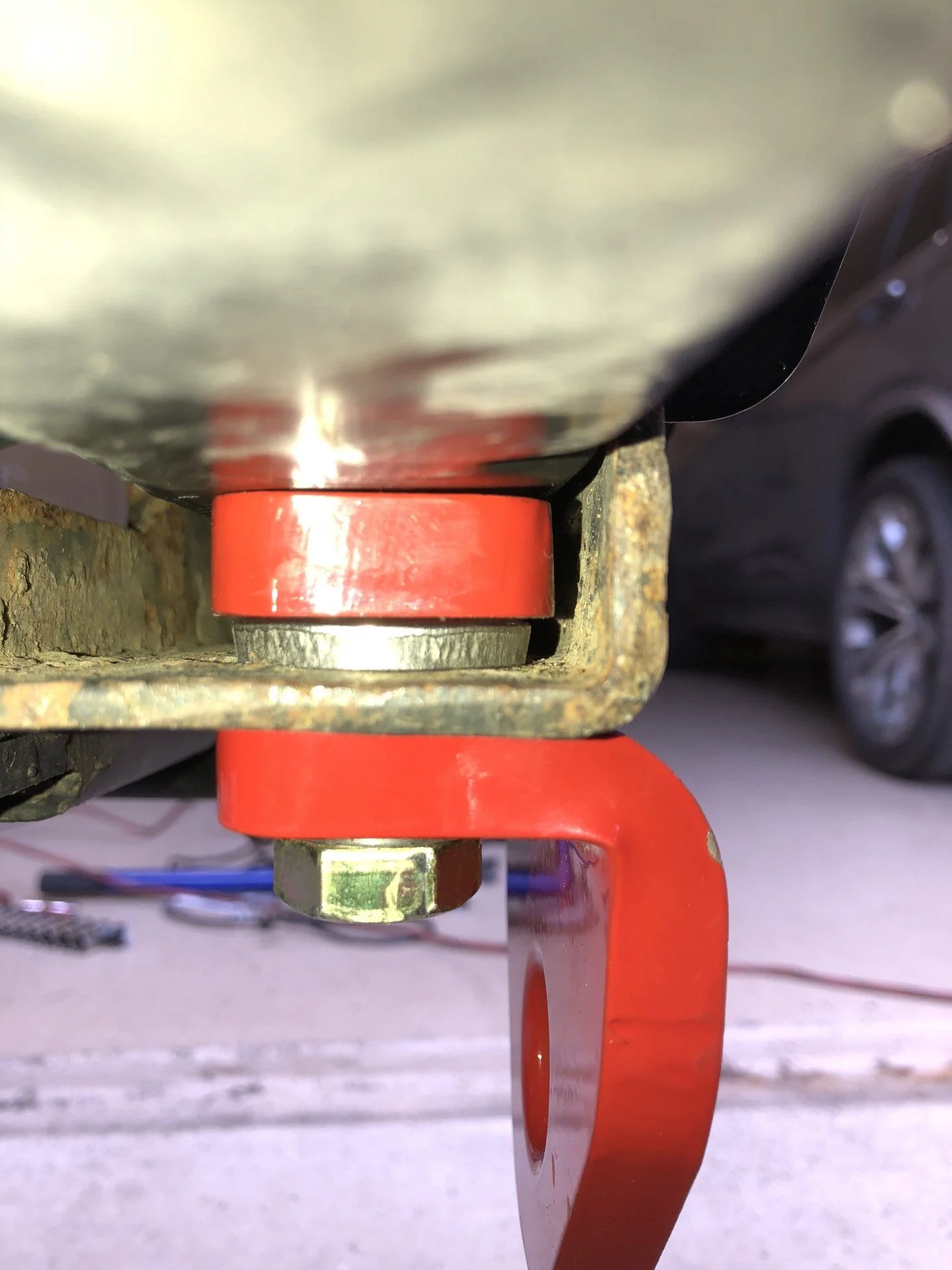

To fix the stripped nut I got a helicoil kit so I can drill it out and rethread it to an M14 so all of the bolts match. I ordered 4 new M14 bolts, flat washers, and lock washers for the bumper mounts. And since it will all be apart, I went ahead and ordered some recovery points from Trail Tailor, so my front bumper and recovery points should be good to go!

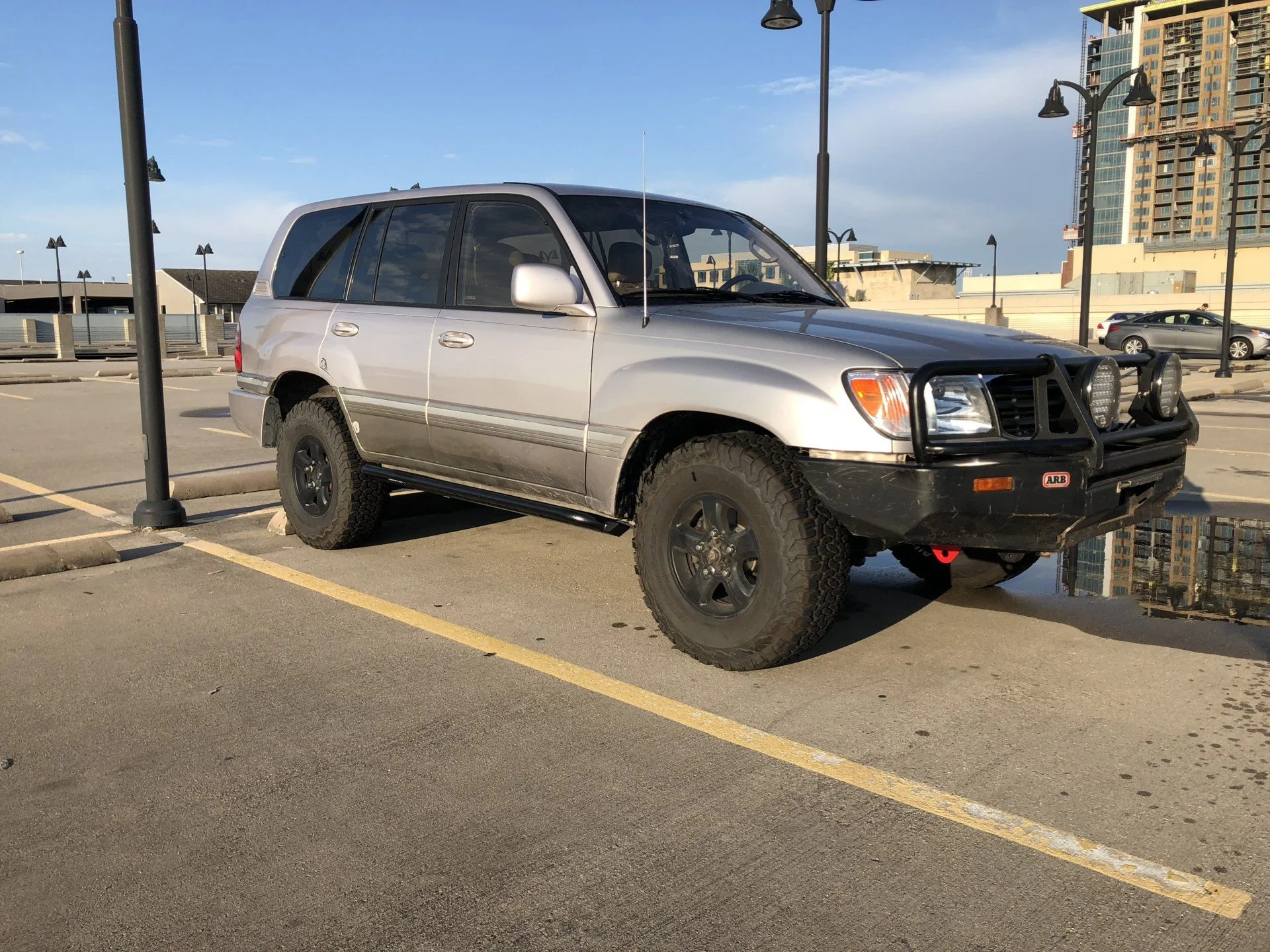

So I made my first trip to the deer lease since I got the cruiser. It did great, though nothing too technical, it did fine. I’m excited to get into some more technical terrain and see what this thing can do! My front end was really sloppy, so I think I need to get my tie rods installed, yet another part just sitting in the box.

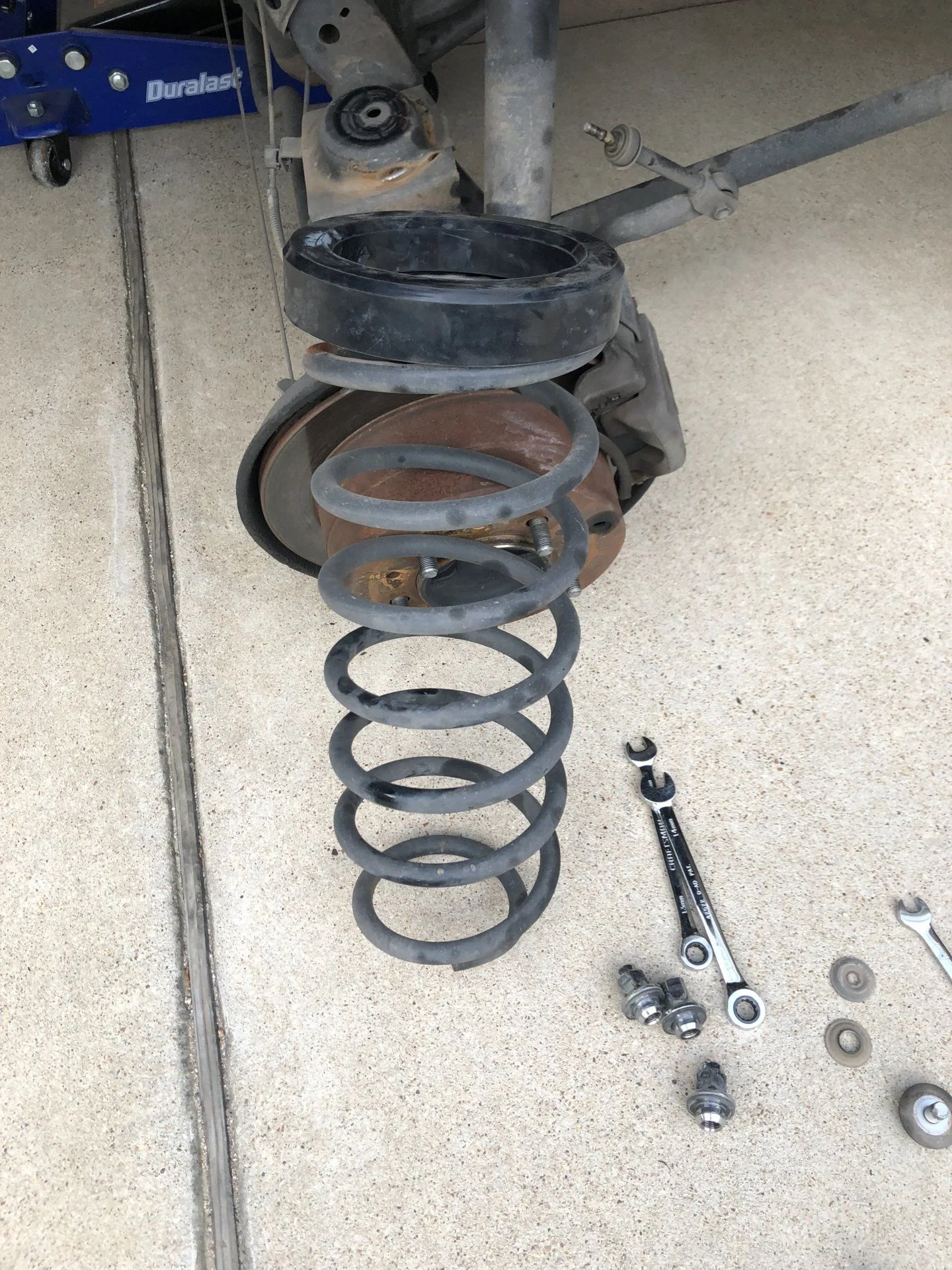

Before I left I installed my 1” rear coil spacers and I’m very glad I did, once we loaded up out hunting gear, loaded 65 qt cooler, and two guys, the rear end definitely started to sag. Install took 45 mins. Just know you’ll need to loosen the breather and brake lines where they bolt into the frame crossmember. Just some 12mm bolts and the retainers come right out. Then pull your rear shock lowers off their mounts and undo both sides of your sway bar. CHOCK YOU FROMT WHEELS REALLY WELL! You have to stick the rear end way up to do this and the car will want to roll forward as you set it on the jack stands and such. Overall just not a hard job.
The height difference is way more noticeable than I expected. Almost wish I went to 295s...

Well I got a few more parts in the box. I got my helicoil kit and drill bit to fix that nut. I got all new hardware in...all M14 Grade 10.9 with washers and lock washers, and finally I also got my trail tailor Tow/Recovery points in. These things are probably 2x as thick as the stock points, and between these and my new hardware I have no concerns about my front recovery setup!

I did, however finally get a chance to work on my bumper again. As a refresher, I had to go back to stock the past few weeks because on of the nuts inside the frame rail was damaged and I had to do some thread repair. I ended up buying an m14x1.5 Helicoil kit and it turned out great. It seems like smaller helicoils are easier to work with but this got the job done nonetheless.
The other issue I had to compete with was I did not have the "packers" that sit between the frame and the winch bracket for the ARB. The newer style ARB's sit flush on the bottom of the frame rail. However, mine is the older style which requires this packer. In perusing @reevesci website, it occurred to me that his "tow hook spacer" would fulfill the same role. They turned out to be just a tad too thin (I think they are 1/2" and I think I needed about 3/4". However, I had some big fat washers, literally almost 1/4" thick, laying around that filled the rest of the void beautifully. with all this, all I had to do was run the bolts thru my Trail Tailor tow points, thru the winch frame, thru the washer, and thru the tow point spacer, and thread in my brand new m14x1.5x100MM bolts. I could've probably used 70-80MM bolts, but there is plenty of room in that frame rail for the excess. Overall I have zero concerns about using my tow points for recovery.
As for the bumper itself, I have gotten the main structure finished on the drivers side that had been cut off by the PO. My welds had some air pockets in them and the grinder left some scoring, as expected. My plan is to eventually clean up all the edges, smooth the welds as best as I can, and clean up all the cavities and scoring with body filler. For now I hit most of it with some rattle can semi gloss black just to prevent the surface rust and hide the imperfections. When I pull it next to finish the drivers side end, I will do a nice even rattle can job over the whole thing. I have painted steel bumpers in the past with rattle can enamel and had great luck....and obviously I'm not trying to impress anyone with this thing. Don't judge my gap on the passenger side, I got very tired of wiggling the bumper around myself and just said screw it for the day :)

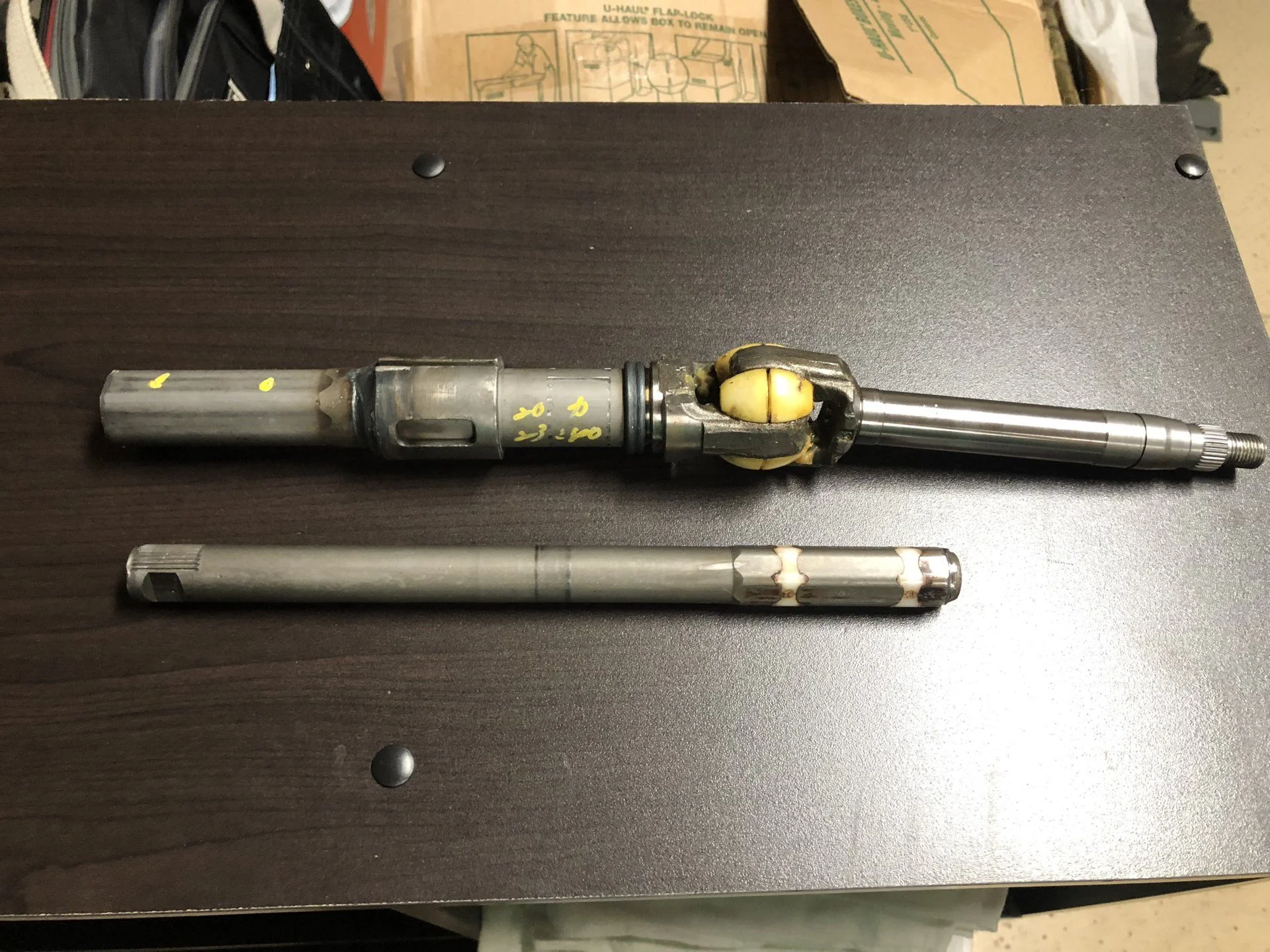

As noted, replacing my tie rod ends did tighten up my steering a bit, but I still have this terrible terrible dead spot in my steering that allows at least an inch of play in the wheel. Its not play in the rack or rack bushings or anything, it is literally a dead spot in the steering whether the car is on or off. Obviously some wheel play isn't unusual with the car off but this is exceptionally bad. When you roll the wheel left and right you can hear and feel a knock on both sides. When off-road of harder hits on-road, I can feel the knock in the wheel.
I did a ton of research on here and found that the steering columns on these 100s can actually wear out. They are collapsible so they have splines in them like a driveshaft. However, those splines are coated in some plastic that can wear off. It has also been discussed that if the car has hit a really big pothole or been in a collision it can cause this (my truck has been wrecked so this is a possibility). When the plastic wears off the metal splines have a small amount of play and will result in play in the wheel.
When I reach under the dash and hold the rag joint at the intermediate shaft I can physically rock my wheel back and forth, meaning the steering column has play. Ordered a new column that should be here by the weekend to install. I'll report back once I install it. Here is the thread that was tremendously helpful. Steering Shaft
I am replacing P/N 45210-60091 for the MANUAL TILT wheel and it is literally the entire upper steering assembly

Just finished replacing my steering shaft. It’s like a brand new truck! But wow that was a miserable job. Even after I finished I had some issues with my immobilizer and my steering wheel was rubbing the column trim. Luckily I got it all done and all that awful slop is GONE! When I took the old shaft out it literally came apart in two pieces as other have reported. Interestingly enough this manual tilt shaft is pretty drastically different from the electric tilt shafts, but overall not dealing with the motors is a lot easier.
I got the steering wheel as close to straight as possible with the splines. It’s a little off, but I will deal with it for now. One spline over and it’s way way off, so this will work.
